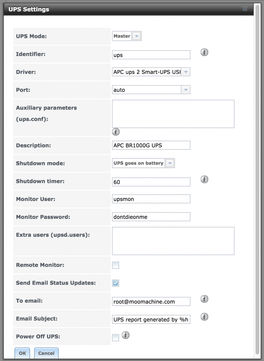

I know it says check driver but I'm using an APC BR1000G which others are using with this driver successfully. See settings below.
