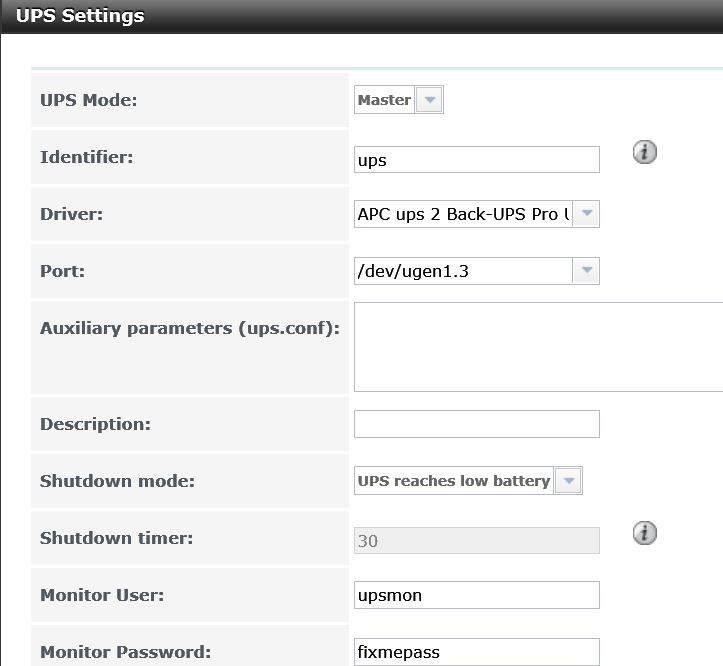

Hello!
My new FreeNAS box finally works and I happy to report success.
Now I got my APC connected and configured and I see following in logs:

This is how config looks like. Not sure what is wrong?

Which build of FreeNAS (from System -> Information)?
What is the exact model of UPS and is it USB or serial?

Latest build:
S-9.3-STABLE-201509220011
It's USB connection (from RJ45 on UPS to USB on FreeNAS)
It's Back-UPS Pro 1500
And I use this driver: "APC ups 2 Back-UPS Pro USB USB (usbhid-ups)"

It works, I guess. But those warnings occasionaly pollute console output

In auxiliary parameters, try adding:
MAXAGE=30
I don't have experience directly with this on FreeNAS, but have seen similar threads related to pfSense. Basically, the UPS isn't getting polled fast enough to keep NUT happy (at least with default config). This switch should allow 30 seconds before the data is marked stale, which should still be plenty fast enough to detect a power loss and shut down your NAS cleanly (if not, you need a bigger UPS!)

Tried that, but after service restart I started to get those messages:
psmon[11371]: Poll UPS [ups] failed - Driver not connected
Sep 26 11:08:43 HOME-NAS upsmon[11371]: Poll UPS [ups] failed - Driver not connected
Sep 26 11:08:48 HOME-NAS upsmon[11371]: Poll UPS [ups] failed - Driver not connected
Sep 26 11:08:53 HOME-NAS upsmon[11371]: Poll UPS [ups] failed - Driver not connected
Sep 26 11:08:58 HOME-NAS upsmon[11371]: Poll UPS [ups] failed - Driver not connected
MAXAGE=30
IIRC that workaround does not survive a re-boot.

I'm not 100% what is that topic about. So, can I fix this somehow?
