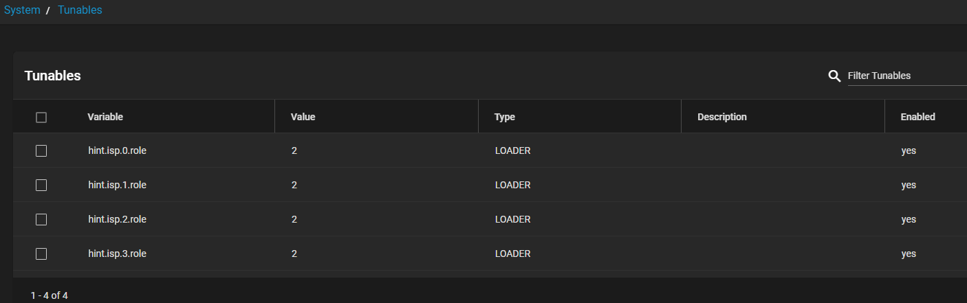

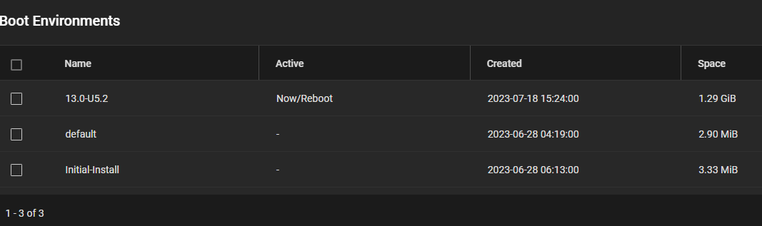

Have you tried booting to a previous environment from the System -> Boot menu?
The only thought here is that somehow the previous environment was using a RAID-aware driver (possibly through a tunable?) and your updated installation has shifted to attempt to communicate with the raw disks, and it's not understanding the PERC-supplied header that it's getting from the raw disks.
Yes. I have tried them all with no luck.
I personally did not mess with any tunables. This is what is in there now.

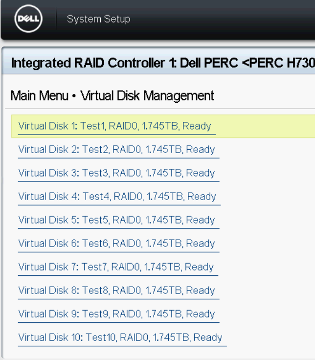

If you go into the PERC configuration tool (via the BIOS/EFI, for example) do you still see all the virtual RAID0 volumes?

Yes.. I still see them.
I am not taking it negatively. I am soaking up all the knowledge you are putting out. As i said, i am no guru on TrueNAS. I do appreciate all the feedback and knowledge.
