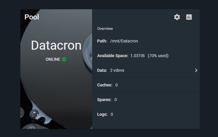

So I was able to go into the shell and use command zpool import "pool name" and that brought the pool back online. Now i just have to set up the plex plugin again.

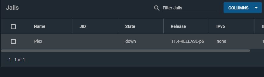

So I did the first half and created a new Plex Jail (see photo). How do I get all of the files I previously had in the old plex jail (see photo) connected to the new jail?

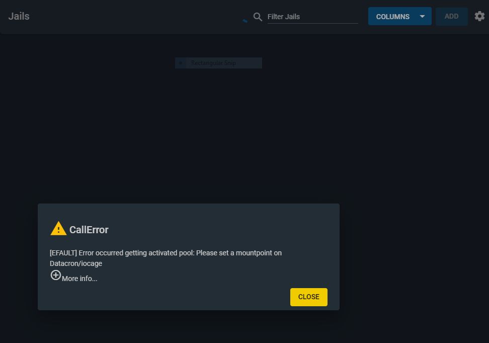

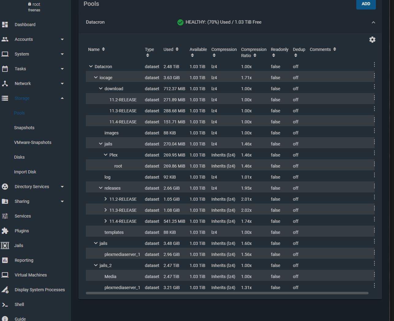

So i couldnt get plex set up again, mainly because when I set up the jail I didn't know where to find my files to mount the jail (with my limited knowledge this is what i think was the issue). I deleted the new jail I created after I updated the OS ( I had to make a new jail because my old jails weren't showing up after i went from 11.2 to 11.3 even though they show up in the storage tab) I deleted the new jail because I thought I might have set it up wrong (again, i am a N00b at this whole server thing, i can follow directions but i dont know really what i am doing lol).
So I took some time off of trying to fix my server bc it was just getting frustrating and work was getting busy. Now that I have a week off I wanna get this plex server back up. Anyone know what I am doing wrong or what I need to do?

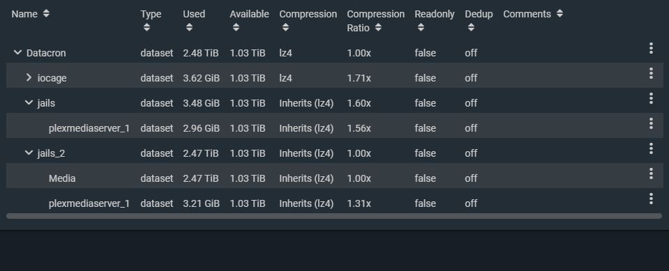

Also, should I delete those old jails that show up in the storage area but not in the jails tab?
The only files i put on this server is when i would use SMB permissions and i had a movies folder and a tv folder. So how do I find those two folders to re-set up plex?
Samuel Tai
Apr 24, 2020
5,399
Did you read the release notes for 11.3? If you had, you would’ve seen that the old 11.2 warden jail system was being replaced in 11.3, as it was no longer maintained. There’s a migration script in /usr/local/sbin/migrate_warden.py specifically for this contingency. Delete the new plex jail, and run the migration script from the GUI shell.
