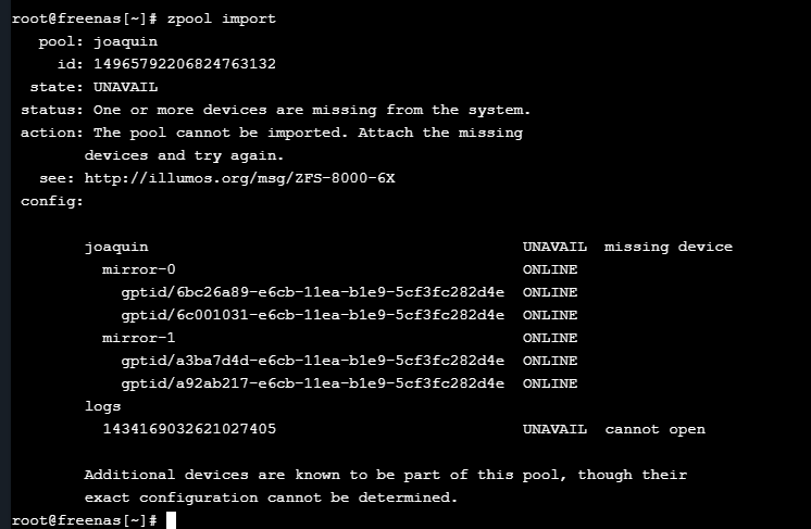

try zpool import command and it shows me this

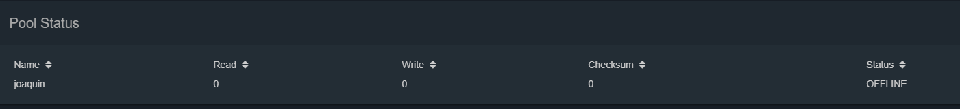

on the other hand the state of the pool in the webui is this
I would like to know how I can return the pool to the online state without having to import the pool from the cli since I have done this before and it does not solve the problem

From the CLI, the zpool import -m option should allow that pool to be imported. I'm not sure how the GUI would behave, but the worst case is that you import in the CLI, export, and then import in the GUI.

root@freenas[~]# zpool import
   pool: joaquin
  state: UNAVAIL
 status: One or more devices are missing from the system.
 action: The pool cannot be imported. Attach the missing
        devices and try again.
   see: http://illumos.org/msg/ZFS-8000-6X
 config:
        joaquin                                         UNAVAIL  missing device
          mirror-0                                      ONLINE
            gptid/83f12c46-e7c4-11ea-982a-5cf3fc282d4e  ONLINE
            gptid/842877d6-e7c4-11ea-982a-5cf3fc282d4e  ONLINE
          mirror-1                                      ONLINE
            gptid/9dafed98-e7c4-11ea-982a-5cf3fc282d4e  ONLINE
            gptid/9e195b02-e7c4-11ea-982a-5cf3fc282d4e  ONLINE
        logs
          4813699577927614805                           UNAVAIL  cannot open
        Additional devices are known to be part of this pool, though their
        exact configuration cannot be determined.
I am really concerned that simply turning off the power to the ssd slog might cause so much trouble to access the data again.
And I do this same test in later versions of freenas and it was solved with zpool import tank and then removing or replacing the slog from the web ui. but in this new version (11.3) I have not been successful.

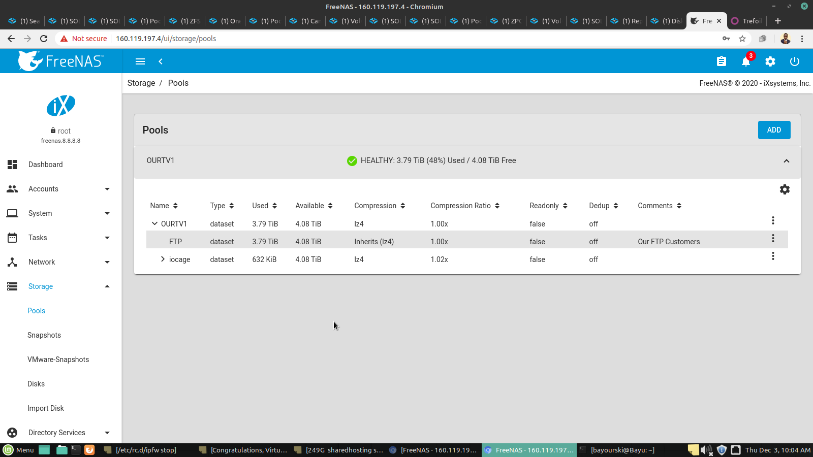

After running the command zpool import -m -R /mnt "OURTV1"
and zpool import -F OURTV1 to import the pools

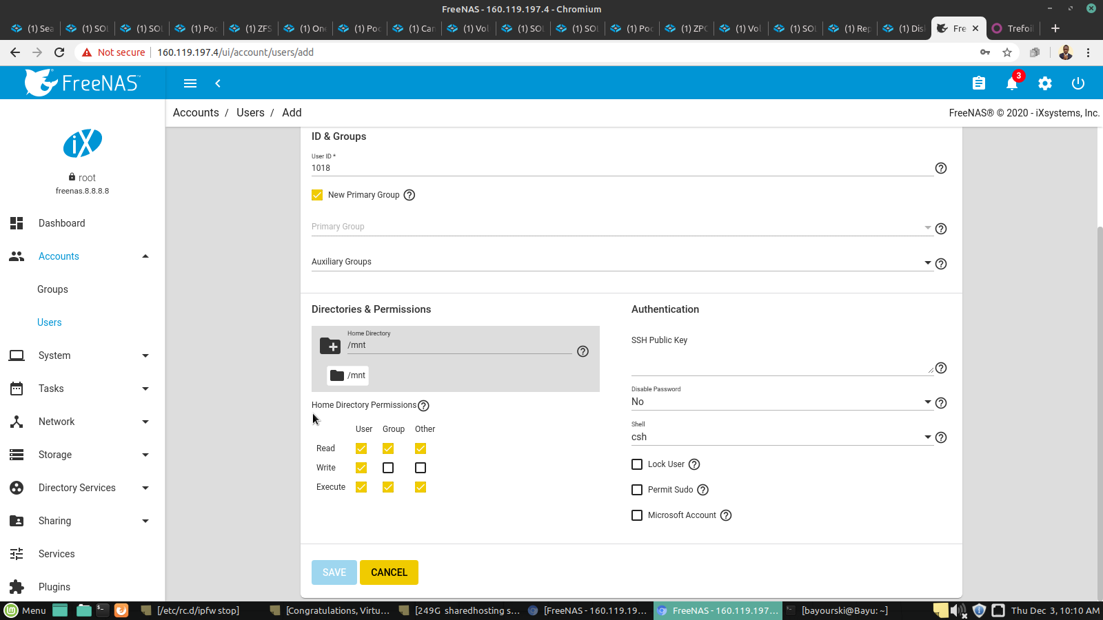

However everything came back online but I cannot access my files in the FTP dataset. Every users with FTP accounts cannot log in to access their files. Please is there a way to have access to the files so that i can even back up some of the files or is there a way where everything can be back to normal?
In the user creation here, the directory /mnt cannot be accessed to the other directory containing large voluminous files.
Please help
