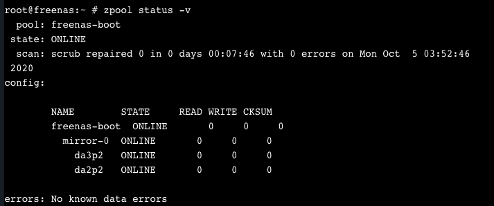

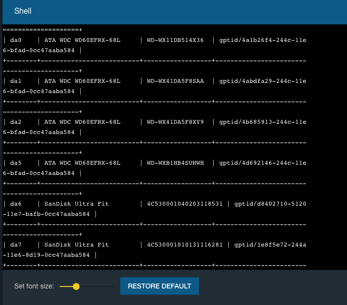

earlier this week I got a warning that my pool status was degraded. One drive showed as unavailable and gave the gptid but I could not match it to a serial number of my drives. The next day I checked again and now it said one drive was unavailable and one was faulted.
I have 7 hdds but both glabel status and a script I found in this forum only showed 4 drives with their gptid/serial:
Since I couldn't figure out which of the 3 remaining drives are bad, I turned off the server. Today I wanted to try and figure it out again, but now after turning it back on again it says pool status unknown and only lists 2 drives:

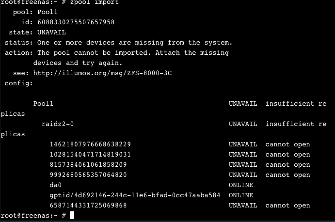

zpool import shows this:
Any idea what's wrong? I'm a complete noob when it comes to freenas.

The system is correct when it's declaring that "one or more devices are missing" - it cannot see enough of the drives of your Pool1. They're not showing up in FreeBSD, so naturally ZFS can't see them.
How are they physically connected? I see the motherboard has a bunch of SATA ports, so if you're using those and all was well you should be able to see all the drives in the BIOS. Through a SATA/SAS card? Seems like it may have come loose/died. Are they all spinning up? Cables not worked their way loose?
If you get to see the drives in the BIOS (and/or addin card BIOS), we'll move forward to further troubleshooting.

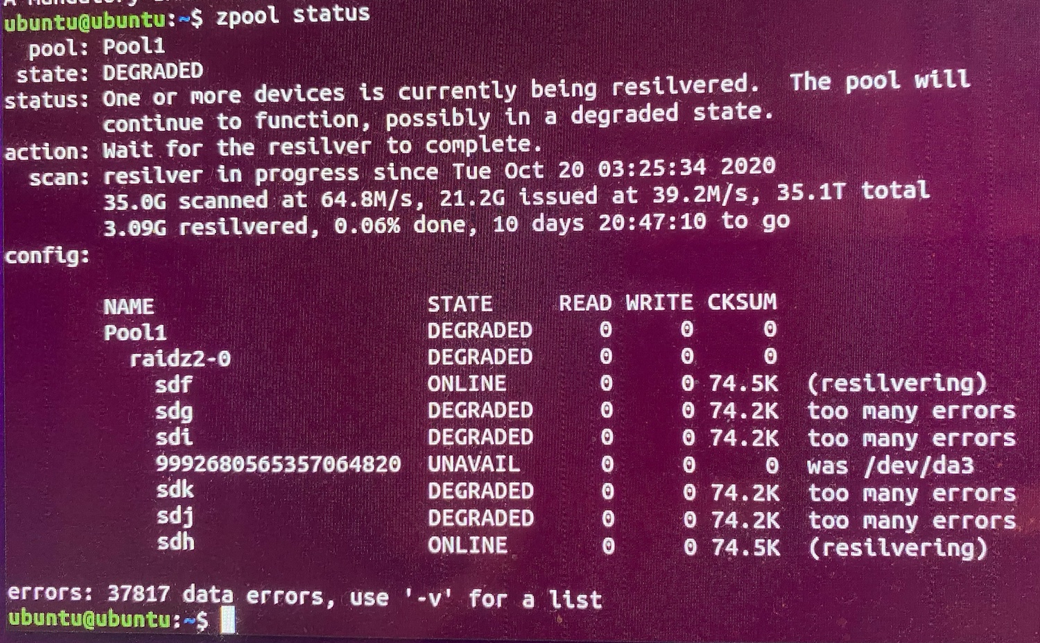

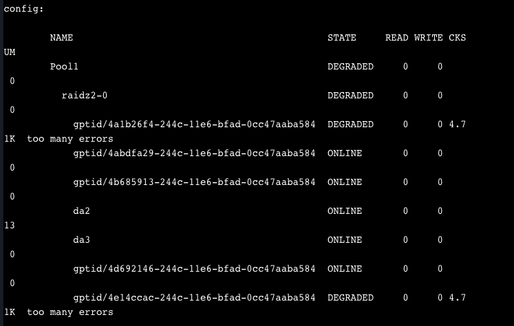

This is what zpool status shows:
So if I understand correctly 4 drives are about to fail, and 1 has failed based on the info above.
I am not sure why it started resilvering as I did not replace any of the original drives... I ended up just disconnecting drives as it said it would take 10 days and I could not keep it running as I need my mac for work.
What's the best way to proceed from here?
I will try installing the drives in the server again with different cables, and then should I replace the 1 unavailable drive first? If I need to replace 5 drives in total, would it make sense to just create a new pool with larger drive capacities (currently my drives are 6tb)?
Thanks for your help!

Wow, that's pretty horrific. Given the disk move, I think we can probably trust that those disks probably are going bad. The "37817 data errors" are blocks that have been lost, with no readable replica copies left on the remaining drives. Resilvering won't help those, as there's no source unless more of the drives come back online. I've been there. Now is the time to start planning for full data loss, I'm afraid.
The READ/WRITE error columns aren't trustworthy - they're progressively logged as errors happen session specific (a reboot, remount, export/import or 'zpool clear' will reset them). CKSUM is nonpersistent too, but it's filled as the scrub/resilver progresses and annotates the issues found.
I suspect the original resilvering was due to one drive dropping out for a moment, then recovering - that still triggers a resilver to get the dropout drive back up to date.
Do you have a backup of the stuff you want off the pool?
If no: Gather a small stack of HDDs to use to fix this. You'll need at least one, maybe five. Put them into the supermicro and run the burnin tests suggested by jgreco in the Hardware forum stickies - https://forums.freenas.org/index.php?resources/solnet-array-test.1/ You don't want the replacements dying while you're trying to salvage the array. Test and set them all to one side.
Put all the Pool1 disks back into the Supermicro so you can at least do the same check there, and do the 'zpool status -v' to get the broken files list to see what is lost. Last time I had three disks go bad out of a RAIDZ1, I was insanely fortunate in that the files lost were all in my 'backups of other systems' dataset so were actually disposable. I recovered by removing the UNAVAIL disk because it really waas dead (do this by elimination - the missing serial number from the Storage/Disks GUI page - to ensure you pull the right one!); adding progressively more hot spares which replaced the failed (UNAVAIL) and failing (DEGRADED) disks, resilvered. After that completed I 'detach'ed the DEGRADED disks and removed those, which promotes the spares to full replacements. Finally I deleted the files still named by zpool status -v, and I fully recovered the array.
If you have a backup OR the broken files list makes recovery pointless, give up. Run all the disks through burnin tests and toss any with bad results from SMART short/conveyance/long tests, or with reallocated sectors, or that trip up in the solnet.sh testing. Make an array from the remaining disks and any addins, and start again. Design your system so you can have a backup of anything that is essential.
