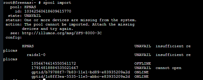

Diagnostics:
"zpool import" shows the following
root@freenas:~ # zpool import
pool: HPNAS
state: UNAVAIL
status: One or more devices are missing from the system.
action: The pool cannot be imported. Attach the missing devices and try again.
see: http://illumos.org/msg/ZFS-8000-3C
config:
HPNAS UNAVAIL insufficient replicas
raidz1-0 UNAVAIL insufficient replicas
1056674614550561172 OFFLINE
17914818884535021667 UNAVAIL cannot open
gptid/b79788f7-7b83-11e1-bd89-e83935209a ONLINE
gptid/1c8ff3ea-5535-11e5-abbc-e83935209a ONLINE

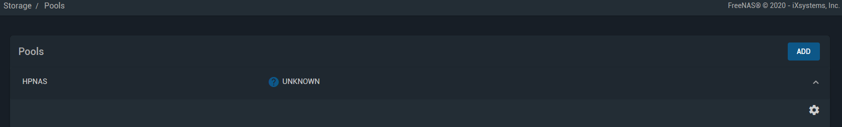

"Storage / Pools" shows the following
HPNAS UNKNOWN

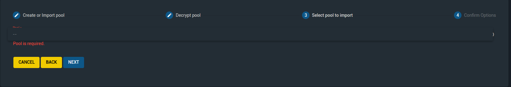

Note1: If I select "Add" and attempt to "Import" a pool, at Step 3 (Select Pool to Import), there are no pools (ie. it shows -- in the drop down list)

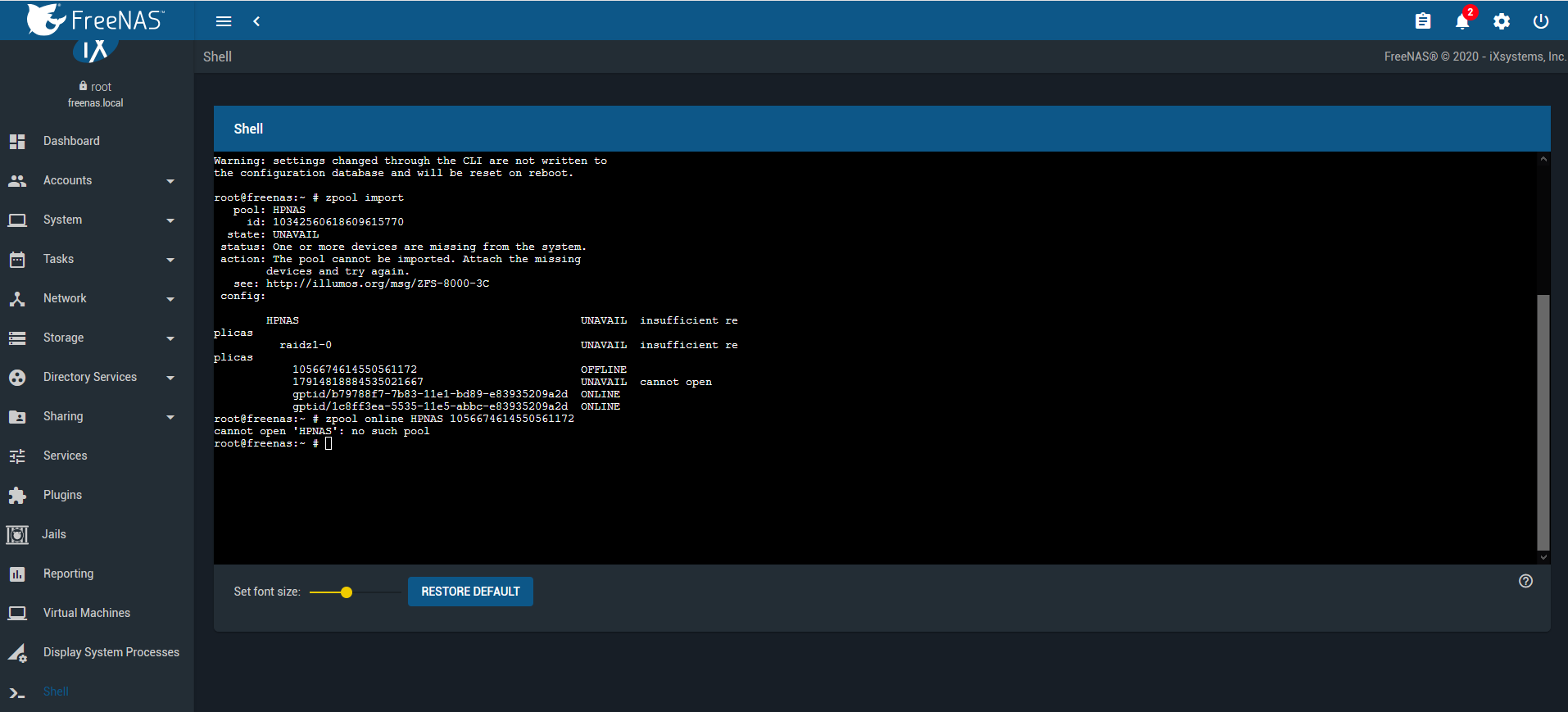

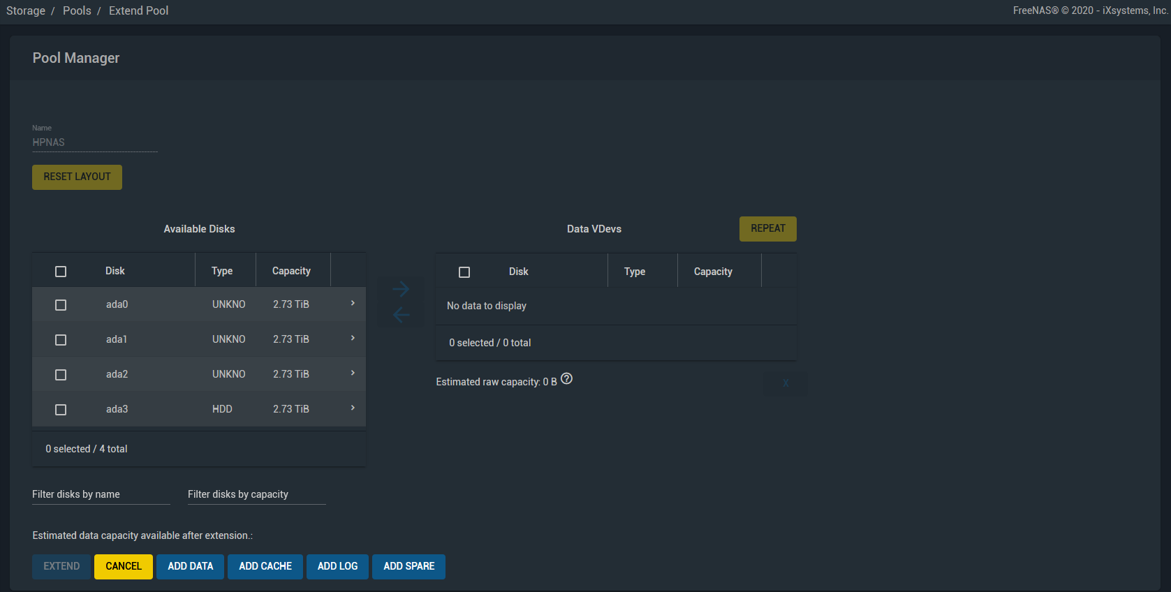

In short, I just want to get the zpool back up and running. I tried to run "zpool online HPNAS <disk>" and "zpool online raidz1-0 <disk>" and both cases it said "no such pool". I also tried to "extend" the pool (Storage / Pools / Extend Pool) but I had no idea what I was doing and it threatened to wipe the disks.

Doe this help? See attached image. You can clearly see HPNAS exists.
I typed in "zpool online HPNAS 1056674614550561172" and it says "cannot open 'HPNAS' : no such pool or directory".
Can someone even tell me if "1056674614550561172" is part of any pool?
Thank you.

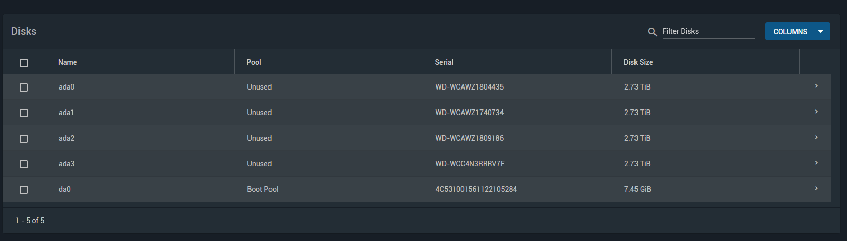

After spending the better part of a day looking for more information, I have found the following (I think so...).
1. When you take a disk offline, it's online status can only be determined by having three other workings disks.
2. The disk that is UNKNOWN was quick formatted by mistake. This means the content is on the disk, but, the filesystem is wiped.
so, I tried "gpart recover ada1" (the disk I think was quick formatted). It told me the disk didn't need to be formatted.
I also answered my question 'is "1056674614550561172" is part of any pool'? The answer is no. Under Storage / Disks, you see the list of disks. Each disk will tell you if it belongs to a pool. My four drives all list "Unused", meaning these disks aren't part of a pool.
I'm still trying to work out how to move forward. I think my best bet (if possible) is to recover ada1.
