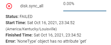

I noticed this in my Task Manager in the UI.

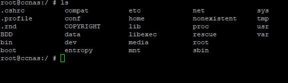

I noticed the folder "BDD" is now under my Root path and not my mnt path why is that? This is causing my shares to not work.
Samuel Tai
Apr 24, 2020
5,399
Yes, that's because you used zpool import BDD from the command line without specifying -R /mnt. You'll have to wait until the resilver completes, and then export your pool, and then use the GUI to reimport your pool.

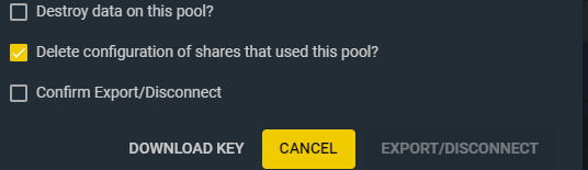

teztaz
Mar 26, 2018
21
I am assuming I just have it for the delete config? Does that mean I will have to redo the shares?
