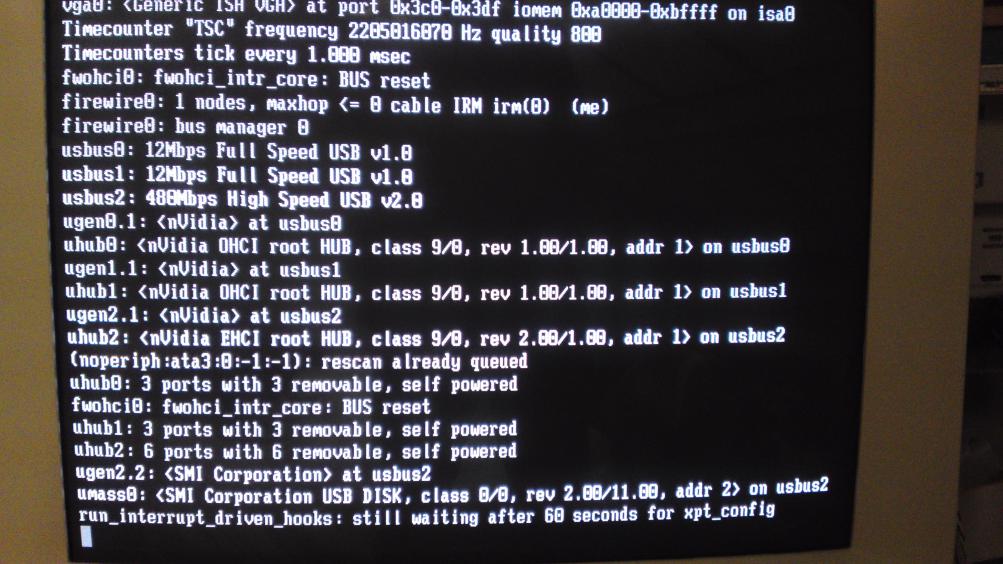

During the installation the process stops with the message:
"run_interrupt_driven_hooks: still waiting after 60 seconds for xpt_config"
The time counts up as more time passes, i.e. "120 seconds", but the installation does not continue. (Photo of messages below from 8.0.2):

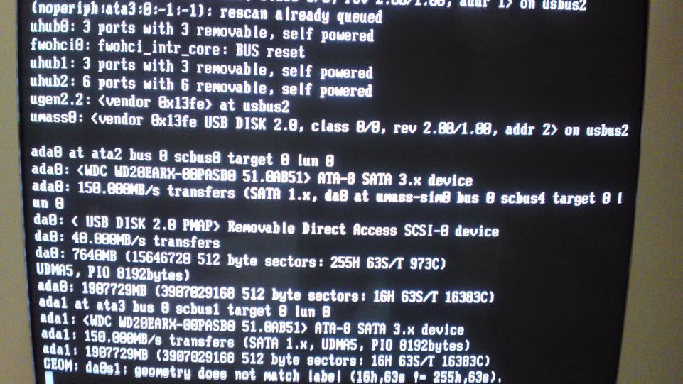

As a comparison I have taken a photo of the messages on my working rc1 just after the "umass0" message:
If anyone has any suggestions on how to get this working it'd be most appreciated. It does seem that a background change between rc1 and rc2 has caused this to occur. Something related to freebsd update?
