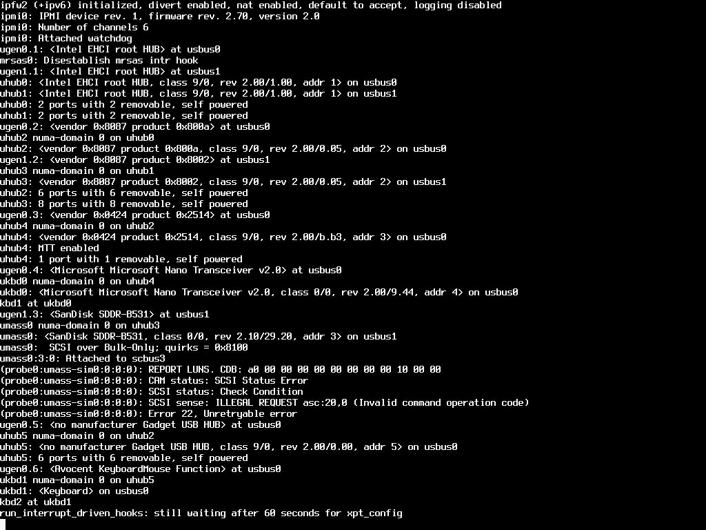

Same issue here, but I can get it to install. But boot time is .... RIDICULOUS. I can go make my lunch, eat it and start to digest it before its back in the OS. This issue is new for me since FreeNAS-11.3-U3.1
I have the H730 mini card in HBA though, not the 330.

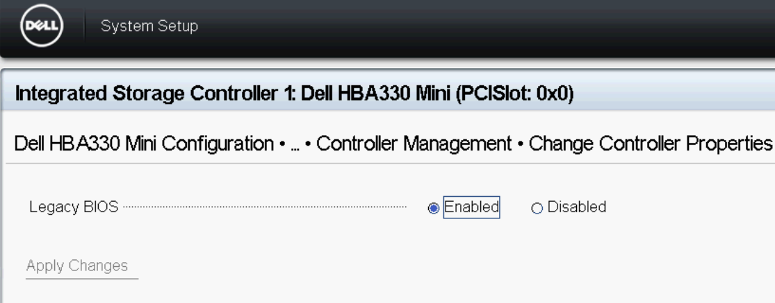

System BIOS Boot Mode: BIOS (actually tried both, BIOS & UEFI)
HBA330Mini Firmware: 16.17.00.05
HBA330Mini Legacy BIOS: Enabled
still stuck :(

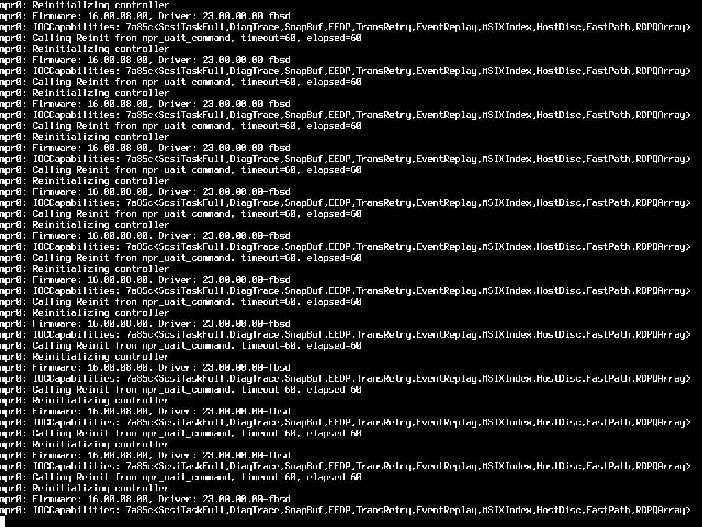

Seems like it's trying to reinitialize the controller

Apparently the hiccup was in X2Apic Mode being Enabled, as soon as I set it to Disabled, install went through nicely.
@Samuel Tai pointed me to this bug
FreeBSD bug report
from another thread I started
