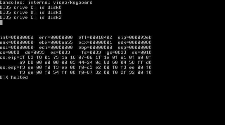

Unfortunately it's still unable to boot properly after a reinstall with selected BIOS mode, although with a different error that suggests it doesn't even reach the bootloader.
Some of the Supermicro FAQ's suggest that to boot from a NVMe drive it needs to do so in UEFI mode. I'm curious, what's so problematic about it?

Happy New Year! I finally managed to get some time after the holidays, and I did a few more tests with various OS versions. It turned out that the system can actually boot in BIOS mode from the NVMe drive after all. Here are the results, both for UEFI and BIOS modes. In the TrueNAS Core installs, the corresponding boot mode (UEFI or BIOS) has been selected during the installation process.
UEFIBIOS
FreeBSD 12.4No (ZFS i/o error)Yes
FreeBSD 13.0YesYes
FreeBSD 13.1YesNo (BTX halted)
FreeBSD 13.2YesNo (BTX halted)
TrueNAS Core 13.0-U6.1No (ZFS i/o error)No (BTX halted)
TrueNAS Core 13.1-master (20240101)YesNo (BTX halted)
TrueNAS Scale 23.10.1YesYes
I'm not sure what to make of these, especially considering that the latest master of TrueNAS Core 13.1 does work in UEFI mode, while the earlier build I tried did not. The best part is that the current stable TrueNAS Core (13.0) is not able to boot in both modes.
