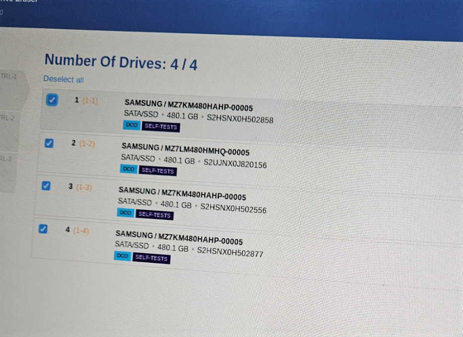

After installing TrueNAS perhaps a week ago, I used some clean sata drives (SSDs) to create a pool. I transfered data over to the pools and CAM errors started occuring for around 24 hours. This stopped afterwards and no errors showed up on the consosle. The drives were tested later to find they did not have DCO's or HPA's, but were somehow modified (Blancco reports DCO: "unidentifiable", HPA: "unidentifiable" - when the baseline should be "doesn't exist") with remapped sectors.

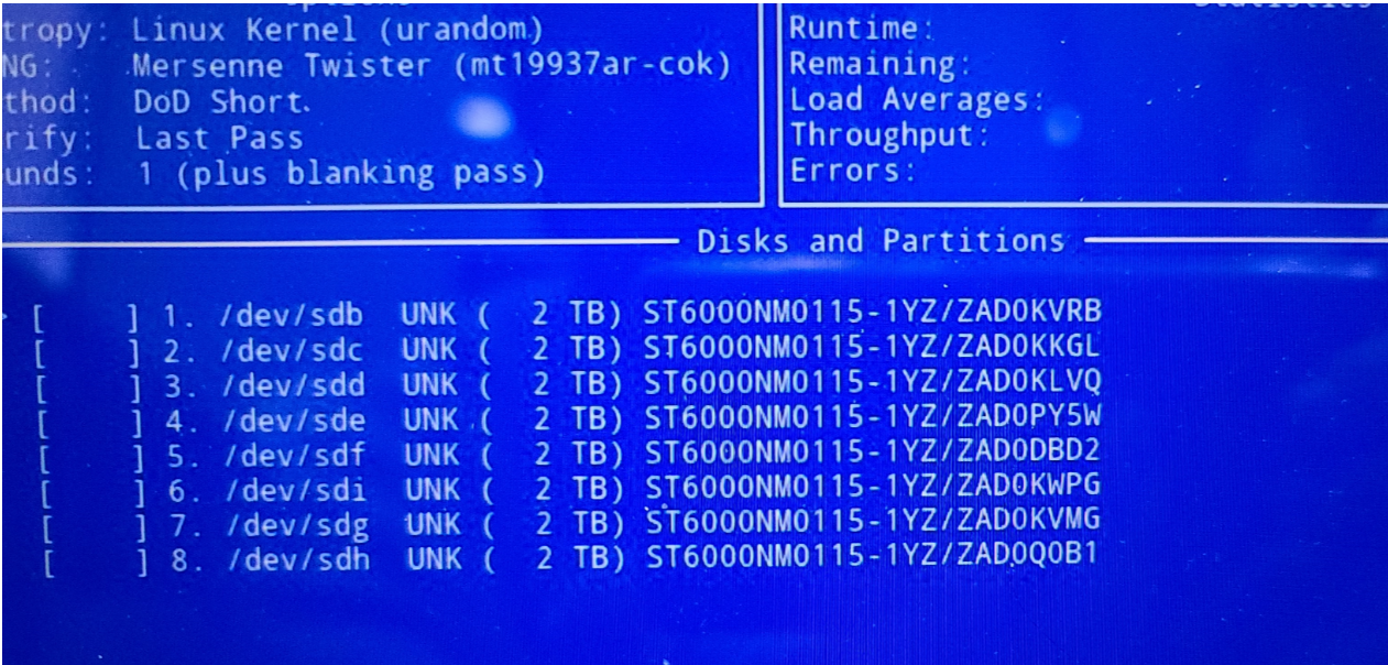

2. Currently, Blancco is the only tool I know of that can see and attempt to delete these areas. Each time they're discovered, Blancco will fail to remove the DCO (or HPA). Has anyone had this experience? What tool did they use to wipe the drives or get rid of the hidden areas?

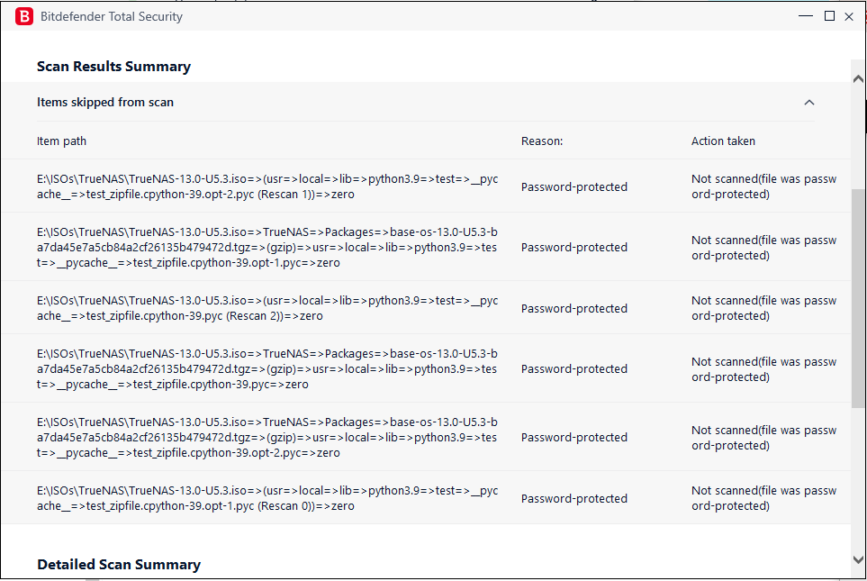

During virus scans of any TrueNAS ISO, it always encounters multiple files which are password protected, and can not be checked for malware/viruses. Why is this?
Surely it would be easier to answer this question if you identified the files in question, and perhaps the virus-scanning tool that's reporting this.
These are the files in question, usually it's 3 files; attachment of screenshot for result of scan:
Log File
TrueNAS-13.0-U5.3.iso=>(usr=>local=>lib=>python3.9=>test=>__pycache__=>test_zipfile.cpython-39.opt-2.pyc (Rescan 1))=>zero
TrueNAS-13.0-U5.3.iso=>TrueNAS=>Packages=>base-os-13.0-U5.3-ba7da45e7a5cb84a2cf26135b479472d.tgz=>(gzip)=>usr=>local=>lib=>python3.9=>test=>__pycache__=>test_zipfile.cpython-39.opt-1.pyc=>zero
TrueNAS-13.0-U5.3.iso=>(usr=>local=>lib=>python3.9=>test=>__pycache__=>test_zipfile.cpython-39.pyc (Rescan 2))=>zero
I use bitdefender. Does anyone else run scans to find some files within the ISO was skipped?

I find it curious that you posted two functioning screenshots that show nothing particularly out of the ordinary (apart from one the tools misreporting a disk's size as 2 TB, which is rather conspicuously the limit imposed by the MBR partition table format), alongside two broken screenshots that would presumably show something more out of the ordinary.
This was just to illustrate that this was happening. I'm sure it's not happening to everyone else; just that it was happening. Hoping to find how and what I could do about this. The focus is more on whether I can continue using truenas or if I had to resort to another tool for backups; ie. external drives, USB's or Synology/QNAP

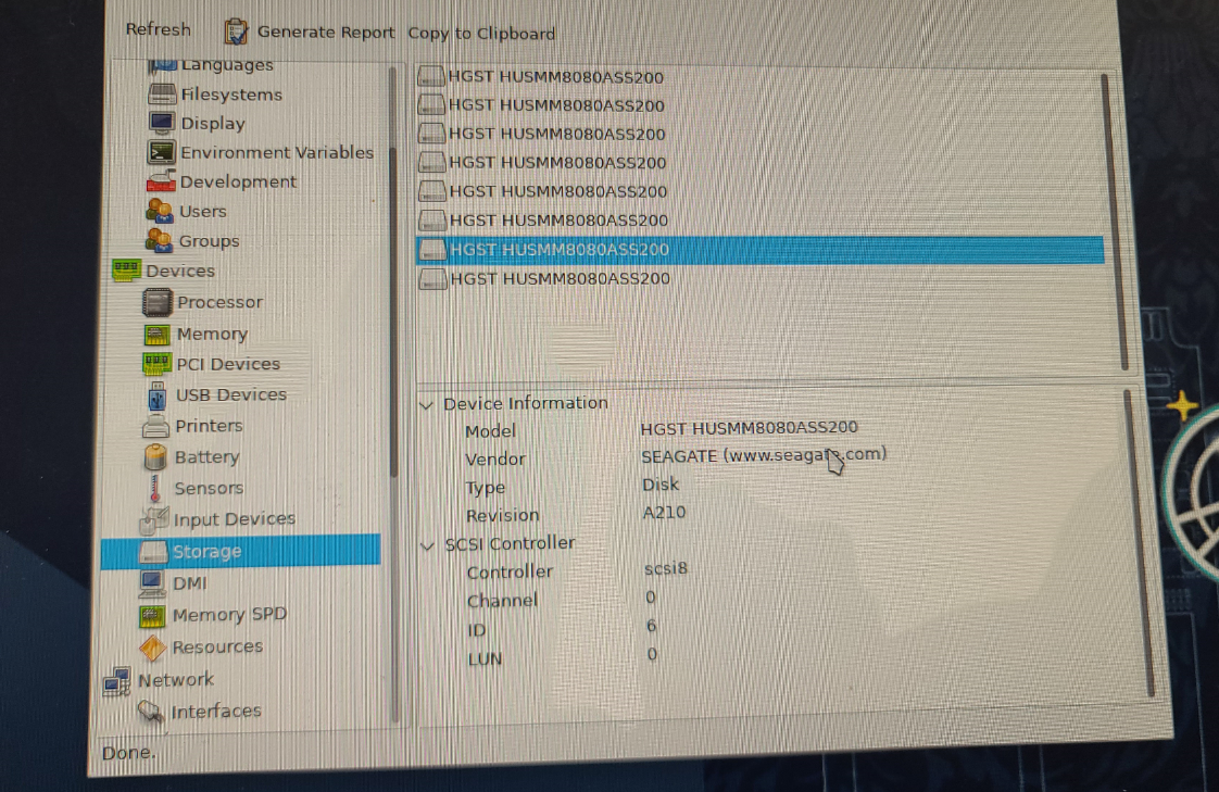

I just realized, some of my images were deleted by the mod. Or the files were broken?
Here is one where parted magic (paid version) reports HGST SAS SSD's as Seagates. These are Hitachi's... definately not Seagates:
They were, please feel free to (re)upload anything you deem useful. I deleted the originals so people wouldn't waste their time trying to open corrupted files.
Here is one where parted magic (paid version) reports HGST SAS SSD's as Seagates. These are Hitachi's... definately not Seagates: View attachment 69742
I would put that down to parted magic's database being incorrect. I think SMART data does not explicitly include the manufacturer, just the model number.
I can't find any such file on the .iso--there's no /usr directory there at all.
...but if I extract the base-os .tgz file, this directory structure and file are present. It is, as I'd have expected from the file extension, byte-compiled Python code:
root@truenas[.../local/lib/python3.9/test/__pycache__]# file test_zipfile.cpython-39.opt-1.pyc
test_zipfile.cpython-39.opt-1.pyc: python 3.9 byte-compiled
It appears that projects like https://github.com/rocky/python-decompile3 are able to decompile such code.
