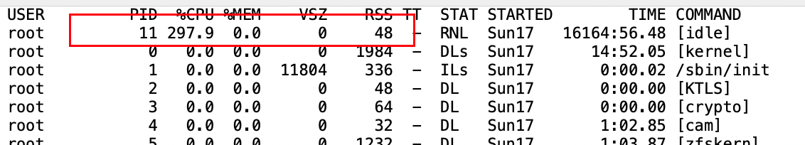

uname -a
FreeBSD truenas.local 13.1-RELEASE-p7 FreeBSD 13.1-RELEASE-p7 n245418-79e75956dbb TRUENAS amd64
ps axuww
Looks like a python process crashed.
I could login on the web UI again when i run service middlewared restart in CLI and the GUI came back, but after a period of time, the fault will reappear
I don't know how to settle this problem
