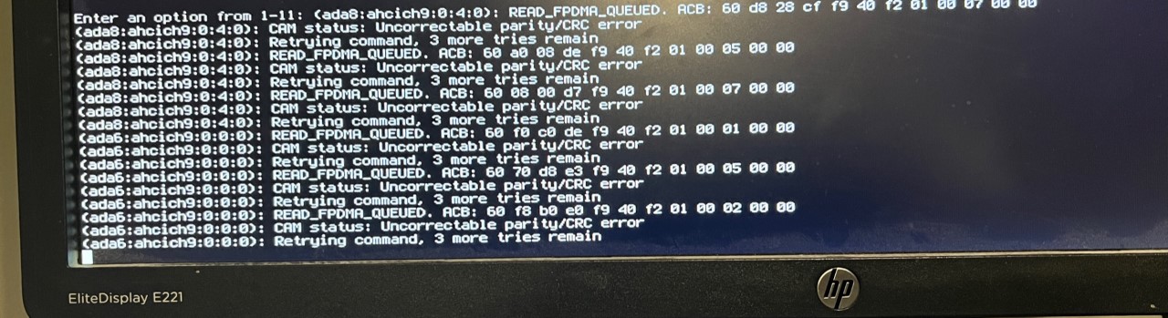

I have two Truenas systems. A main and a backup. I got my backup going and am transferring data from main to backup. The large file transfer is messing with my main truenas. I first noticed that plex stopped working. then i couldn't get to the web interface to see what is going on. It just says "Connecting to TrueNAS ... Make sure the TrueNAS system is powered on and connected to the network." It is still connected because i can see the file transfer still taking place on my backup device. I can also still ping the main truenas. I thought maybe the output was causing issues which is why plex is not working. I purchased two sfp pcie cards and put those into both truenas boxes and have them connected peer to peer and have RSync set up to use that nic for file transfers leaving the main nic open for everything else. I kicked off Rsync and i've lost plex again and can no longer get into the web interface on the main truenas. I plugged a monitor into the main truenas and am seeing the following error, "freenas.local collected 3066 - - plugin_dispatch_values: Low water mark reached. Dropping 100% of metrics". Any help would be appreciated. I just upgraded from Freenas and didn't have any issues like this. This isn't just an issue with Rsync either. If i file share into each device from a windows machine and transfer files that way i have the same issue. Here are the specs of my main device.

It makes sense that the pcie expansion is the culprit. This has been a headless build and i just hooked up a monitor on it and saw the error i've attached. looks like a pool issue. I am currently testing ada 6 and 8 to make sure the drives are ok, but i'd be willing to bet that those two drives are on the pcie expansion.
So you have two - probably fatal issues.
1. SMR Drives. You are trying to dump a load of data to an pool based on SMR Drives - this will not work well. SMR drives are not fit for purpose. In particular WD RED SMR Drives are what I would basically describe as Landfill. If they are a recent purchase then send them back and get WD Pro, or some other drive type. Make sure they are not SMR
2. Your SATA adapter card almost certainly isn't an LSI HBA Card. This is also potentially fatal - what exactly is it? Your idea of using it for the boot drive and putting all the data drives on the motherboard is possibly a good one, but a better long term solution is to replace it with a proper card. See "Art of Server" on ebay for something that WILL work and won't cost too much. For HDD's you don't need anything more than a card in the 9200 range.
Others have posted links to stuff you NEED to read about disks and HBA's - as you clearly haven't done your research before spending money. TrueNAS is an excellent NAS but ZFS has certain basic requirements that aren't onerous, but are fatal if not adhered to.
