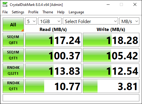

Apologies, but how does my post not conform to the rules? I just missed the type of LAN port, which is now updated. When I posted this, I was referencing the windows transfer speed measurement, but I've now run a test in CrystalDisk and it looks like I am primarily just saturating the network:
I'm very new to the storage game, but the exception to saturating the network is the RND4k Q1T1, which googling says is small file random read/write. Which... might be the case when I am doing large folder syncs with a variety of data?

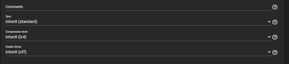

You don't have syncwrites always on, do you?

No, but I guess you used the standard values for everything?
We can rule out anything network related I think.
Yes, I don't really know what I am doing, so I had no reason to deviate from standard settings.
That's good that we can rule out networking because the "network" is just the single switch in the router.

And, for some reason, I can't find the syncwrites setting you are referring to if what I posted is not it.

You get 20 MB/s when copying files to the NAS? What about copying files from the NAS to your client?
Can you test this out with a single large 1 GB file of random data? From Windows to TrueNAS, this will be a large sequential write.
(The ARC/L2ARC won't help when writing new data to the NAS.)
SMB uses async writes by default, and your settings use the default, as seen in your screenshot. Sync is set to "standard", which lets the application decide.
You did, it's the Sync parameter in the screenshot you posted.
I just missed it before.
A single random 1GB file from an online generator moves in both directions at ~100MB/s
Trying to generate 1000 files of 1MB to see if that's it.
When I noticed things being slow, it was a mix of both larger files and small ones.
But did you test this over SMB from Windows Explorer? This way all your tests use the same method/software.
Yes, I am checking things with file transfers through explorer.
A folder with 1000 1MB files transfers at 30-40 MB/s.
FROM the NAS is 13-18 MB/s
