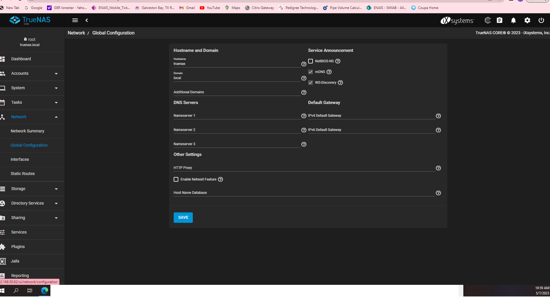

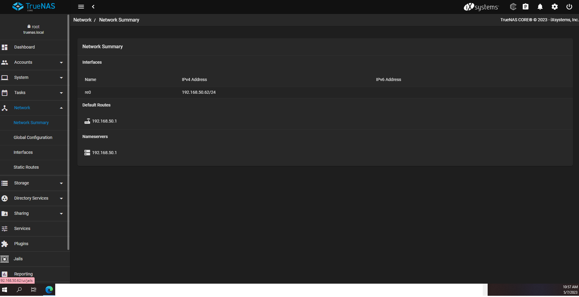

Cant get the plugin to install. Iave no idea what global settings should be. I have tried manual Vnet0 IPV4 24 and still get the github error message. NAT does not work either. Please any help would be greatly appreciated

So I actually got the Plugins to work after some tinkering. I've been doing this off of you tube videos and all of the videos I have watched the content makers have inadvertently omitted information. i set the IP in interfaces and did the install. It installed but to the wrong IP showing an IP starting with 172. I went into the install and changed the IP manually to a new IP 192.168.50.149 and BAM! in business. Thank you all of the assistance. I will be saving my configuration and will do more tinkering with script. This has been a fun and interesting project to say the least....
