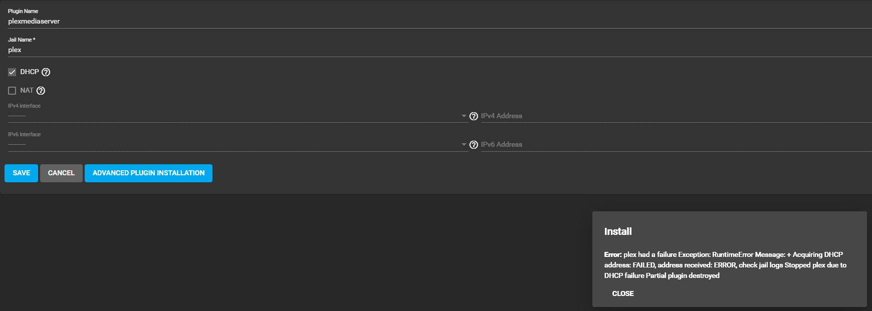

Hi All,
I'm very new to TrueNAS, so sorry if it's maybe a noob error :D
I was following a tutorial to install the PLEX Media Plugin but over and over again, I run into the same issue.
"Error: plex had a failure Exception: RuntimeError Message: + Acquiring DHCP address: FAILED, address received: ERROR, check jail logs Stopped plex due to DHCP failure Partial plugin destroyed"
I have the NAS installed as a local server, running it over my old PC. (16GB RAM, x64)
Anybody had the same issue and could fix it?
Many thanks in advance!
Samuel Tai
Apr 24, 2020
5,399
This is a common problem, and usually boils down to incomplete networking configuration on the host TrueNAS system. Have you configured a default gateway and DNS servers under Network->Global Configuration?

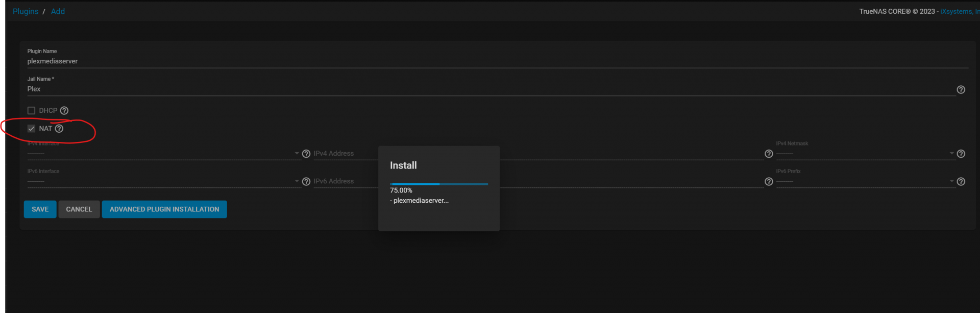

I have My TrueNAS os a Virtual Machine on VMware ESXI server.
Had to Disable DHCP / and enable NAT to get it working.
That got me completed.
