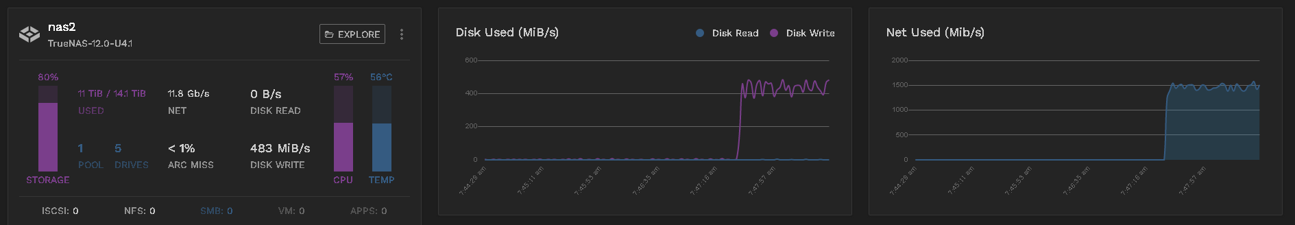

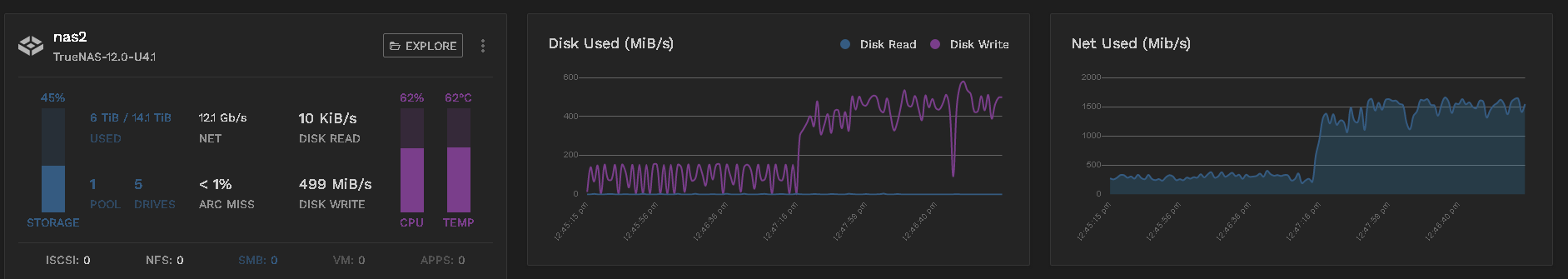

Net Speed, Disk Write, and Disk Used graphs are reporting inflated numbers | - |
The system tile does appear to be reporting the wrong figure (12.1 Gb/s). Based on the Net Used tile, 1500 Mib/s = 1.57 Gb/s, which is under 2Gb/s for multichannel SMB so that figure appears to be okay.If you look below, you can see it says 12.1GB/s net speed
I assume this has been correctly configured on TrueNAS? Setting up SMB 3 multichannel on FreeNASMy system has 2x 1gbit ethernet with multichannel SMB enabled.
There are some missing details and things you can try first.Please let me know if you need any further details or clarification as to what I am seeing.

#25-#27 | TC-1793 | Net Speed, Disk Write, and Disk Used graphs are reporting inflated numbers | 2.0.2 | - |
