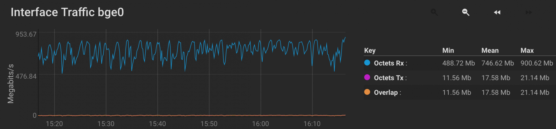

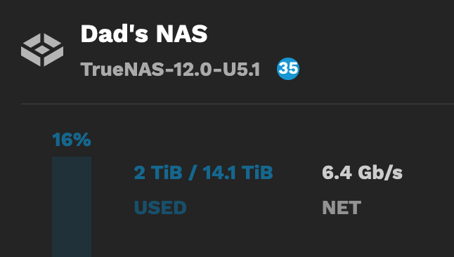

I think I've run into a TC2 issue--it's reporting implausible network utilization:
This system has two Gigabit NICs, but only one is in use. The system itself reports pretty good utilization of that one:
but obviously not multiple gigabits/sec.

morganL
Captain Morgan
Administrator
Mar 10, 2018
2,694
I added to the ticket... though it might end up creating another ticket.

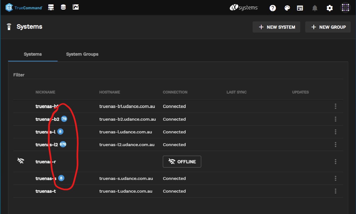

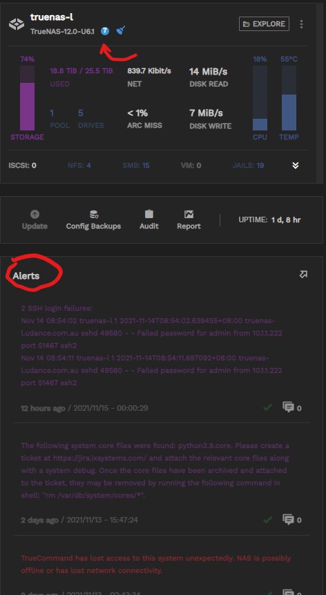

Alerts don't stay resolved in the latest nightly Master-20211111. This issue did not exist in the previous nightly. This issue is reproducible for TC on both CORE and SCALE. Browser caches were cleared before testing. I sense all these symptoms are related to the same issue.
These are some of the symptoms of the issue:
  1. Not all issues are resolved if all alerts are cleared.
  2. Resolved issues also reappear after a while.
  3. Resolved issues remain visible, but dimmed out.
  4. Multiple occurrences of the same issue.
  5. The alerts bubble never clears.
Reported under JIRA ticket TC-1870.

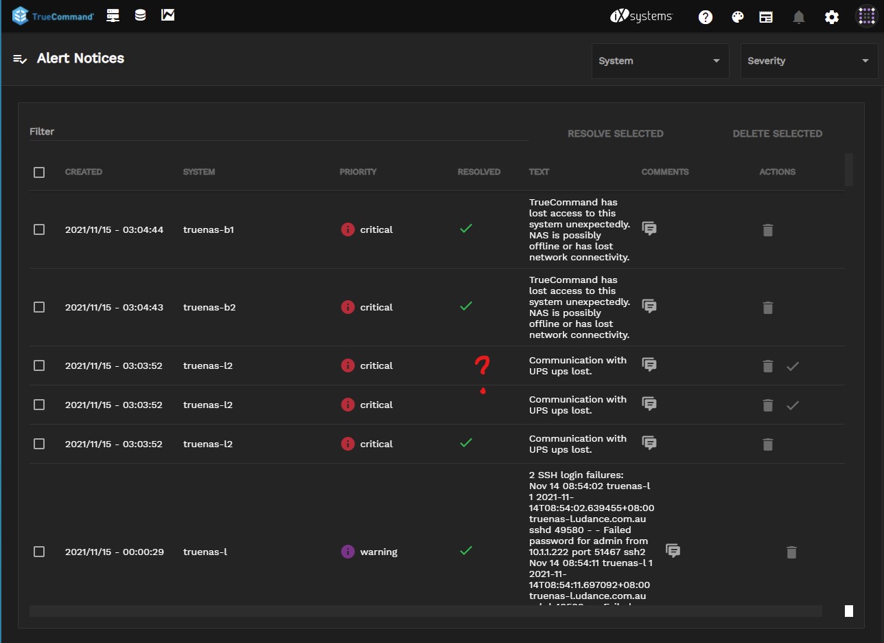

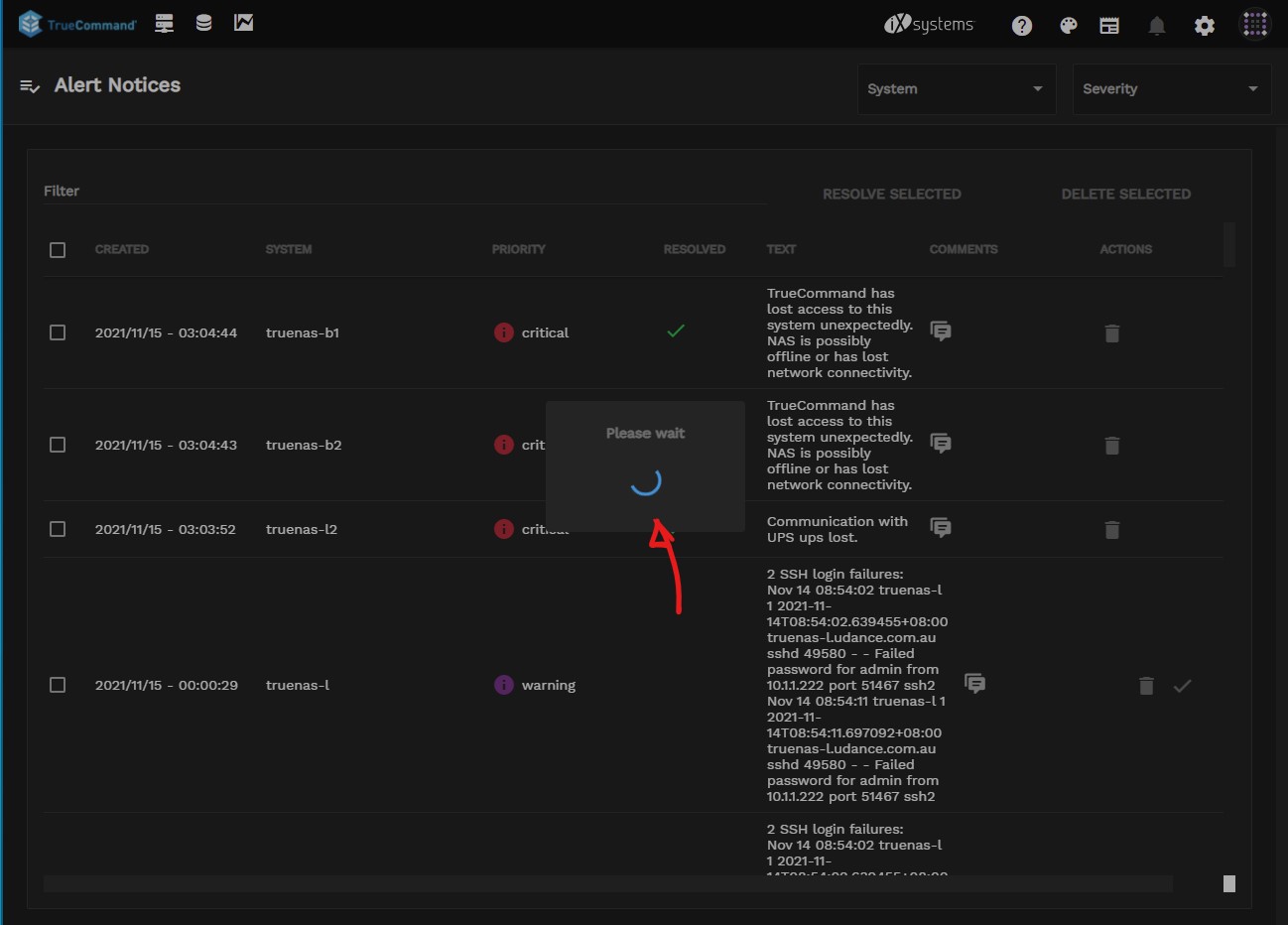

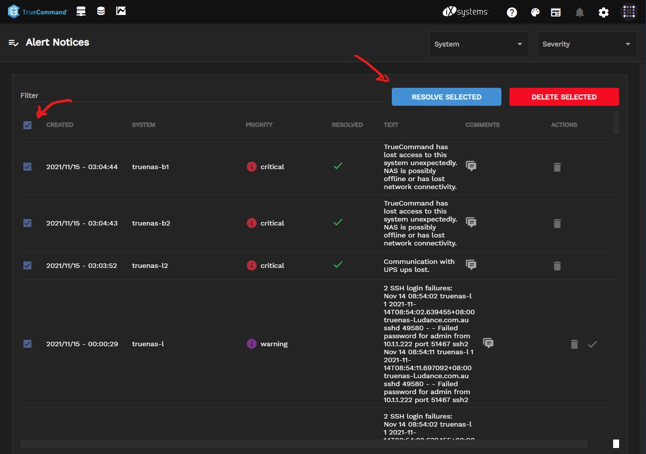

Resolving all alerts...
... doesn't produce the desired result.

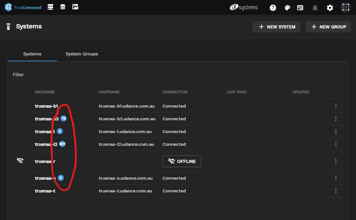

Here's a screengrab a while later. Note how the numbers have crept up. I can confirm these are not new issues, but previously resolved issues.
These numbers will keep increasing. It seems an issue that was resolved begins to reappear again and again and that's what contributes to the numbers incrementing.

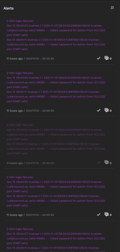

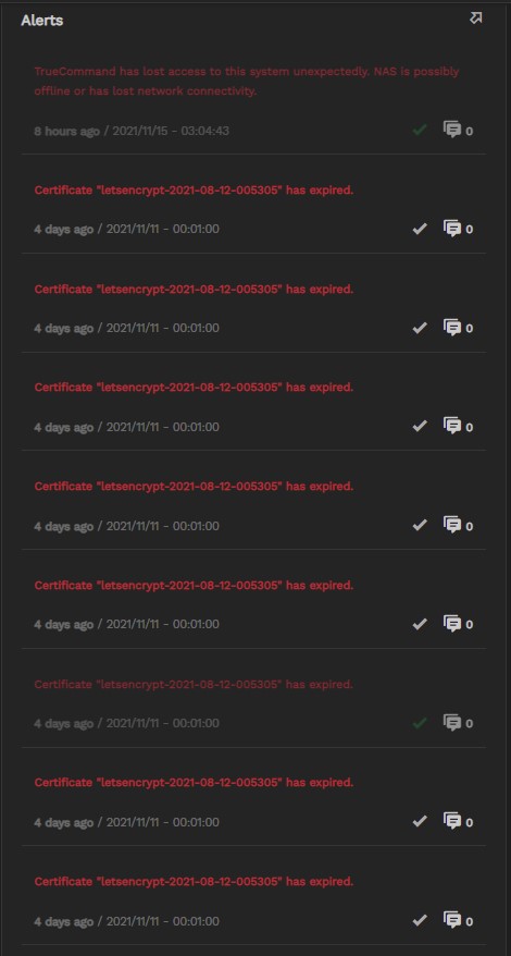

I'm pretty sure that once an issue was resolved for a specific system in the previous nightly, it disappeared from the alerts card for the system. This isn't happening with the latest nightly.
For specific systems, note how the same issue is repeated (identical timestamp)...

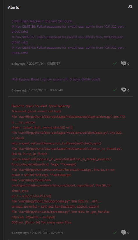

Here's an example of a system where alerts on the Alerts card were cleared, but the alerts bubble remains non-zero.
