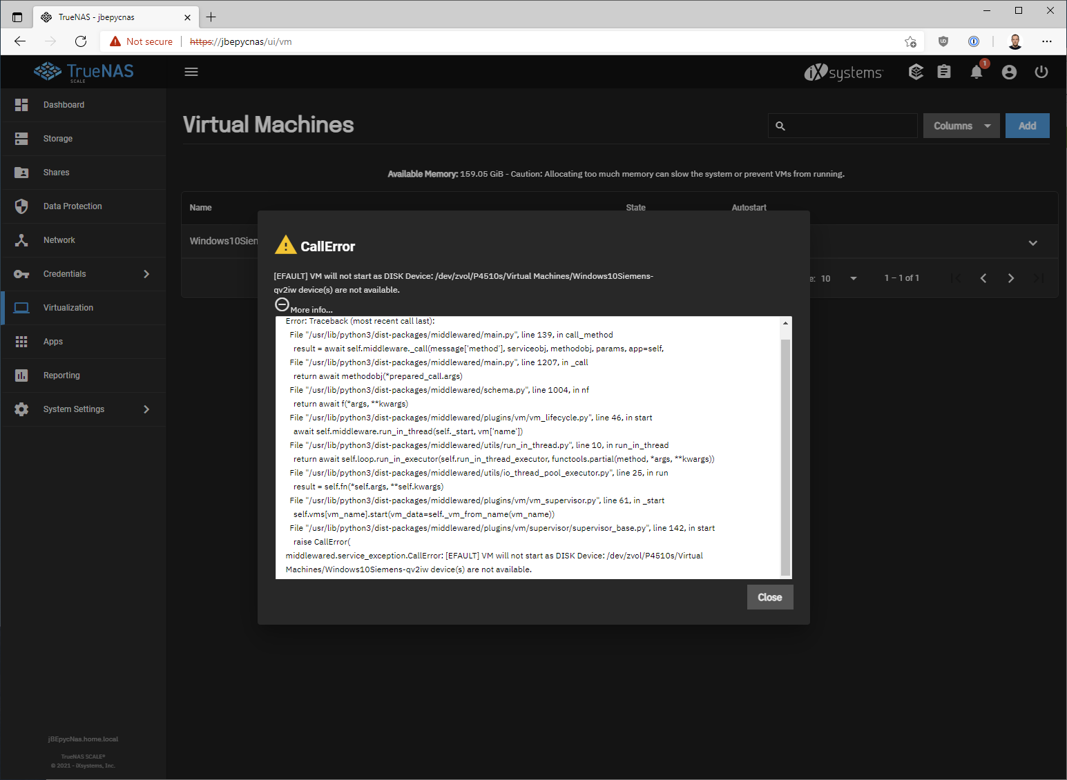

jbattermann
Newbie
Jun 25, 2021
Playing with 21.06-BETA.1 a bit and tried to created a new Windows 10 Vm which can be created but not started... it fails with "[EFAULT] VM will not start as DISK Device: /dev/zvol/P4510s/Virtual Machines/Windows10Siemens-qv2iw device(s) are not available." (see below) BUT that ZVol was created, see screenshot. Is there something missing / is it possible that some permissions are off or unexpected?
File "/usr/lib/python3/dist-packages/middlewared/main.py", line 139, in call_method
result = await self.middleware._call(message['method'], serviceobj, methodobj, params, app=self,
File "/usr/lib/python3/dist-packages/middlewared/main.py", line 1207, in _call
File "/usr/lib/python3/dist-packages/middlewared/schema.py", line 1004, in nf
File "/usr/lib/python3/dist-packages/middlewared/plugins/vm/vm_lifecycle.py", line 46, in start
await self.middleware.run_in_thread(self._start, vm['name'])
File "/usr/lib/python3/dist-packages/middlewared/utils/run_in_thread.py", line 10, in run_in_thread
return await self.loop.run_in_executor(self.run_in_thread_executor, functools.partial(method, *args, **kwargs))
File "/usr/lib/python3/dist-packages/middlewared/utils/io_thread_pool_executor.py", line 25, in run
File "/usr/lib/python3/dist-packages/middlewared/plugins/vm/vm_supervisor.py", line 61, in _start
self.vms[vm_name].start(vm_data=self._vm_from_name(vm_name))
File "/usr/lib/python3/dist-packages/middlewared/plugins/vm/supervisor/supervisor_base.py", line 142, in start
raise CallError(
middlewared.service_exception.CallError: [EFAULT] VM will not start as DISK Device: /dev/zvol/P4510s/Virtual Machines/Windows10Siemens-qv2iw device(s) are not available.

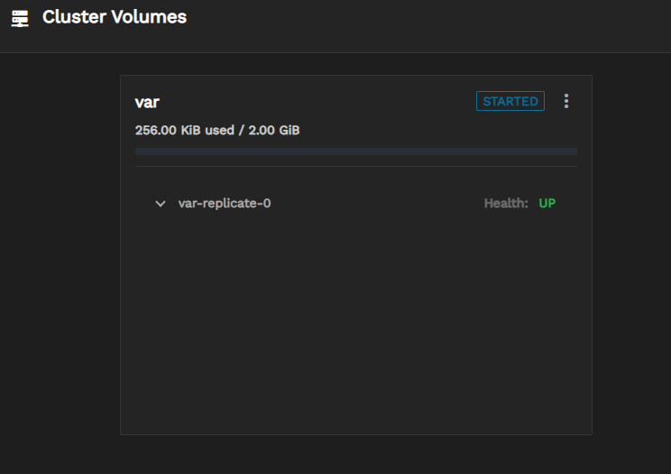

fednikx
Newbie
Jun 30, 2021
I'm testing the TrueNAS Scale. So far I created three nodes over VMs and provisioned successfully a Cluster/Gluster volume with TrueCommand.
My question now is: how can I use it? I can't see a way to provide it via iSCSI or NFS, either from TrueCommand or the nodes' GUI.
I haven't found anything on the documentation as well. What am I missing?
