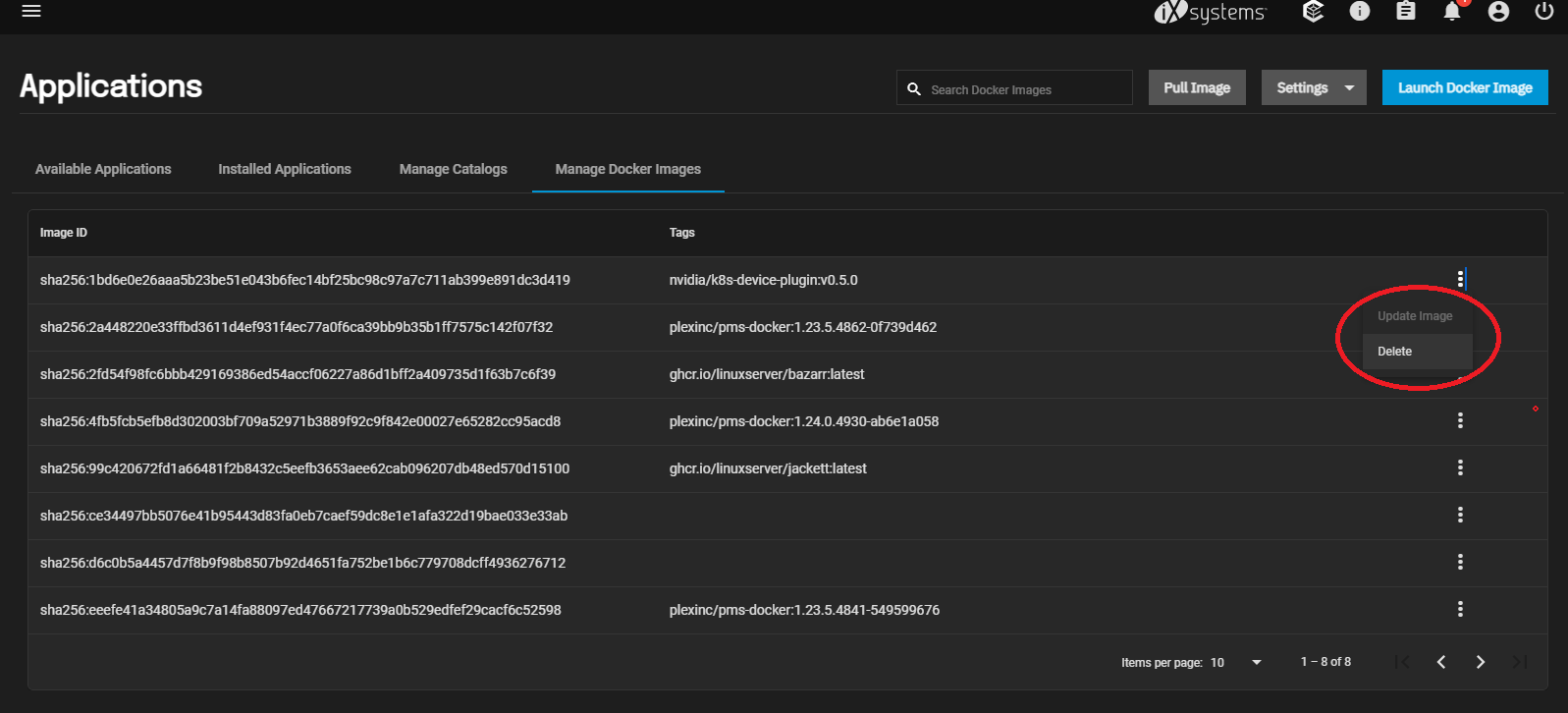

We'll need a way to apply mass operations in some screens. That's the one of them:
DELETE one by one is out of my plans...
THANKS for new beta!
THanks... could you make a suggestion via report a bug. Please identify the specific screens that impact you and you might have the same issue again.
