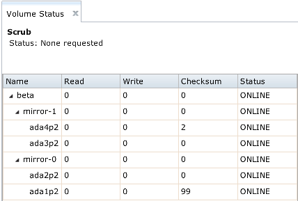

Here is the output of "zpool status":
[root@beta-nas] ~# zpool status -x
  pool: beta
state: ONLINE
status: One or more devices has experienced an unrecoverable error.  An
    attempt was made to correct the error.  Applications are unaffected.
  see: http://illumos.org/msg/ZFS-8000-9P
  scan: scrub repaired 0 in 3h42m with 0 errors on Sun Dec  8 03:42:38 2013
config:
    NAME                                            STATE    READ WRITE CKSUM
    beta                                            ONLINE      0    0    0
      mirror-0                                      ONLINE      0    0    0
        gptid/962c6551-2451-11e3-823b-001d7d06876f  ONLINE      0    0  304
        gptid/967895ce-2451-11e3-823b-001d7d06876f  ONLINE      0    0    0
      mirror-1                                      ONLINE      0    0    0
        gptid/96c60e24-2451-11e3-823b-001d7d06876f  ONLINE      0    0    0
        gptid/97127c36-2451-11e3-823b-001d7d06876f  ONLINE      0    0  294
errors: No known data errors

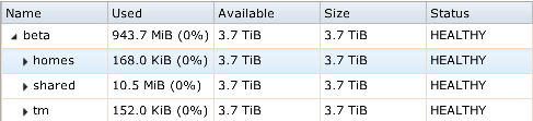

Here's Storage → Volumes → View Volumes:
And here's Storage → Volumes → View Disks:

ada1 I'd definitely not use. Something is wrong if a drive is providing trash characters like yours.
ada2 through 4 looks good. ada4 probably has a bad SATA cable(identified by UDMA CRC errors) and I'd replace it at your next convenience.
I'd do a SMART short and long test on all of the disks. Here's how...
smartctl -t short /dev/adaX
(wait 5 minutes before doing next test on the same drive again)
smartctl -t long /dev/adaX
(wait about 459 minutes before checking results)
Don't powerdown, reboot, or do a pool scrub during these tests. You can use the server as you normally do, just try not to put alot of load on the server because it'll slow down the test.
Then do smartctl -a /dev/adaX on the drives and look at the SMART test log results portion of the output. If they say pass then your drives are in perfect shape.

I left the machine off for a night and am still getting bad readings from ada1. I have an equal size [3.0 TB] spare ready to go, but I'm having trouble following the wiki:
http://doc.freenas.org/index.php/Volumes#Replacing_a_Failed_Drive
When I check Volume Status in the web GUI, all rows under the Status column say ONLINE. Does this have anything to do with being "AHCI capable"?
Sorry for the ignorance but, How do I go about replacing ada1?

I just received this message on the monitor connected to the FreeNAS box:
Jan 13 18:21:37 beta-nas smartd[2793]: Device: /dev/ada1, FAILED SMART self-check. BACK UP NOW!
In the Web GUI, I still see no UNHEALTHY, DEGRADED, or OFFLINE messages, and no drives/devices are missing from the GUI.
Is it possible to use the command-line instead of the Web GUI to replace ada1?

Ffffk, just found that clicking to highlight "ada1p2" shows the "Offline" button under the Volume Status screen. That was not intuitive at all! >:]
cyberjock
Inactive Account
Mar 25, 2012
19,526
No, but the manual is very intuitive! It guides you step by step! Check it out.. 6.3.12.
Yes, I know it by heart because so many people don't want to be inconvenienced with reading the manual!

After resilvering finished, I checked the status of zpool:
  pool: beta
state: ONLINE
  scan: resilvered 818G in 3h23m with 0 errors on Mon Jan 13 23:32:39 2014
config:
    beta                                            ONLINE      0    0    0
        gptid/dd44cd8f-7cc0-11e3-ab3a-001d7d06876f  ONLINE      0    0    0
        gptid/97127c36-2451-11e3-823b-001d7d06876f  ONLINE      0    0    83
There were 83 CKSUM (errors?).
I then restarted from the Web GUI. The machine failed to get past the BIOS screen. It showed it had detected Master 1, Master 2, Slave 1, but not Slave 2 (the one that just resilvered). It just sat there blinking. I tried turning the box on and off but more of the same. Then I powered off, disconnected the newly resilvered drive, and it booted successfully. I turned it off again, replaced the SATA cable with a spare, and now it booted.
I think however on this last boot it resilvered a small amount of data (124K), and 3 CKSUM errors happened on "Master 1":
  pool: beta
state: ONLINE
  scan: resilvered 124K in 0h0m with 0 errors on Tue Jan 14 02:21:13 2014
config:
    beta                                            ONLINE      0    0    0
        gptid/dd44cd8f-7cc0-11e3-ab3a-001d7d06876f  ONLINE      0    0    3
        gptid/97127c36-2451-11e3-823b-001d7d06876f  ONLINE      0    0    0
In the Web GUI there was an orange "Warning" about resilvering. Now the latest alert is "OK: The volume beta (ZFS) status is HEALTHY".
Running smartctl on ada0-4 passes for all drives.
I'm currently setting up my old ReadyNAS to backup all the FreeNAS data, and am not going to power down the FreeNAS until then.
Hopefully that's the last of the hiccups, and I can finally update to the latest FreeNAS OS and run "zpool upgrade".

You "ran smartctl" on all 4 drives. What does that even mean? You checked their parameters? You ran SMART tests?
I'd say you should run short and long tests on all of your disks. You appear to have more serious problems if you have CHKSUM errors.

I did "smartctl" with the "-a" flag, and they returned with:
Anyways. all the data is now backed up to the ReadyNAS after a very long RSYNC.
Now feeling safe, I upgraded the firmware to FreeNAS-9.2.0-RELEASE-x64 (ab098f4).
After that, I finally ran "zpool upgrade". Here's the result of "zpool status":
pool: beta
state: ONLINE
config:
beta                                            ONLINE      0    0    0
Thanks again for help in previous posts.
That doesn't mean what you think it means. It means that of all of the SMART tests you've run none have failed. Well, guess what? If you don't do any SMART tests then none failed.
You should do -a and check out the parameters and raw values to figure out the health of the disk. That, or do a SMART short and long test and THEN look at that value again. Long tests can take 6+ hours but the -a will tell you the estimated time for the test under idle conditions. Even then, it is possible to have a bad condition on your disks that will pass short and long tests. So the -a and parameter review is the best way to determine your drive's health.
And since 124k was resilver recently, tends to prove that something is not quite right. You shouldn't be having to resilver any data on scrubs.
