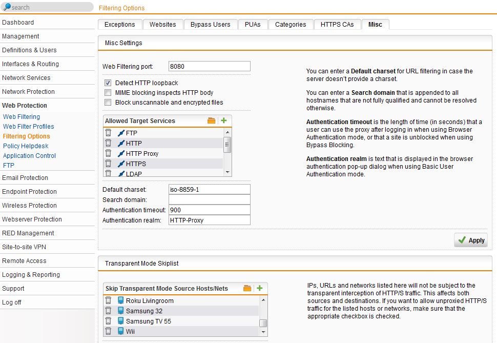

This forum madness is killing me. Web filtering is inhibiting my ability to download anything onto my Xbox One, like new apps/games. It's also inhibiting my ability to download certain software on my workstation. My solution thus far has been to turn it off while it downloads and turn it back on after. I had asked for help on the forum and now it's impossible for anyone to reply!
pirateghost
Unintelligible Geek
Feb 29, 2012
4,219
You can bypass filtering for specific devices.
Look under advanced under web filtering options
As mentioned above, you can apply an exception to specific devices and I do this to all my cellphones, DVD Player, TV, DirecTv, Roku's, etc... If it's not a typical computer then I allow it to bypass the web filtering. When it comes to my computers, I haven't had an issue with downloading software or even playing Netflix. So to add specific devices you need to bypass the filtering to the "Skip Transparent Mode Source Hosts/Nets" section (see attached image).
Also you might want to try just using URL filtering (see below):

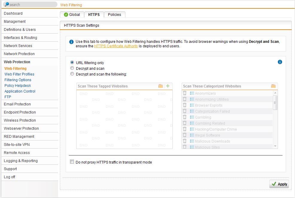

...I haven't had an issue with downloading software or even playing Netflix.
You'll only need to create the web filtering rules for Netflix (and other services) in my previous post if you have HTTPS Scan Settings set to Decrypt and Scan. The reason stems from when the packet is re-encrypted, it's done so using the Sophos Proxy CA which isn't trusted by the services, thereby the services reject those packets, as it appears as a possible MITM attack or that the packet is corrupted.

I actually think that was one of the reasons I changed to scanning the URL only. It's not the best protection but it's so much better than my crappy NAT only firewall.
zoomzoom
Sep 6, 2015
677
I completely understand why one would choose to set it to url scanning only, as I spent days and weeks extremely frustrated trying to get services to work one day, only to have something different not work the next. Most simply don't have the time, let alone the patience, to spend hours trying to troubleshoot why traffic is being blocked, by what policy, and how to allow the service access.
Netflix was a huge headache for me, as while some recommendations worked for one series, it wouldn't for another. I finally cobbled together a url list combined from the master list on the astaro forum, as well as from other threads and was finally able to watch Netflix without issue... but it took over a week and hours of research and fiddling to get to that point.
For any that do choose to set it to decrypt and scan, prior to doing so, ensure you add the suggestions from the master list that's stickied on the astaro forum (now the sophos forum). It definitely requires tweaking prior to enabling, otherwise it's a huge headache.
