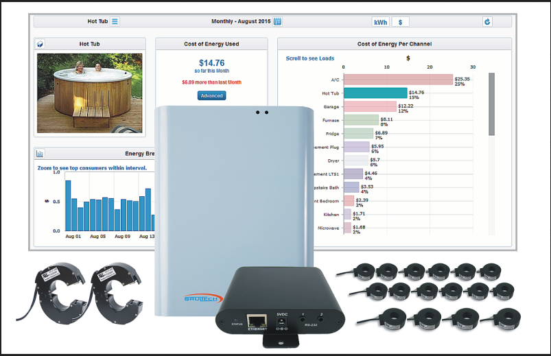

Well ups can monitor the total usage if we are talking about smart UPS here , but it's not really usefully for that.
Other option is when you have a power monitoring system in the premises. Then it will monitor and log each circuit along with the total power with graphs charts, etc. Can show you live draw, it's very cool actually, but it's little bit more complicated to setup.

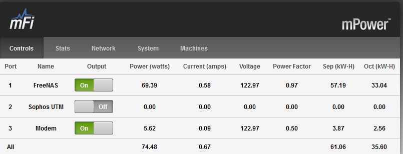

joeschmuck
Old Man
May 28, 2011
10,996
Here is a screen shot of how I track the power usage on my networking system. The only reason I purchased this mFi was because I could remotely turn power on and off to an outlet, the measurements are a bonus. I haven;t changed the labels yet but the FreeNAS is actually my ESXi server which runs FreeNAS and Sophos (2 instances) and Ubuntu, etc... I have turned off Ubuntu and tried to mitigate any changes to ESXi, meaning running any additional VMs, just to see what the power difference is having Ubuntu off for the entire month. I run BOINC on Ubuntu.
