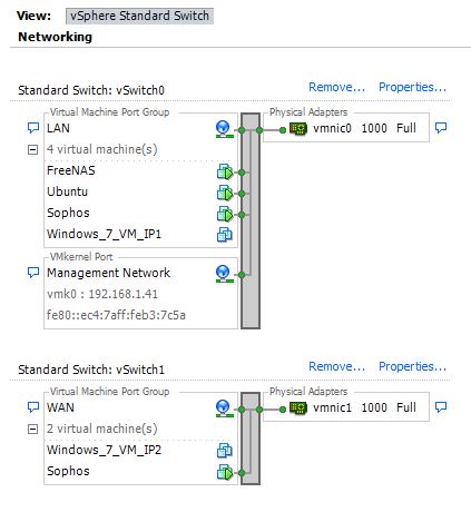

So, thanks for the help because I was able to create a new vSwitch1 using the second i210 port and called it WAN. This port was physically connected to my modem using a single cable. I connected the second WAN vSwitch to Sophos and it got an IP address. I then connected one of my Windoze VM to the WAN as well and it received a second IP. IPchicken confirmed that the IPs were different.
Now all I need to do is create a second Sophos and connect it to the WAN and then I will have two WAN IPs.
I think this will all work out fine once I have some more time to drop my internet from the family. Yes, I need to get them occupied doing something else while I play.
I've attached two screen captures: First is ESXi vSwitch configuration. The second if my modem showing that I can have a max of 2 IPs but I only have 1 assigned during this screen shot.

So I read the info about the NIC. It would be nice to have the ability to use that NIC and make it have two MAC addresses (two WAN IPs) so I can connect a single Cat5 cable between my modem and the server. I don't believe that is possible to have two MAC addresses for the NIC port. I wonder if I used a dual LAN port card, if I could force both MACs across a single LAN connection in ESXi.
Here is just an idea:
Make a Virtual switch in esxi and assign one real NIC adapter to it. This adapter will be physically connected to your modem (one cable only , as you want) Then you can connect both your sophos VM's WAN ports to the virtual switch and your are done.
