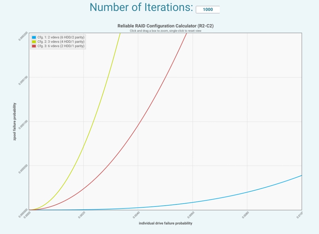

Davvo
Jul 12, 2022
3,222
jstore
Nov 6, 2022
26
Hard to argue with math. I like that visual. In my case with the relicataed system it's 2 seperate - 4 dev:1 Parity RaidZ1 Pools, which is not quite dual parity but is tolerance for two drive failures. I wonder if having it in a seperate machine increases or decreases the odds? (took stats to long ago)
Davvo
Jul 12, 2022
3,222
The curves relative to each other stay the same, the numbers vary.
Assuming the same vdev type and size, having two pools of a single vdevs is safer than a single pool of two vdevs.
