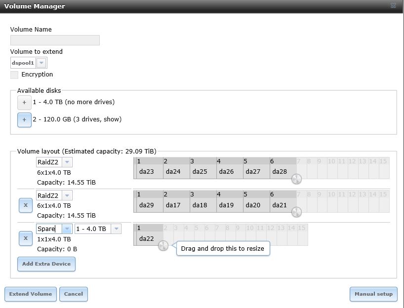

Thanks. With the GUI, I would create just as I've shown in the screenshot, correct?

Bidule0hm
Server Electronics Sorcerer
Aug 5, 2013
3,710
Yes, but just to be sure wait for another answer as I've never extended a volume before.

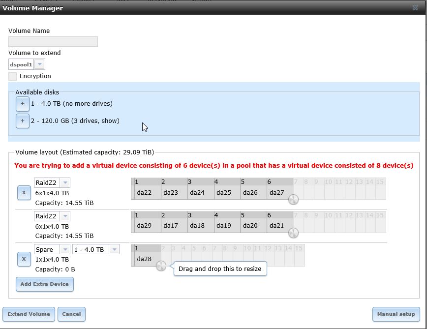

So I attempted to pull the trigger on this and I am receiving the message "You are trying to add a virtual device consisting of 6 devices in a pool that has a virtual device consisted of 8 devices." See screenshot. It won't let me create the new Vdevs to expand the pool. Do I need to add each new Vdev 1 at a time?

15,504
Looks like one of FreeNAS's "seatbelt" features to make it harder for you to mess up your pool. The "Manual setup" button should still let you do this.
Bingo. Manual always works, right? :) Created each new vdev separately, and then another spare drive and all is well now. Thanks for all the help!
