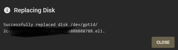

Just for a bit more courage, I had two IPA's and replaced the disk. I *think* all went well. See attachment. I was expecting a bit more verbosity via syslog, because the system was not telling me a change in the pool. It kept DEGRADED. After a while I saw Storage, Pools, Status with a percentage of the re-silvering process. Happy to see that!
And now it's healthy again? :)
Not yet, I think the resilvering proces was about 8 hours. Not sure exactly, as I was sleeping. There was no message in syslog about the status. Now the pool status is:
RESILVER
Status: SCANNING
So it wil be OK I guess. The whole process in replacing a 4TB disk with another 4TB disk took about 12 hours.
