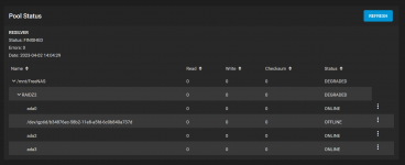

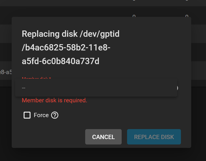

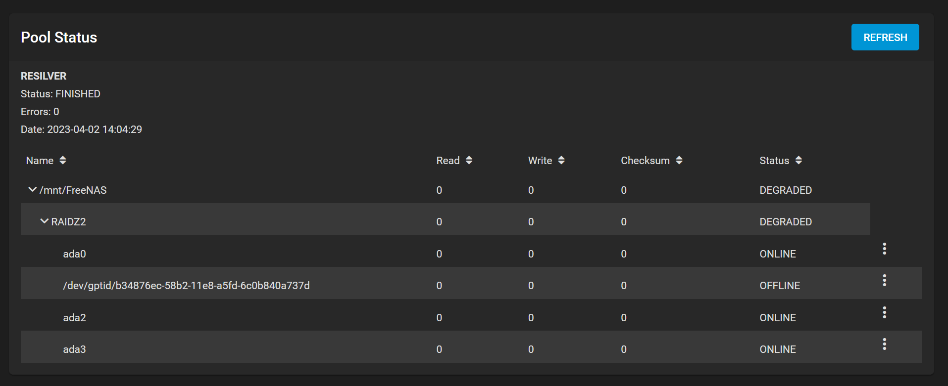

When I start to follow the same process with the second disk, something weird happens. I can offline the disk, but then once I swap hardware, no member disks are available to select in the GUI drop down menu. Two little lines appear where ADA0 was listed before (and I expect to see ADA1 this time). I followed the exact same steps as before, but now get a different result.

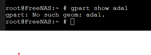

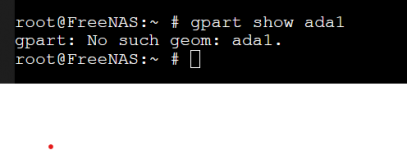

gpart show ada1 doesn't find anything at ada1

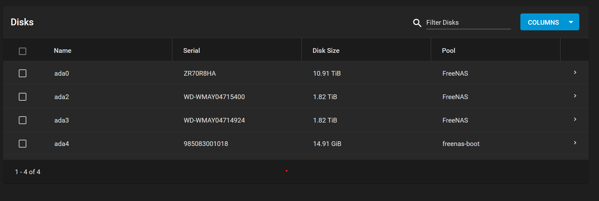

The new disk appears to be listed by gptid in the GUI under Pool Status, but it doesn't show up in the GUI under disks.

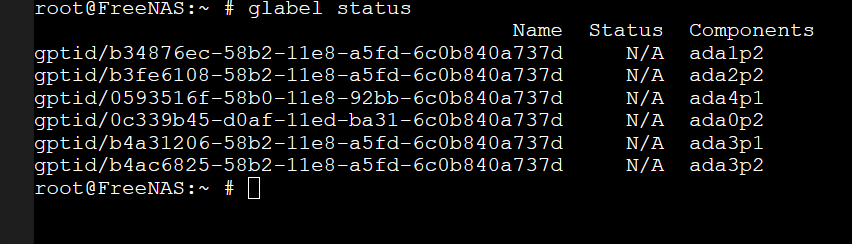

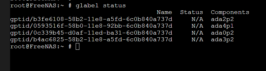

I also tried glabel status both before and after replacing the old disk, results are attached.

Something that I am noticing:
In your first post/picture, it says you are trying to replace a disk with a gptid beginning with b4ac6825.
But that disk is ada3 and is online.
The offline disk (ada1) has a gptid beginning with b34876ec.
What the heck is up with that?

Apr 2, 2023
8
I've tried the offline/replace procedure on several different disks, all with the same result (no member disk option to choose in the GUI). That first screenshot was from an attempt with a different disk. Sorry for the confusion.
