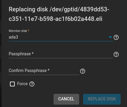

I have an old GELI encrypted pool. One of the disk failed. I got a new disk and I followed the instruction from [1]. However, the replacement procedure asks for a passphrase which I don't have; I only have a key file without a passphrase.
How does one replace a GELI encrypted disk in TrueNAS Core 13? The only thing mentioned in the current disk replacement documentation about GELI is
Can I replace a disk in a GELI-encrypted (Legacy) pool?
Although GELI encryption is deprecated, TrueNAS implements GELI encryption during a “GELI-Encrypted (Legacy) pool” disk replacement. TrueNAS uses GELI encryption for the lifetime of that pool, even after replacement.
which is not helpful.

The documentation for TrueNAS Core 12+ sort of "leaves behind" the nuance of FreeNAS 11.x and earlier; including how to handle replacements of GELI drives in a pool.
From what I recall, it's a dangerous process that can lock you out of your data if you accidentally do a step in the wrong order or misunderstand what's happening. I think it's implying that you're "re-keying" all the drives with a new passphrase that you're using for the replacement drive, which will then allow the (new) GELI device to be resilvered into the pool's existing vdev. And then at a later point, you can "re-key" the pool's drives (again) to use a keyfile, passphrase, and/or recovery key. It is this new key that you can export as a file to save a copy somewhere safe. (The old key will no longer be useable.)

I don't have a GELI-encrypted pool to test this on, but the legacy documentation [1] references a requirement to set a passphrase and back up your encryption keys before performing the replacement operation.
Encrypted pools must have a valid passphrase to replace a failed disk. Set a passphrase and back up the encryption key using the pool Encryption Operations before attempting to replace the failed drive.
I wouldn't consider this as "solid confirmation" because I haven't tried replicating the workflow of a GELI encrypted pool on the current CORE 13 interface at this time.

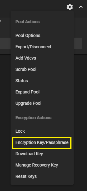

After resetting the keys and setting the passphrase, I was able to get the same prompt dialog and perform a replacement.
Do you have the option highlighted below in the Storage -> Pools -> (Gear) menu for managing the encryption key/passphrase?
If so, this implies that your pool and keys do have a passphrase associated with them.
Yes, I do have this option!
Interesting, I don't recall setting a passphrase, and I don't need one to unlock the pool.

Thanks you, I did not expect this level of commitment! I really appreciate it.
The challenge I'm having now is that while in a degraded state, any attempt to add or change a passphrase fails with an attempt to delete the missing/unavail .ELI file on the detached disk. Legacy GELI encryption with a missing disk seems to be in a very dangerous space, so I'm going to recommend we move very slowly, especially if it's expecting a passphrase that you don't seem to have readily available.
Do you have sufficient free space on another set of (unencrypted) disks that you can copy this data to, either via ZFS replication or at a higher level with a file copy process?
I do not have sufficient free space on another system.
What happens if I try to replace the disk with the wrong passphrase? I could try a couple...

I tried a couple of passwords and it seems I found the right one! The disk is currently resilvering and should be completed in a little more than 5h.
Thank you @winnielinnie and @HoneyBadger for taking the time to help me. It looks like replacing a GELI disk still works in TrueNAS Core 13.
