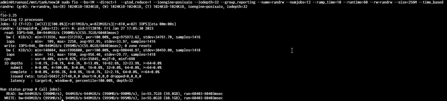

@jgreco @Davvo - jic - here is a screenshot of a fio test as well. I'm not 100% how good/bad or indifferent it looks ;)

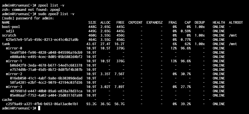

@Davvo @jgreco - should I work on a rebalance? View attachment 62996
Would be beneficial.

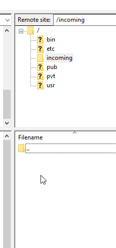

@jgreco - I don't see 3 or 2 out there - screenshot from filezilla
I too didn't manage to get it from filezilla, use the shell and run wget ftp://ftp.sol.net/incoming/solnet-array-test-v3.sh.
