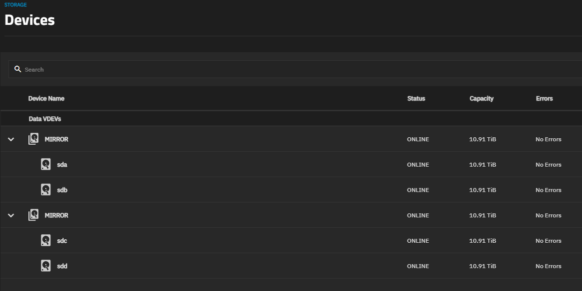

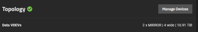

What is your pool layout?
Please read the following resource.
vexter0944
Jan 4, 2023
34
see attached - I'll go read that link as well. Thanks!

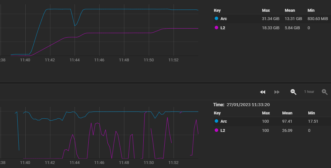

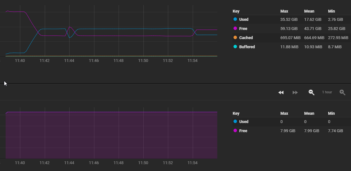

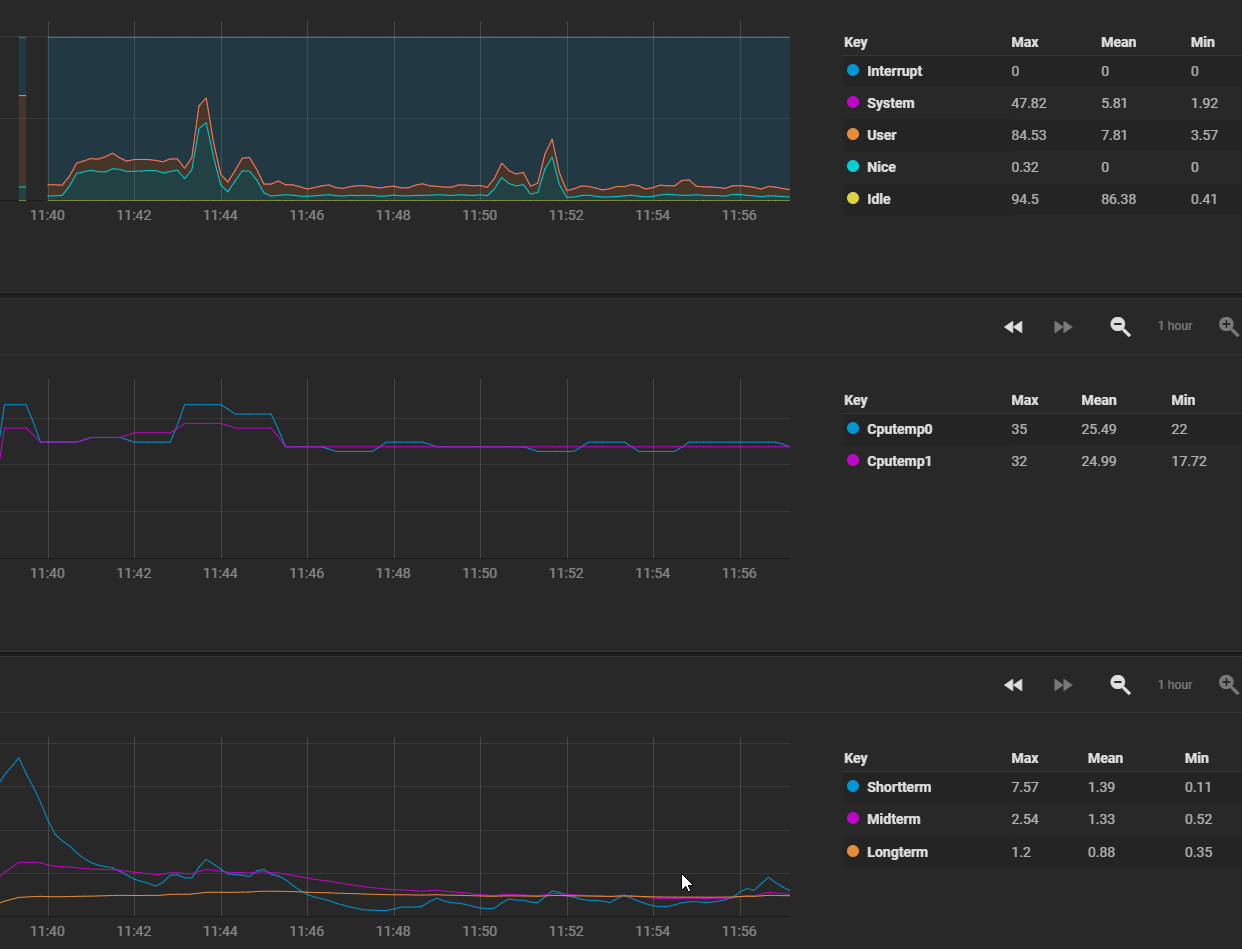

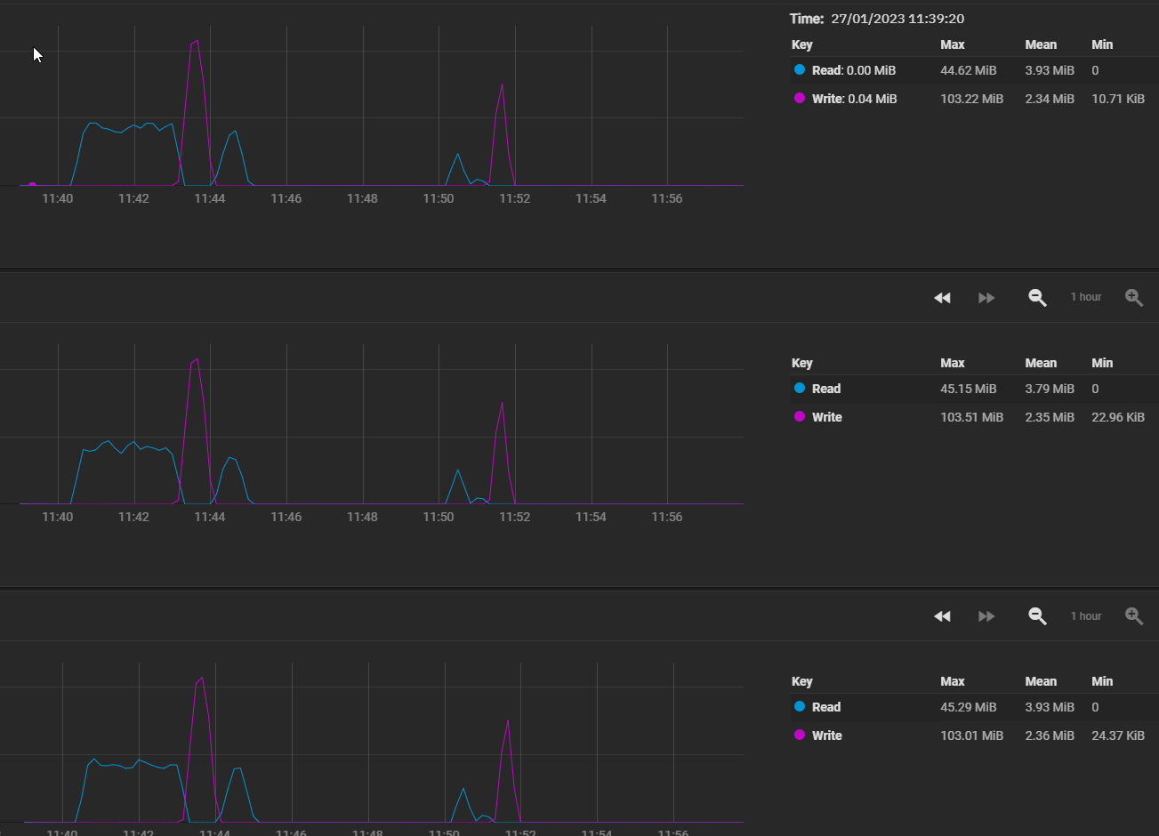

@jgreco @Davvo - wanted to pop back in on this for a minute and see if you guys have any other suggestions/thoughts. I'm thinking some kind of possible performance tuning, but not sure.
I dropped the 64gb in yesterday - little to no change in terms of speed. About 400MBs-500MBs reading from Truenas to Emby server - I can write from Emby server to Truenas at about the same rate. However, I would have thought the read performance would have been higher than the write performance?
I did add a L2Arc cache drive to the media pool this morning - no change really either.
Are there possibly any other performance tuning tips/guides I should be looking at or is this kind of speed (both read and write) pretty much expected with my setup?
Including some metrics jic.
Thanks as always!

How big is this L2ARC drive?
Cache grows with time (and reads).
Can you post the output of arc_summary?
vexter0944
Jan 4, 2023
34
the l2arc is a 100gb SSD

Anonymously used: 0.2 % 10.8k
Cache hits by data type:
Demand data: 27.0 % 1.2M
Demand prefetch data: < 0.1 % 125
Demand metadata: 72.6 % 3.3M
Demand prefetch metadata: 0.3 % 14.9k
Cache misses by data type:
Demand data: 17.1 % 20.1k
Demand prefetch data: 73.7 % 86.6k
Demand metadata: 8.0 % 9.4k
Demand prefetch metadata: 1.2 % 1.5k
DMU prefetch efficiency: 557.9k
Hit ratio: 17.9 % 100.1k
Miss ratio: 82.1 % 457.9k
L2ARC status: HEALTHY
Low memory aborts: 0
Free on write: 0
R/W clashes: 0
Bad checksums: 0
I/O errors: 0
L2ARC size (adaptive): 18.4 GiB
Compressed: 99.9 % 18.4 GiB
Header size: < 0.1 % 303.8 KiB
MFU allocated size: 95.5 % 17.6 GiB
MRU allocated size: 4.5 % 849.4 MiB
Prefetch allocated size: 0.0 % 0 Bytes
Data (buffer content) allocated size: 100.0 % 18.4 GiB
Metadata (buffer content) allocated size: < 0.1 % 5.2 MiB
L2ARC breakdown: 86.2k
Hit ratio: 0.5 % 407
Miss ratio: 99.5 % 85.8k
Feeds: 3.3k
L2ARC writes:
Writes sent: 100 % 1.3k
L2ARC evicts:
Lock retries: 0
Upon reading: 0
