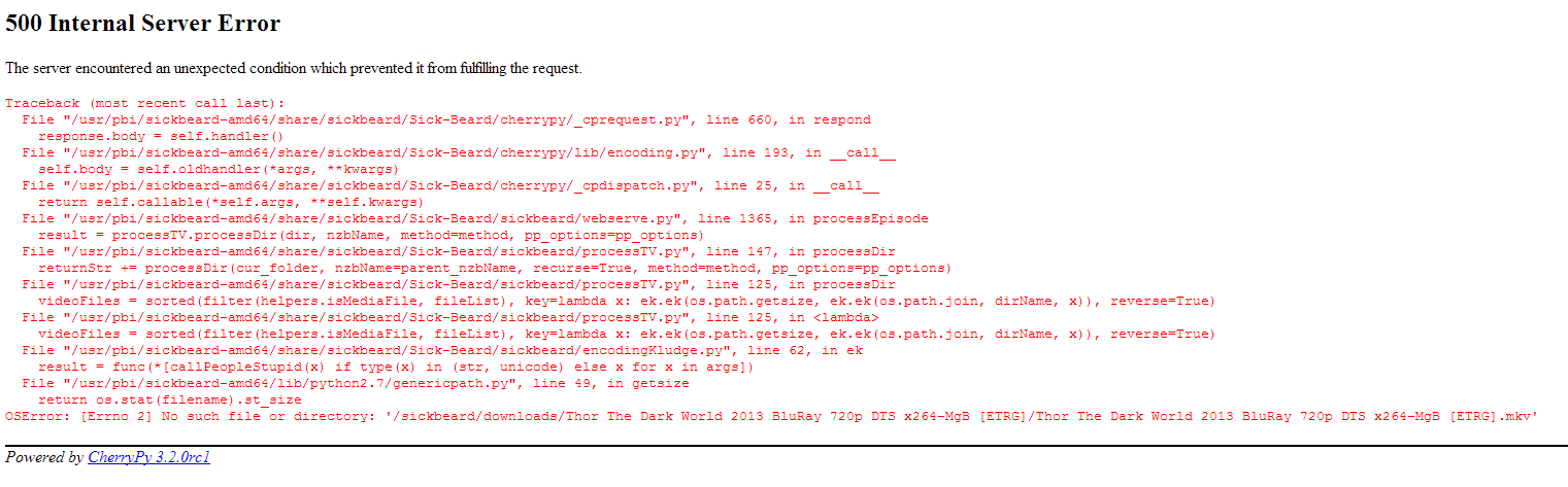

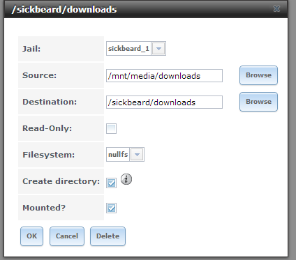

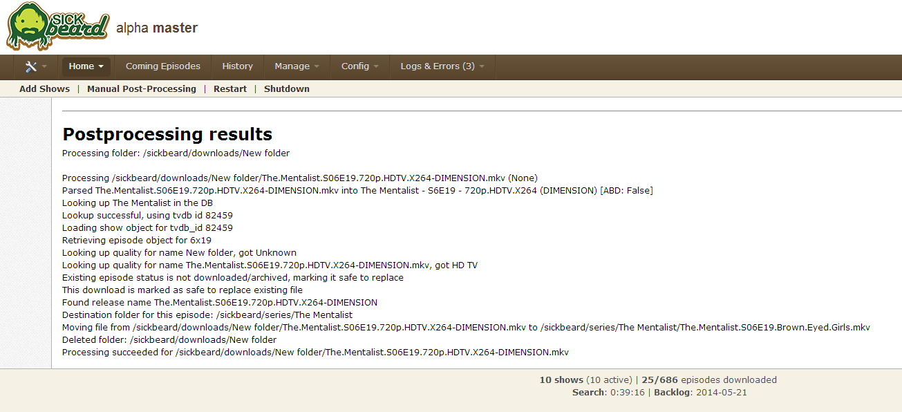

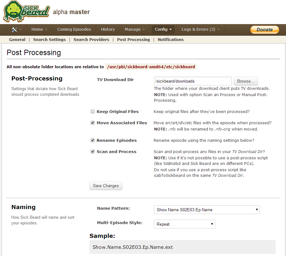

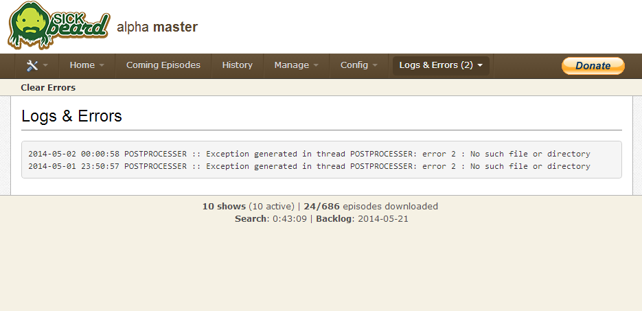

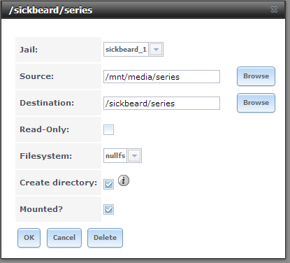

I have a problem with sickbeard its postprocessing is not working
I know about putting the right directory where torrents are downloaded
2014-05-02 00:20:59 ERROR POSTPROCESSER :: Exception generated in thread POSTPROCESSER: error 2 : No such file or directory
2014-05-02 00:20:59 WARNING POSTPROCESSER :: Processing failed for /sickbeard/downloads/Ellie Goulding - Halcyon [Deluxe Edition] [2012] (iTunes+Extra videos+Digital Booklet) [F10]/21 Anything Could Happen.mp4:
2014-05-02 00:20:59 INFO POSTPROCESSER :: Analyzing name u'Ellie Goulding - Halcyon [Deluxe Edition] [2012] (iTunes+Extra videos+Digital Booklet) [F10] 21 Anything Could Happen.mp4'
2014-05-02 00:20:59 INFO POSTPROCESSER :: Analyzing name u'/sickbeard/downloads/Ellie Goulding - Halcyon [Deluxe Edition] [2012] (iTunes+Extra videos+Digital Booklet) [F10]/21 Anything Could Happen.mp4'
2014-05-02 00:20:59 INFO POSTPROCESSER :: Analyzing name u'Ellie Goulding - Halcyon [Deluxe Edition] [2012] (iTunes+Extra videos+Digital Booklet) [F10]'
2014-05-02 00:20:59 INFO POSTPROCESSER :: Analyzing name u'21 Anything Could Happen.mp4'
2014-05-02 00:20:59 INFO POSTPROCESSER :: Analyzing name None
2014-05-02 00:20:59 INFO POSTPROCESSER :: Processing /sickbeard/downloads/Ellie Goulding - Halcyon [Deluxe Edition] [2012] (iTunes+Extra videos+Digital Booklet) [F10]/21 Anything Could Happen.mp4 (None)
2014-05-02 00:20:59 WARNING POSTPROCESSER :: Processing failed for /sickbeard/downloads/Ellie Goulding - Halcyon [Deluxe Edition] [2012] (iTunes+Extra videos+Digital Booklet) [F10]/20 Hanging On.mp4:
2014-05-02 00:20:59 INFO POSTPROCESSER :: Analyzing name u'Ellie Goulding - Halcyon [Deluxe Edition] [2012] (iTunes+Extra videos+Digital Booklet) [F10] 20 Hanging On.mp4'
2014-05-02 00:20:59 INFO POSTPROCESSER :: Analyzing name u'/sickbeard/downloads/Ellie Goulding - Halcyon [Deluxe Edition] [2012] (iTunes+Extra videos+Digital Booklet) [F10]/20 Hanging On.mp4'
2014-05-02 00:20:59 INFO POSTPROCESSER :: Analyzing name u'20 Hanging On.mp4'
2014-05-02 00:20:59 INFO POSTPROCESSER :: Processing /sickbeard/downloads/Ellie Goulding - Halcyon [Deluxe Edition] [2012] (iTunes+Extra videos+Digital Booklet) [F10]/20 Hanging On.mp4 (None)
2014-05-02 00:20:59 WARNING POSTPROCESSER :: Processing failed for /sickbeard/downloads/Ellie Goulding - Halcyon [Deluxe Edition] [2012] (iTunes+Extra videos+Digital Booklet) [F10]/22 Paper Planes & Playground Games.mp4:
2014-05-02 00:20:59 INFO POSTPROCESSER :: Analyzing name u'Ellie Goulding - Halcyon [Deluxe Edition] [2012] (iTunes+Extra videos+Digital Booklet) [F10] 22 Paper Planes & Playground Games.mp4'
This a log of my sickbeard the problem is its only finding general folders not the TV Shows
When i Manual Post Process i get error 500
But when i create a folder in my downloads folder and add any TV show episode it process fine

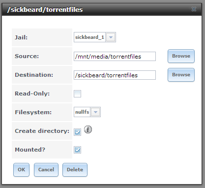

These are my Jail Setup
Any help would be appreciated

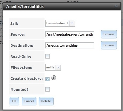

Nice guide! I followed it to the letter but I'm still having some trouble. Maybe you could help me out?
1) I added a TV Show (Hannibal) to my list in Sick Beard and search for all the episodes of season 2. It only snatched one: S02E02. It didn't find any other episode and gave the error "Error loading EZRSS URL: http://re.zoink.it/...". Is this because of the limited support for torrent downloads? Or is it something else?
2) I continued with the one torrent it managed to snatch and looked it up via CIFS. The torrent was correctly placed in jails/sickbeard_1/media/torrentfiles. So I checked if he put it in the dataset. And yes he did! The torrent is also in mediaheaven/torrentfiles. So now Transmission should pull that file into his jail (jails/transmission_1/media/torrentfiles. But there is no torrent-file to be found there. I double checked the added storage of the jail (see pic), it seems about right. Is there maybe a refresh time for Transmission to pull in the torrent files to his jail? Or should I check the option "Mounted?" ?
3) I continued anyway by going to the web client of Transmission and upload the torrent manually. But at 0.50 % it says Error: Permission denied (/media/downloads/Hannibal.S02E02.720p.HDTV.X264-DIMENSION.mkv). I checked as root with SSH (PuTTy) the permissions of the folder media in its jail:
drwxr-xr-x 6 root wheel 6 May 3 13:23 media/
and
drwxr-xr-x 2 root wheel 2 May 3 13:22 downloads/
drwxr-xr-x 2 root wheel 2 May 3 13:23 movies/
drwxr-xr-x 2 root wheel 2 May 3 13:23 series/
drwxr-xr-x 2 root wheel 2 May 3 13:23 torrentfiles/
I also checked the permissions of the datasets and it was still assigned to nobody and nogroup with everything checked (including recursively).
Any ideas on this?
Best regards!

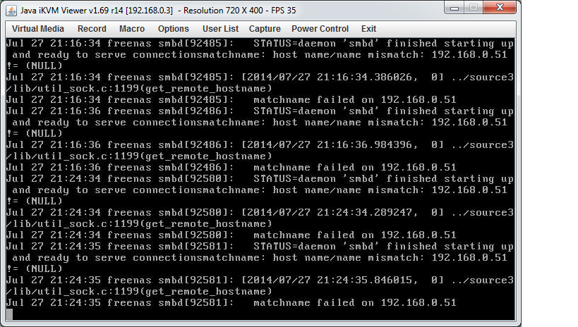

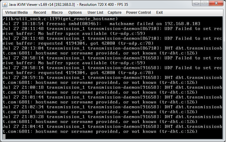

I'm having a problem accessing any of the Plugin WebGUI's in all of my jails. I've gone over everything and even completely reinstalled Freenas and followed guide to word for word but still cant access the GUI.
The Plugins appear to start up just fine but when I look in the server command line interface I get these errors. The first one is when I start up the transmission plugin, the second is my server sitting at idle.

Update: I was having a similar problem as Fragas. For some reason the new directories will not mount when you tick the 'create new directory' box. I initially disregarded it becuase the new directories were in fact created but they werent mounted which is necessary to access the plugin webgui.
Big Thanks to Fragas. I'm all sorted now.
