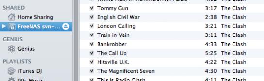

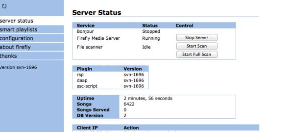

17. Type
service mt-daapd start
and cross your fingers. You should see the service running. I don't use iTunes so I could test to see how it functioned so I would appreciate some feedback.
18. If it all worked, type reboot and see if it still works.

Screen Shot 2012-02-12 at 16.58.34.jpg Screen Shot 2012-02-12 at 16.59.23.jpg
firefly 1696_6 working fine with iTunes 10.5.3
2 points with ref' to both install guides in this thread ..
rc.conf requires firefly_enable="YES" not mt-daapd_enable="YES"
and had to edit /usr/local/etc/rc.d/mt-daapd
pointing it to "/mnt/tank/home/user/mt-daapd.conf" rather than default "/usr/local/etc/mt-daapd.conf"
else on startup I get:
[root@NAS] ~# service mt-daapd start
Starting firefly.
Error reading config file (/usr/local/etc/mt-daapd.conf)
/usr/local/etc/rc.d/mt-daapd: WARNING: failed to start firefly
EDIT -- Obviously also "nano /conf/base/etc/local/rc.d/mt-daapd" to survive reboot!!
Many Thanks
D
G
gcooper
Guest
View attachment 621 View attachment 622
This has been fixed and will be rolled into 8.0.4-BETA2_MULTIMEDIA
That's what my not-so-clear directions were trying to accomplish :).
