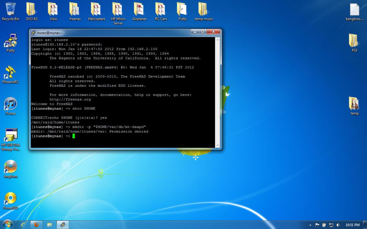

Hi Joe, once again thanks for taking the time to do this guide for me..... as for the double files its my windows media player that's doing it, I have tried it from my PlayStation and all is good no double files so i think its good thanks.... I have ran into a issue on the 1st step and I know you will no how to fix it so here goes....
type 'echo $HOME' and verify the path is correct. If not, go back and fix it.
7. Type (hit RETURN after each line)
mkdir -p "$HOME/var/db/mt-daapd"
when I type this step this is what happens
Welcome to FreeNAS
[itunes@mynas] ~> ehco $HOME
CORRECT>echo $HOME (y|n|e|a)? yes
/mnt/raid/home/itunes
[itunes@mynas] ~> mkdir -p "$HOME/var/db/mt-daapd"
mkdir: /mnt/raid/home/itunes/var: Permission denied
[itunes@mynas] ~>
I cant go any more..

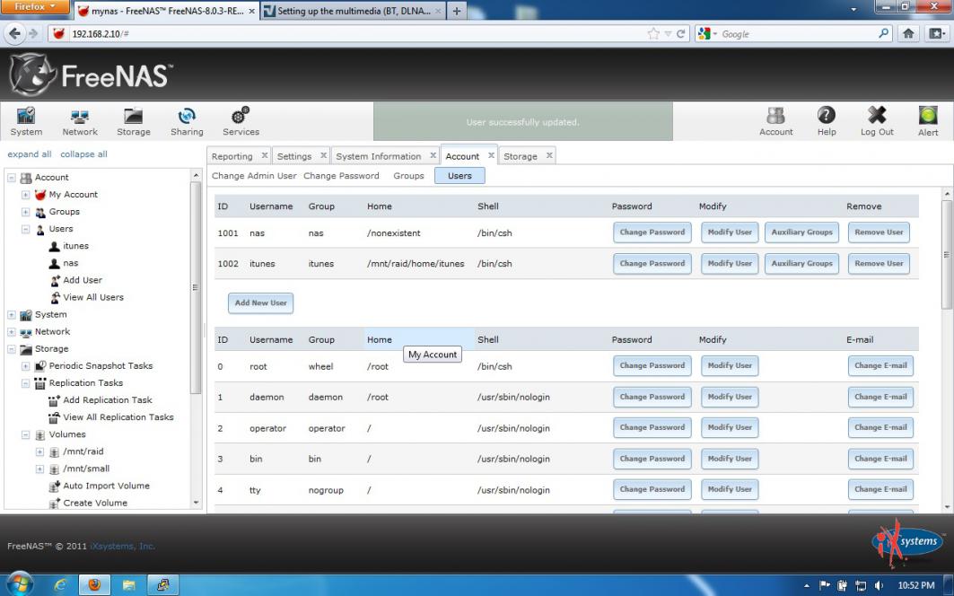

my users look like this
ID Username Group Home Shell Password Modify Remove
1001 nas nas /nonexistent /bin/csh
1002 itunes itunes /mnt/raid/home/itunes /bin/csh

Ok I looked up SU and i guess its used to gain root access.... so because I got permission denied I tried to type SU and the pass, then I type ( mkdir -p "$HOME/var/db/mt-daapd" ) and it didnt give any errors.. SO i continued but then this is what happened
[itunes@mynas] ~> chown daapd "$HOME/var/db/mt-daapd"
chown: daapd: Invalid argument
??? what am I doing wrong
Thanks

@awjs
My iTunes account has wheel permission, maybe that is the difference?

Hi awjs
this step is to set permissions for mt-daapd to your iTunes user. If your user is 'itunes' then command should be.
[itunes@mynas] ~> chown itunes "$HOME/var/db/mt-daapd"
a bit on su:
When you use 'su' you are switching your ssh login to root so $HOME is now referencing the home folder of your root user not iTunes user.
joe has got round this when logged in as root by using:
set HOME="/mnt/pool/home/iTunes"
If you miss this step out then (assuming the volume you are using is 'pool') when as root, the path to iTunes home folder will be
So "$HOME/var/db/mt-daapd" would become "/mnt/pool/home/iTunes/var/db/mt-daapd"
Hope this helps.
