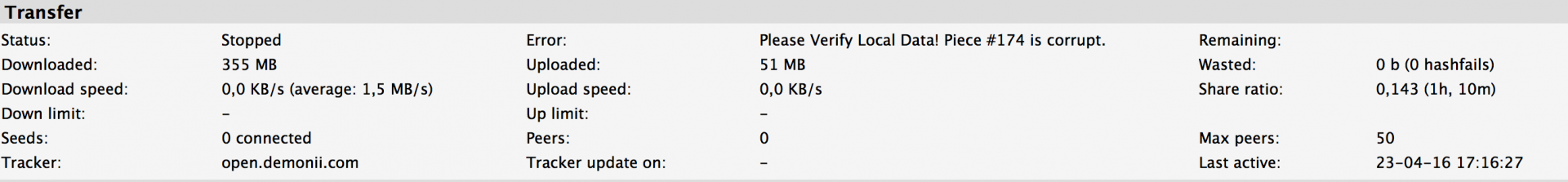

zufallsheld, Hi there!!
I have Q.
while I'm downloading several torrents, some of them stopped at 99,9%, and have an error msg "Pease Verify Local Data! Piece #xxxx is corrupt" (this info is delivered by transgui)
If I open Tansmission, tells me "Error: Please Verify Local Data! Piece #xxxx is corrupt."
Both (couchPotato and sickrage) are working just fine.
Do you know about this issue?
Best regards,
This from transmission:
this one from transgui:
I have Q.
/QUOTE]
Are the movies downloaded and in couchpotato?
