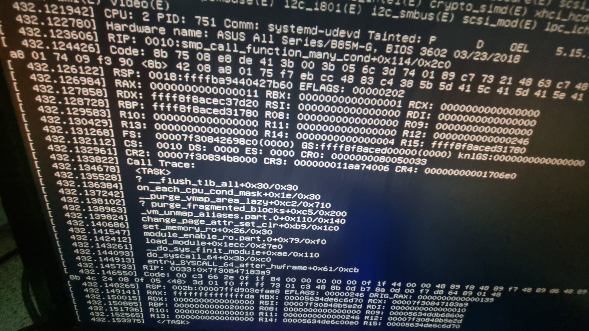

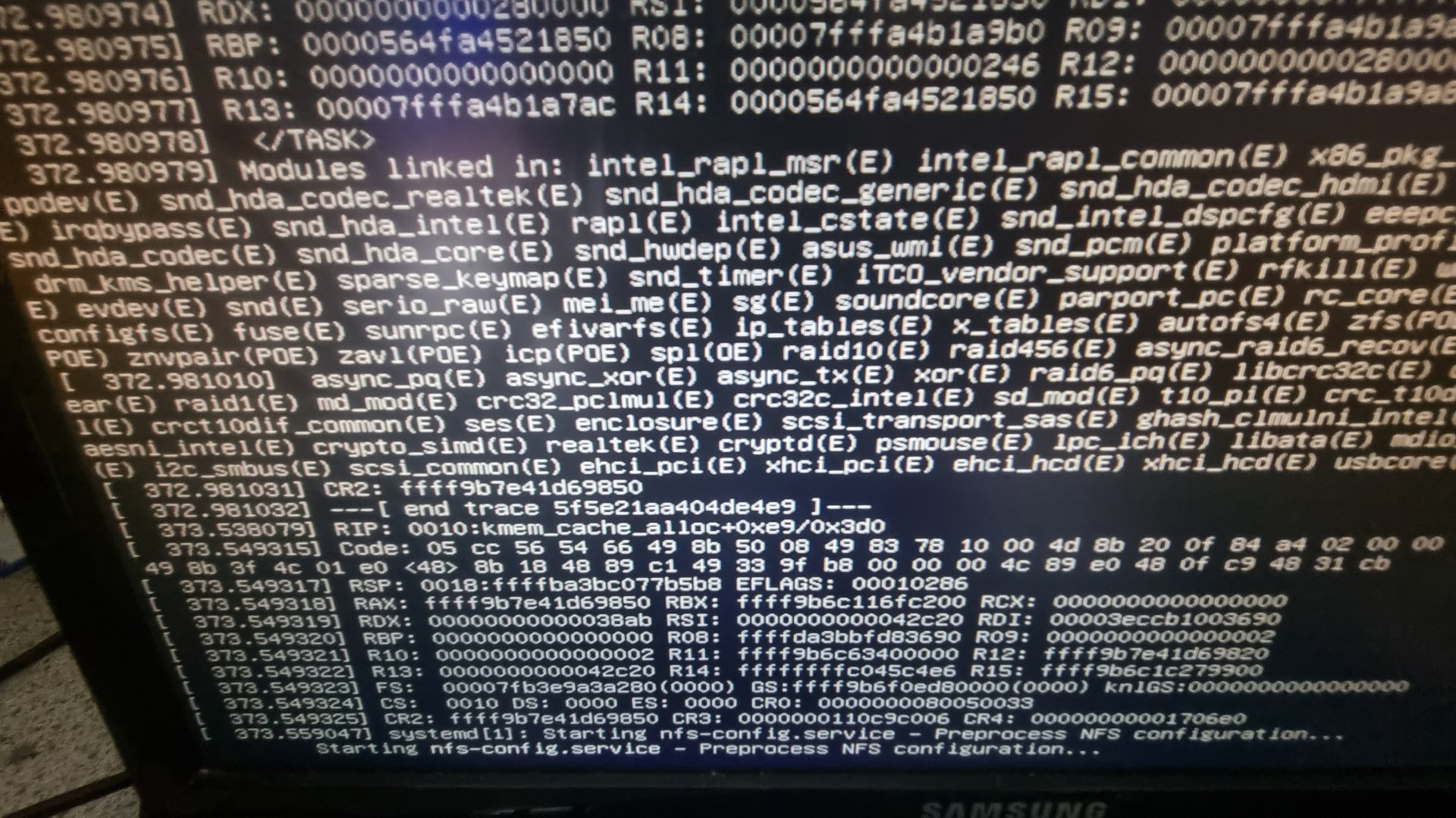

Exact details / screen captures would be useful. When you get a chance, take a picture, whatever you have to do.
Also, one problem that sticks out already is you filled it to 90%, that right there causes large performance issues in general with zfs.

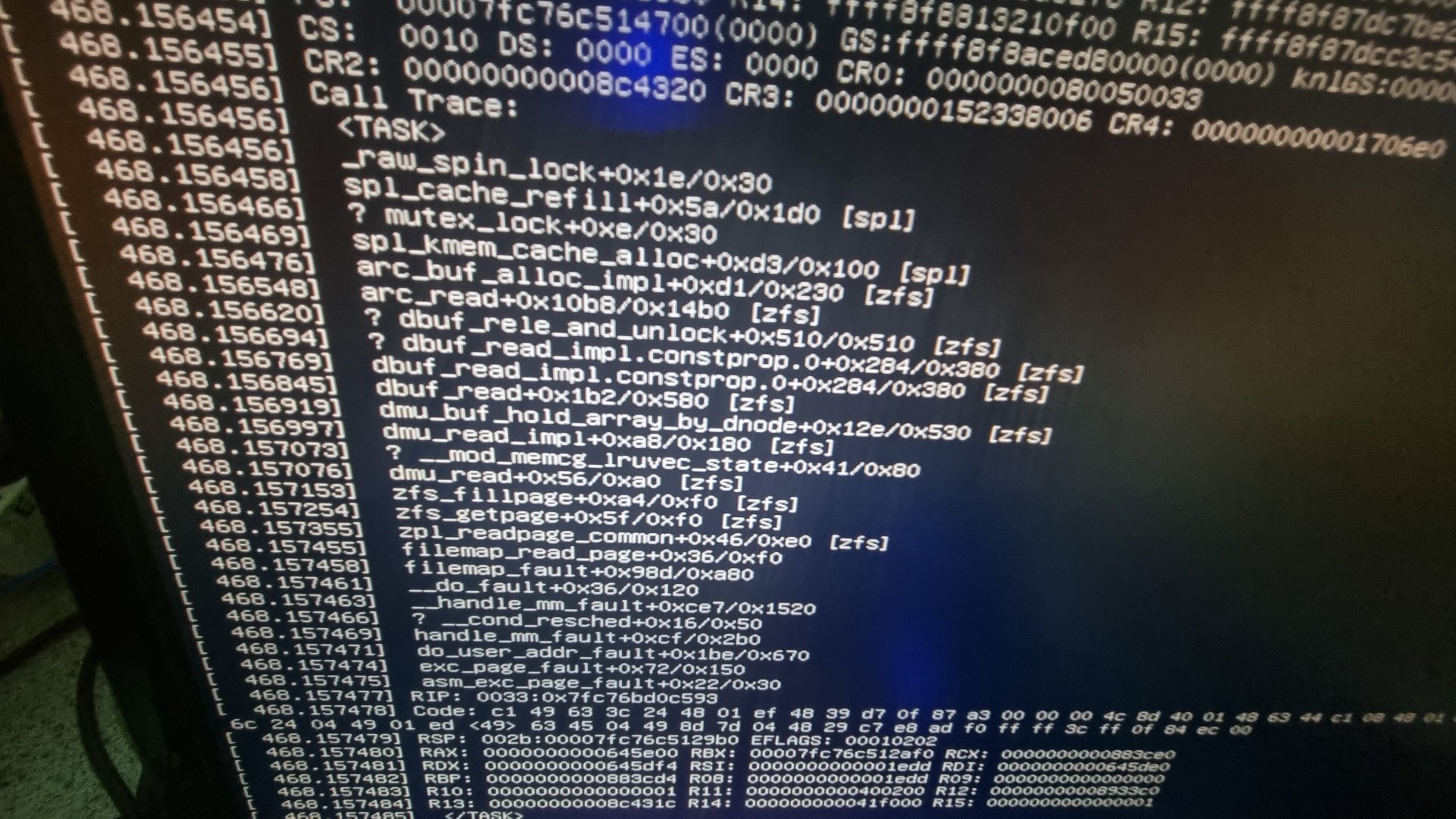

I've attached some photos of the NAS processing at boot up with 3 hard disks connected. The last one which shows "Starting nfs.config service" is after I pressed Ctrl+Alt+Del. The NAS is still running with this message.
I was thinking to shut it off and connect the new hard disk to get some screenshots.
Should I just turn it off via power plug switch or wait until it shows some signal to shut down?

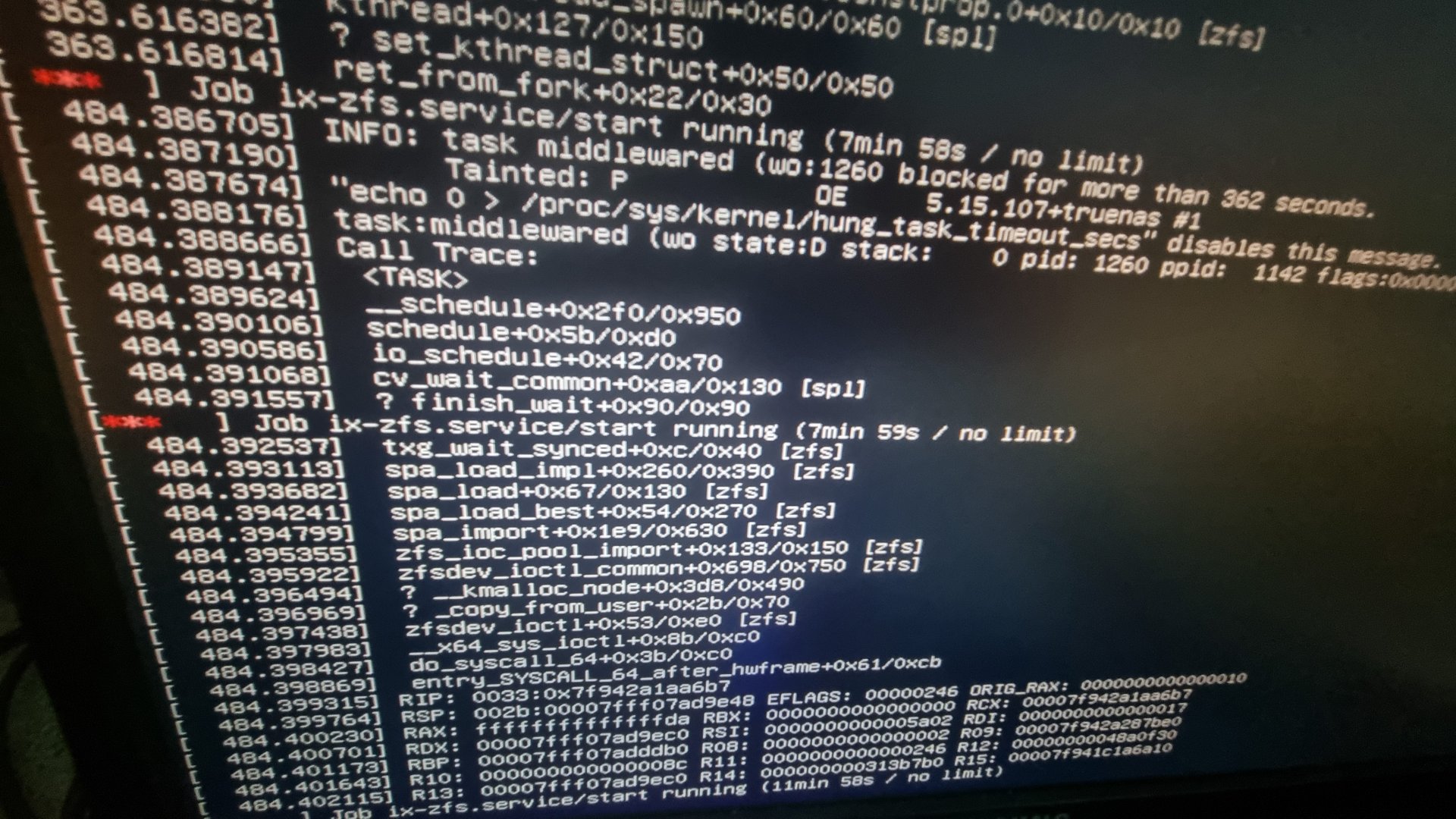

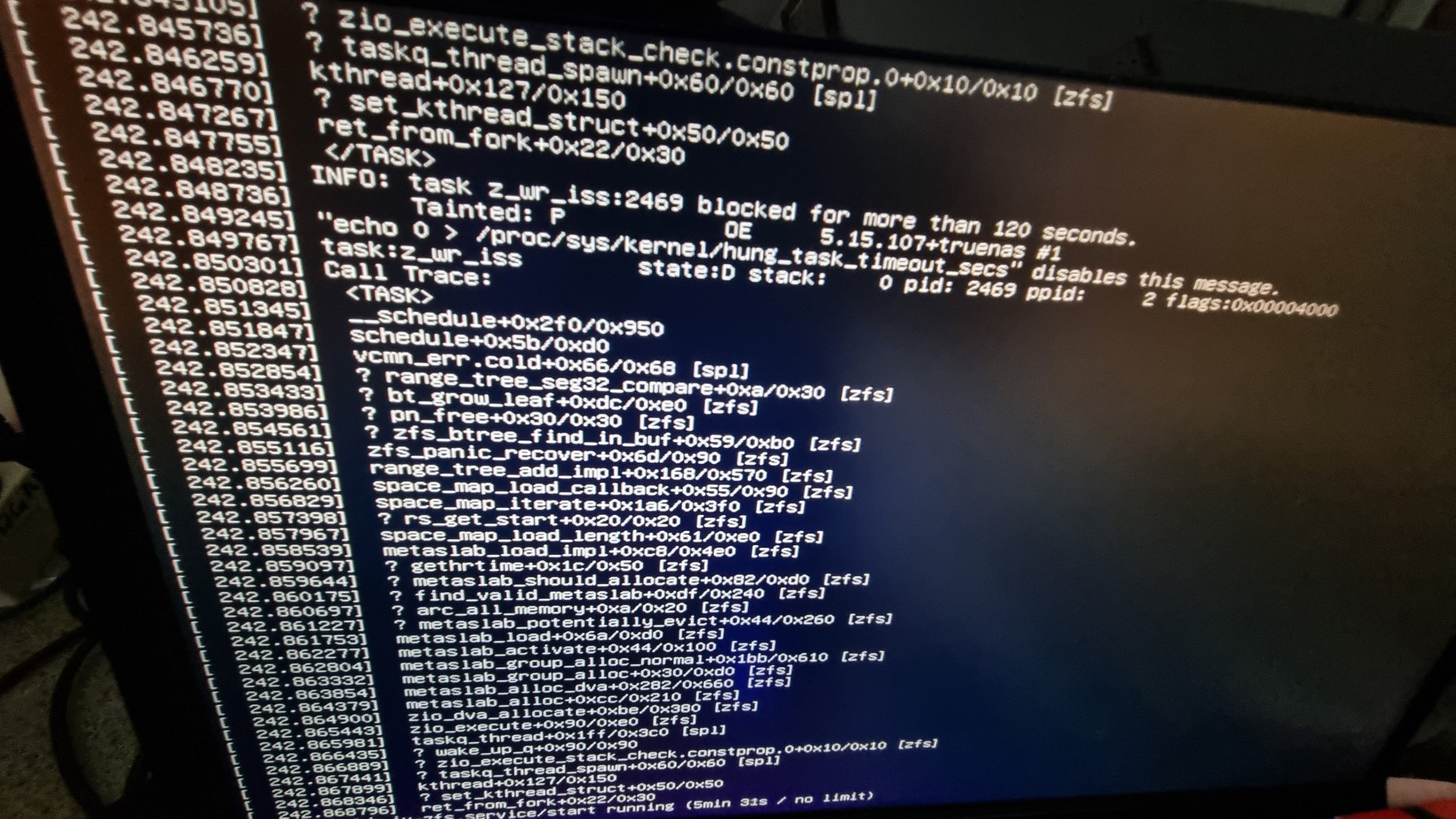

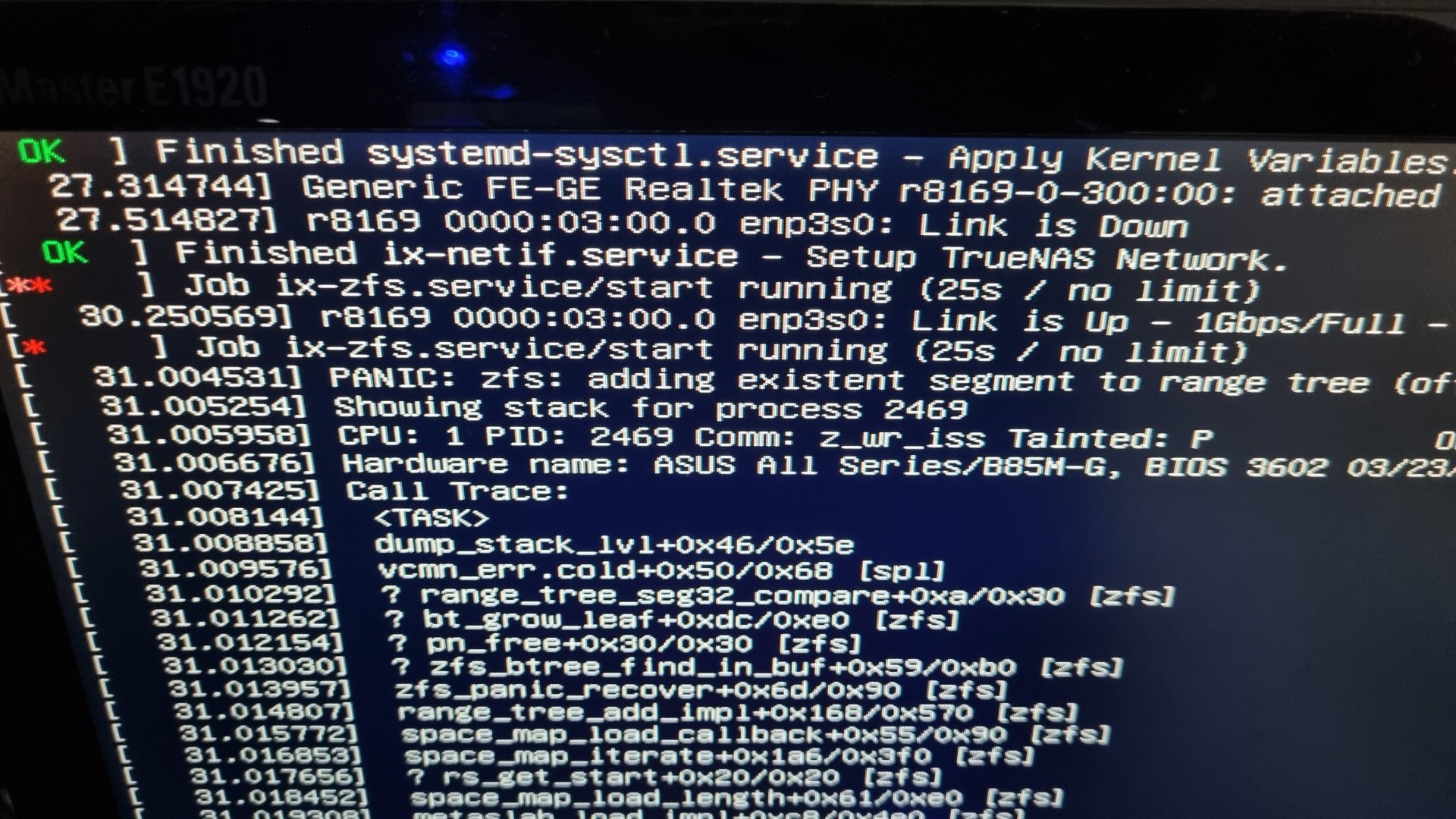

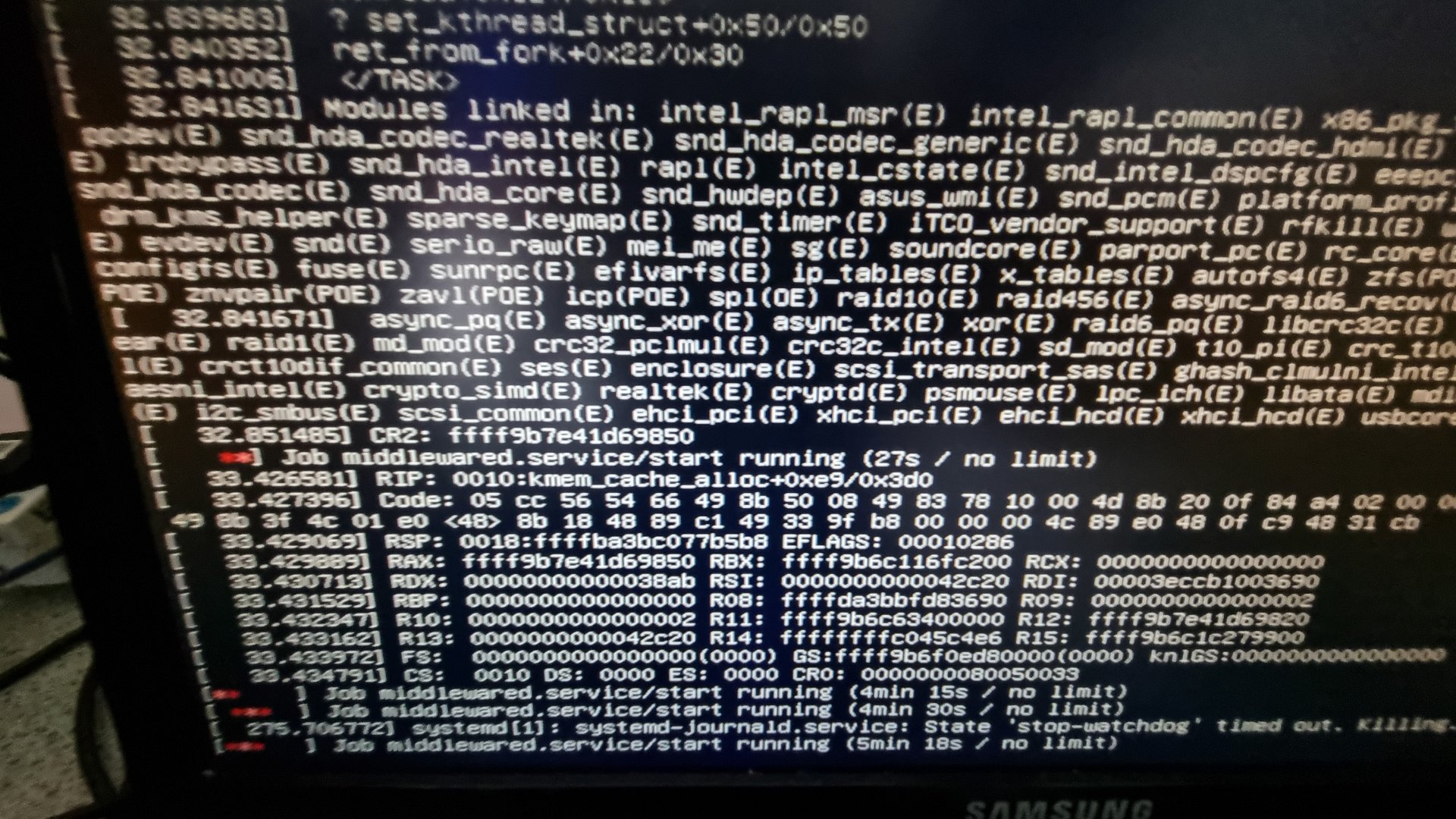

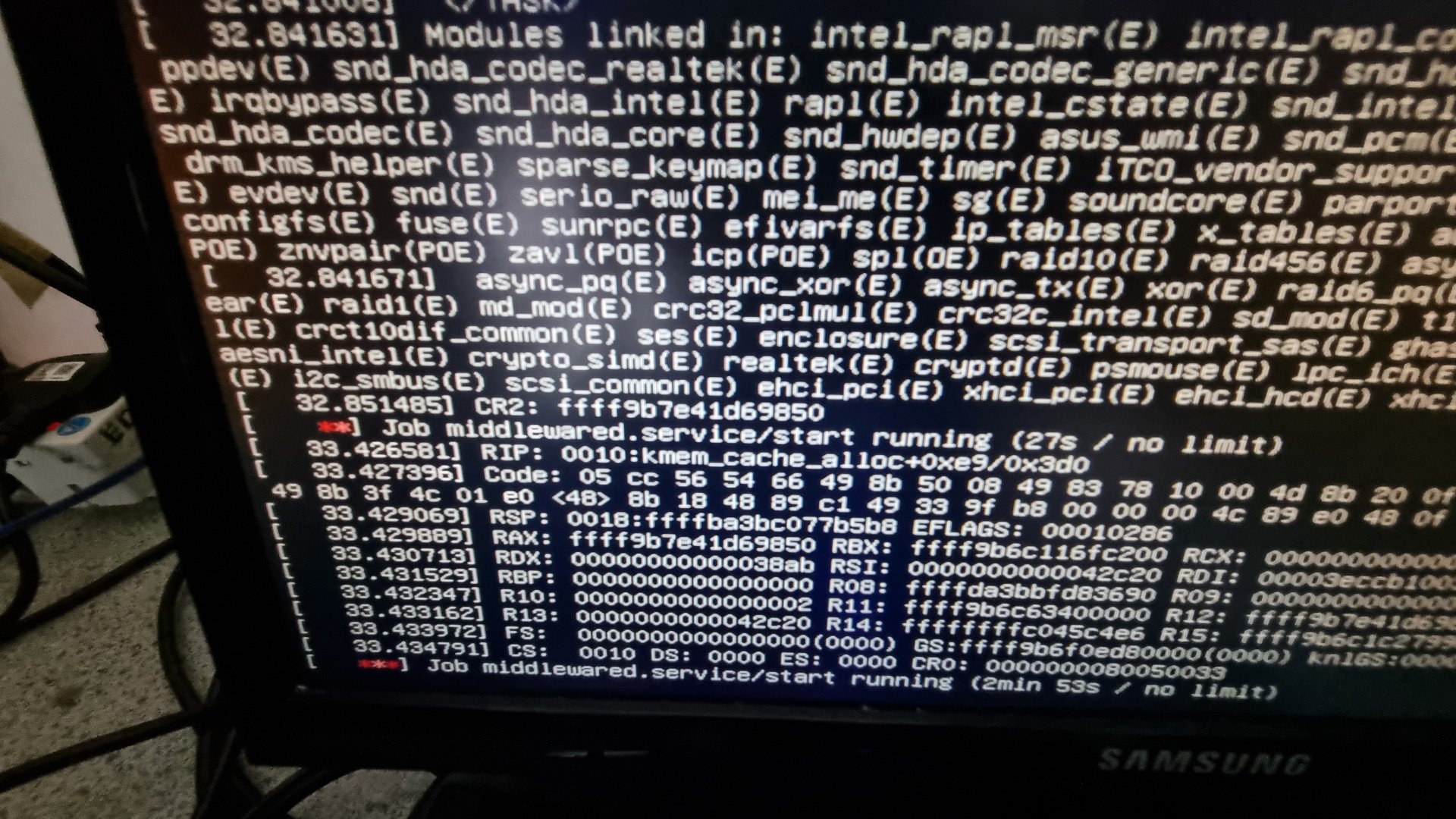

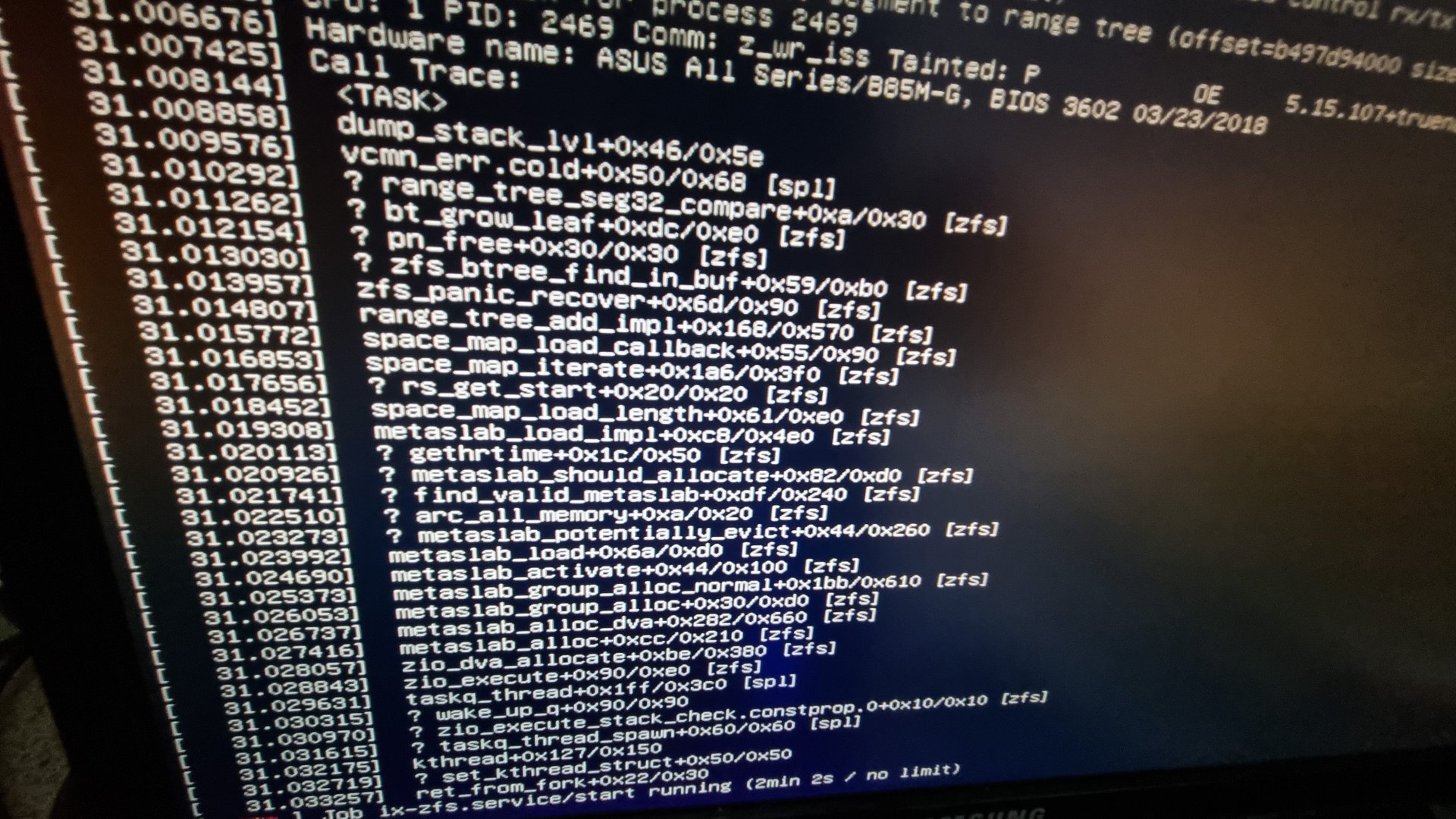

There was a power cut. So I decided to connect the new hard disk and turned the system on.
I have attached screenshots of its current progress. I'm seeing "Job ix-zfs.service/start running" over and over. Is this expected? 20231018_182243.jpg 20231018_182230.jpg

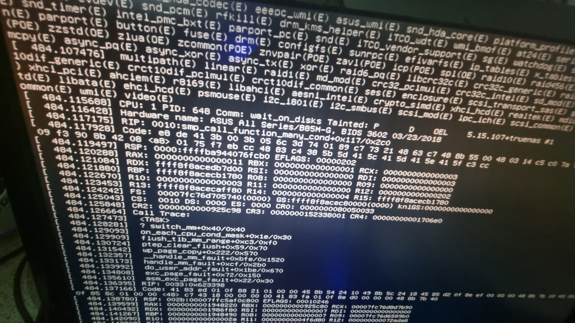

UPDATE 2
TrueNAS eventually booted to main menu. However, my excitement was short lived when the system rebooted itself all of a sudden and it is now stuck in this loop as shown in the newly added screenshots. 20231018_185536.jpg 20231018_185524.jpg 20231018_185437.jpg 20231018_185437.jpg

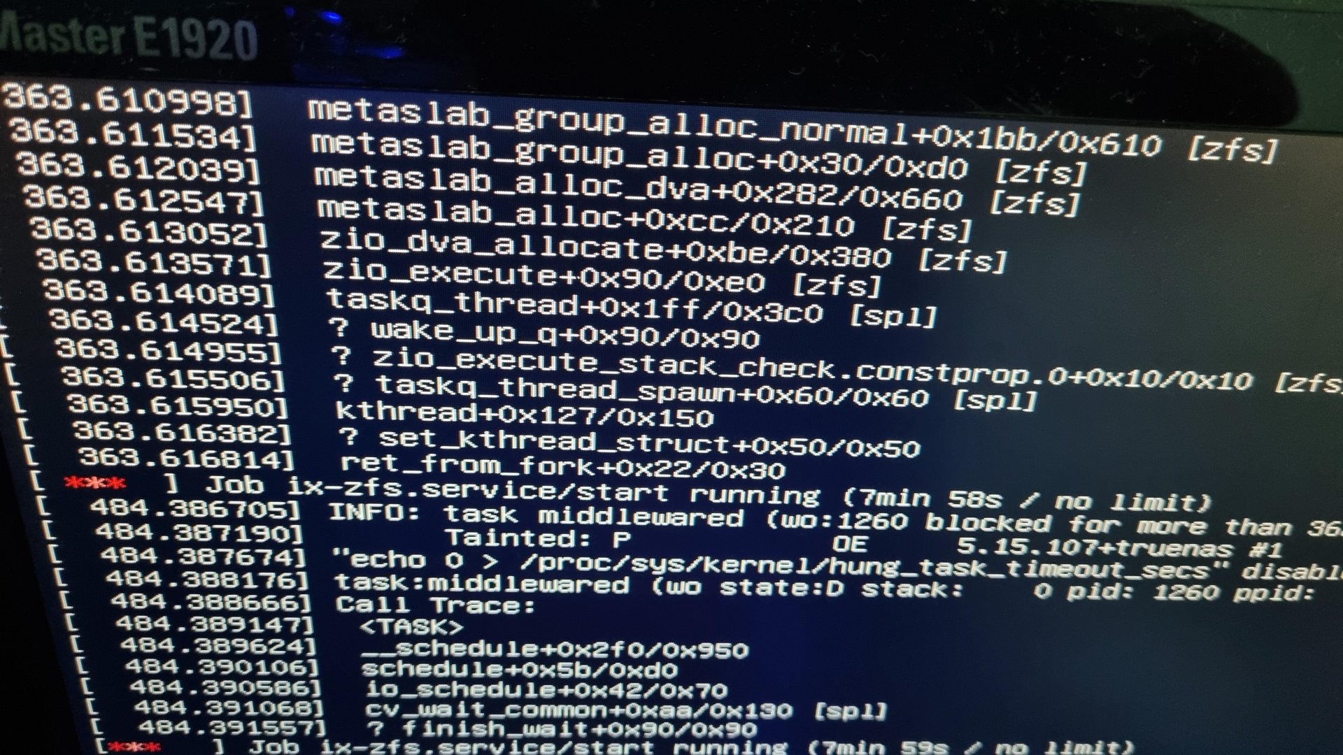

UPDATE 3

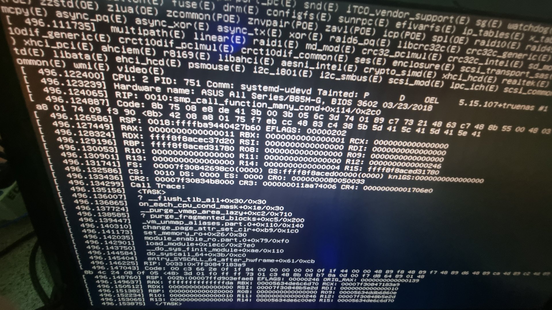

I did a memory test and found that one stick was causing some errors. I removed it and retested successfully with 2 passes.
I left the machine running overnight to boot and discovered that it had booted to the main menu today. I logged in at the Web GUI and it seemed to be processing something as the widgets were taking some time to load. Then, out of the blue the system restarted and it is now loading some things as you can see in attached screenshots.
Should I just reinstall truenas at this point? Looking for some advice on this. Thank you.
No, reinstalling wouldn't do any good. You need to figure out what is causing your stability issues first. A properly functioning system should not be rebooting "out of the blue".
FreeBSD is a very stable OS. I've reached uptime of almost a year. Your hardware is likely the culprit, not TrueNAS.
EDIT: I noticed you're actually running SCALE (Linux). Still, the point stands. You shouldn't be rebooting out of the blue willy-nilly.

If you had bad memory modules, that's not good as it could have well corrupted data on disks, or worse, metadata. I would not use the disks as is in any new system. I would try and copy stuff off if you can get some system to for a backup purpose, but I wouldn't keep them as is if you had that many memory issues.
In general, when putting in a new system (even with used equipment), run tests on the drives (yes, may take days), runs tests on memory, before loading the OS and spending time configuring, etc. Will save you time and effort in the end. It's all waiting anyway, so very little of your time.
