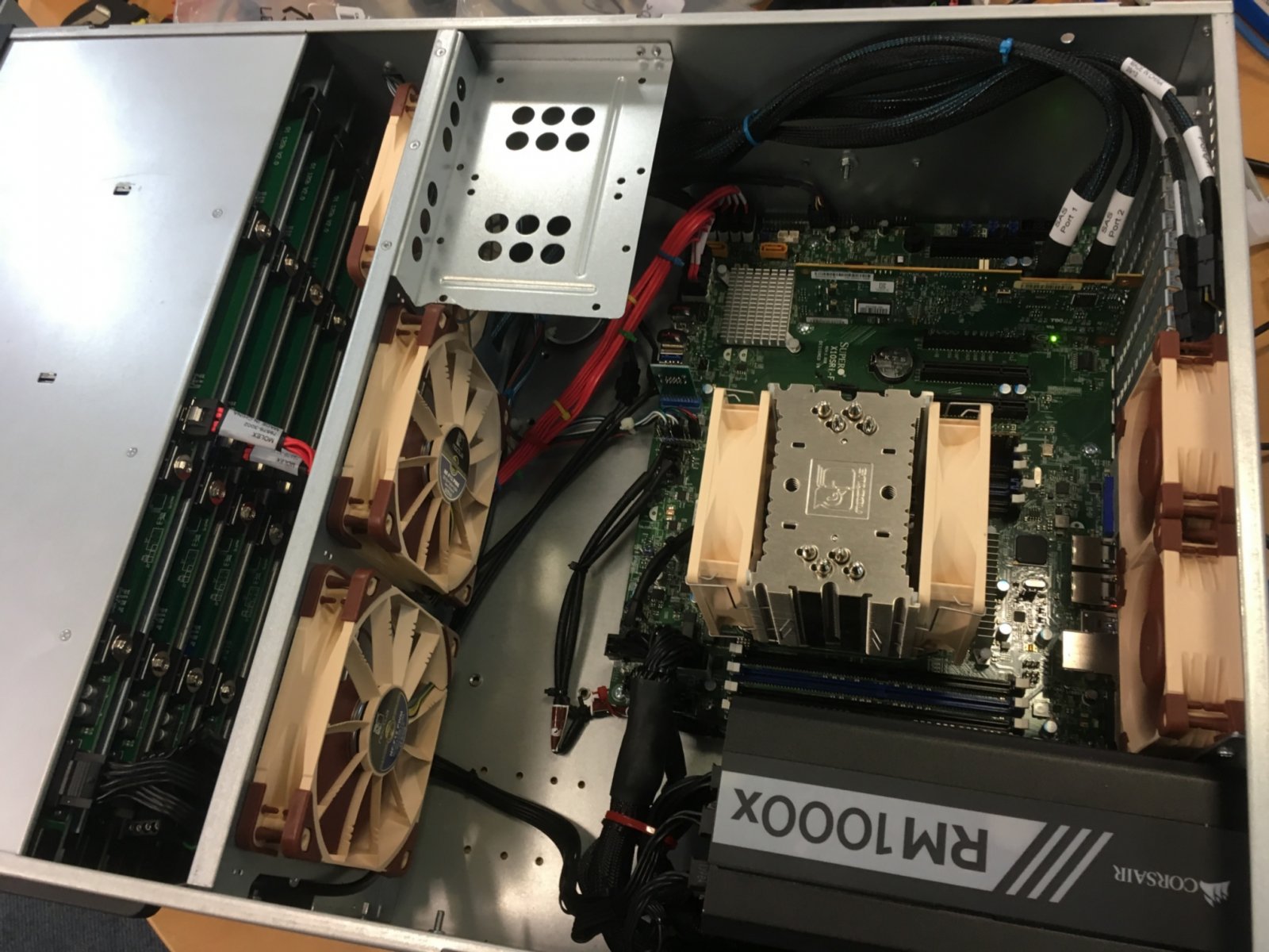

So why did I do this? Because I've built a very powerful FreeNAS box which will be used for VMs and transcoding etc, but is in an office environment, and will otherwise be idle for most of its life. I wanted to minimize fan noise as much as possible, without affecting peak performance or component life-time, and I am pretty happy with the results :)
# To use this correctly, you should connect all your PWM HD fans, by splitters if necessary to the FANA header.
# CPU, case and exhaust fans should then be connected to the numbered (ie CPU based) headers.  This script will then control the

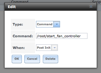

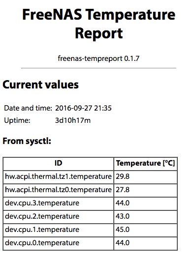

But, when using it for real, as I am now, I made a simple "start_fan_controller" script
#!/bin/bash
echo "Starting Hybrid Fan Controller..."
/root/hybrid_fan_controller.pl &>> /root/fan_control.log &
which I just launched as a post-init command in freeNAS gui.
Maybe this is not the best way to launch this script, but it seems to work for me.

# returns the maximum core temperature from the kernel to determine CPU temperature.
# in my testing I found that the max core temperature was pretty much the same as the IPMI 'CPU Temp'
# value, but its much quicker to read, and doesn't require X10 IPMI. And works when the IPMI is rebooting too.
sub get_cpu_temp_sysctl
    # significantly more efficient to filter to dev.cpu than to just grep the whole lot!
    my $core_temps = `sysctl -a dev.cpu | egrep -E \"dev.cpu\.[0-9]+\.temperature\" | awk '{print \$2}' | sed 's/.\$//'`;
    chomp($core_temps);
    dprint(3,"core_temps:\n$core_temps\n");
    my @core_temps_list = split(" ", $core_temps);
    dprint_list( 4, "core_temps_list", @core_temps_list );
    my $max_core_temp = 0;
    foreach my $core_temp (@core_temps_list)
        if( $core_temp )
            dprint( 2, "core_temp = $core_temp C\n");
            $max_core_temp = $core_temp if $core_temp > $max_core_temp;
    dprint(1, "CPU Temp: $max_core_temp\n");
    $last_cpu_temp = $max_core_temp; #possible that this is 0 if there was a fault reading the core temps
    return $max_core_temp;

I didn’t read the description properly before trying on my X9 system... doh! I thought great this works... as soon as it hit 40 the fans ramped up... and stayed that way. May I ask what actually stops it working on an X9 system? Thanks.
Stux
Jun 2, 2016
4,419
Well, it might work on an x9 system. I don't have one though.
Can you increase the $debug setting and run it again? Hopefully we can see what's going wrong
The BMC is different on X9. Commands may have different effects.
Stux
Jun 2, 2016
4,419
Apparently Kevin's original script does work on X9, so the basics should fundamentally be okay. It could be an issue with parsing output, or it could just be a configuration issue. For example, if something goes wrong, and can not be recovered, it will "bail_with_fans_high" for safety purposes.
If @skyline65 runs the controller in a terminal with the $debug setting cranked up to 4 or so, then tests it, I should be able to diagnose what the issue is from the output.
Of course, if you don't have two addressable fan-zones then there is not much point in using this script.
skyline65
Jul 18, 2014
95
My case is similar but shorter. I have 2 fans in front of the hds instead. Looking at the log it doesnt seem to be picking up the cpu temp and assumes worse case. I have attached log and a few screens.
From the log:
Unable to send RAW command (channel=0x0 netfn=0x30 lun=0x0 cmd=0x70 rsp=0xcc): Invalid data field in request

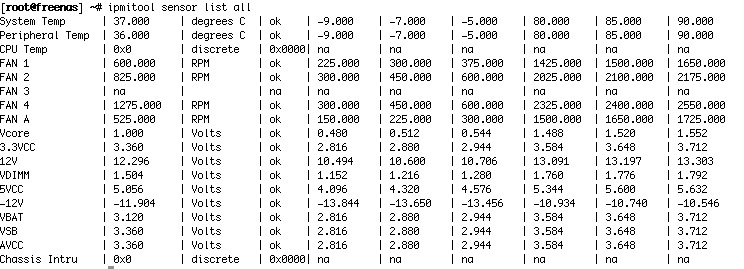

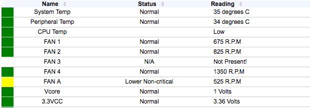

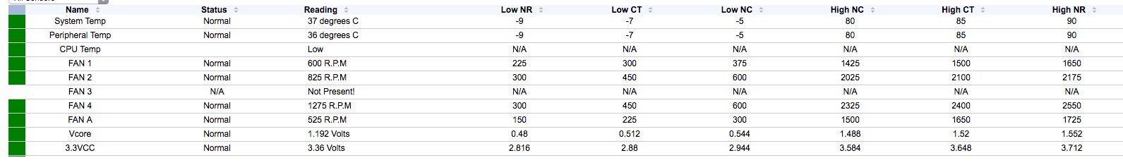

Couple of things, yes, your IPMI CPU Temp says "Low" instead of a reading. Not the end of the world just means reading from somewhere else.
Also, your FANA ipmi thresholds look like they need adjusting.
Can you crank up the debug a bit higher?
I want to see what temp it's reading when it sees a temp of "oh"

I updated the firmware of the IPMI to the latest. Set debug to level 4 and fiddled with the fan thresholds... I wish there was an easy calculator for this... so no doubt mine are way off. Here is the output plus a few screenshots from IPMI and also terminal in OSX.

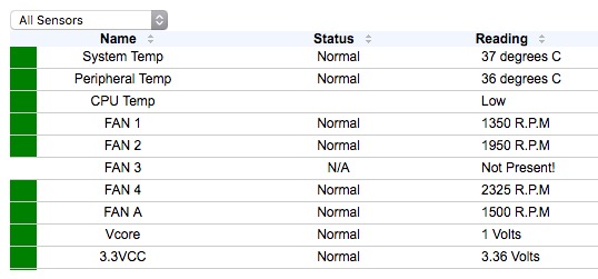

2016-09-28 14:14:17: CPU fan speed should be high, but < 1560.
2016-09-28 14:14:17: HD fan speed should be high, but < 1200.
2016-09-28 14:14:17: bmc_fail_count: 1, bmc_fail_threshold: 1
2016-09-28 14:14:17: Fan speeds are not where they should be, will try again.
2016-09-28 14:14:17: fanmode: full = 1
2016-09-28 14:14:17: Setting fan mode to 1 (full)
2016-09-28 14:14:22: Setting Zone 0 duty cycle to 100%
2016-09-28 14:14:22: Setting Zone 1 duty cycle to 100%
2016-09-28 14:14:23: CPU Temp: 0h
2016-09-28 14:14:23: Unexpected CPU Temp (0h).
2016-09-28 14:14:23: Assuming worst-case and going high.
2016-09-28 14:14:23: CPU Fan: high
2016-09-28 14:14:24: CPU Temp: 0h
2016-09-28 14:14:24: Unexpected CPU Temp (0h).
2016-09-28 14:14:24: Assuming worst-case and going high.
2016-09-28 14:14:24: CPU Fan: high
2016-09-28 14:14:26: CPU Temp: 0h
2016-09-28 14:14:26: Unexpected CPU Temp (0h).
2016-09-28 14:14:26: Assuming worst-case and going high.
2016-09-28 14:14:26: CPU Fan: high
2016-09-28 14:14:27: CPU Temp: 0h
2016-09-28 14:14:27: Unexpected CPU Temp (0h).
2016-09-28 14:14:27: Assuming worst-case and going high.
2016-09-28 14:14:27: CPU Fan: high
2016-09-28 14:14:28: CPU Temp: 0h
2016-09-28 14:14:28: Unexpected CPU Temp (0h).
2016-09-28 14:14:28: Assuming worst-case and going high.
2016-09-28 14:14:28: CPU Fan: high
2016-09-28 14:14:29: CPU Temp: 0h
2016-09-28 14:14:29: Unexpected CPU Temp (0h).
2016-09-28 14:14:29: Assuming worst-case and going high.
2016-09-28 14:14:29: CPU Fan: high
2016-09-28 14:14:30: CPU Temp: 0h
2016-09-28 14:14:30: Unexpected CPU Temp (0h).
2016-09-28 14:14:30: Assuming worst-case and going high.
2016-09-28 14:14:30: CPU Fan: high
2016-09-28 14:14:31: CPU Temp: 0h
2016-09-28 14:14:31: Unexpected CPU Temp (0h).
2016-09-28 14:14:31: Assuming worst-case and going high.
2016-09-28 14:14:31: CPU Fan: high
2016-09-28 14:14:32: CPU Temp: 0h
2016-09-28 14:14:32: Unexpected CPU Temp (0h).
2016-09-28 14:14:32: Assuming worst-case and going high.
2016-09-28 14:14:32: CPU Fan: high
2016-09-28 14:14:33: CPU Temp: 0h
2016-09-28 14:14:33: Unexpected CPU Temp (0h).
2016-09-28 14:14:33: Assuming worst-case and going high.
2016-09-28 14:14:33: CPU Fan: high
2016-09-28 14:14:33: fan_speed =
2016-09-28 14:14:33: CPU Fan speed: RPM
2016-09-28 14:14:34: fan_speed =
2016-09-28 14:14:34: HD Fan speed: RPM
2016-09-28 14:14:34: CPU fan speed should be high, but < 1560.
2016-09-28 14:14:34: HD fan speed should be high, but < 1200.
2016-09-28 14:14:34: bmc_fail_count: 2, bmc_fail_threshold: 1
2016-09-28 14:14:34: Fan speeds are still not where they should be after 2 attempts, will reboot BMC.
2016-09-28 14:14:34: fanmode: full = 1
2016-09-28 14:14:34: Setting fan mode to 1 (full)
2016-09-28 14:14:39: Resetting BMC
2016-09-28 14:14:40: CPU Temp: 0h
2016-09-28 14:14:40: Unexpected CPU Temp (0h).
2016-09-28 14:14:40: Assuming worst-case and going high.
2016-09-28 14:14:40: CPU Fan: high

This is the current function which calculates the temp:
sub get_cpu_temp
    my $cpu_temp = `$ipmitool sensor get \"CPU Temp\" | awk '/Sensor Reading/{print \$4}'`;
    chomp $cpu_temp;
    dprint( 1, "CPU Temp: $cpu_temp\n");
    $last_cpu_temp = $cpu_temp; # note, this hasn't been cleaned.
    return $cpu_temp;
Someone (me?) will need to replace it with an alternative which reads the temp from sysctl
Something like :
sysctl -a |egrep -E "cpu\.[0-9]+\.temp"
In the meantime,
Add :
$cpu_temp = 45;
Just before the dprint line. That will hardcode it so you can test the rest of the script.
I think either an avg or max of the core temps would be sufficient. Not sure, will have to do some playing.
