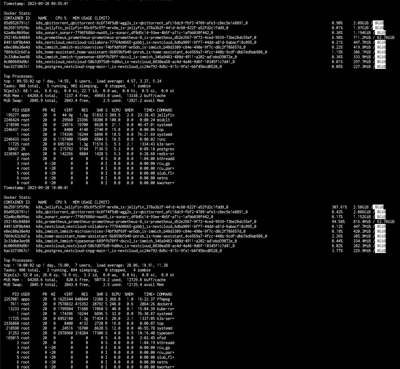

I tried to replicate this using the closest thing I could to the crash that happened yesterday (my kids watching a movie). Although this has happened at other times.
I was monitoring htop and jellyfin was using a lot of resources as I expected, although all cores pinned around 95~100% was not expected.
I let the movie play for 30m, and no crash, very high cpu. I noticed ffmpeg was taking a lot of CPU I think it is transcoding when it should not be, my understanding is that jellyfin will only transcode when necessary. I have explicitly disabled this in jellyfin now.
When I stopped the movie in jellyfin waiting about 5~10m saw all resources drop to reasonable levels (30~60% cpu). After this happened the server crashed.
I am hesitant to say this is the issue every time, but at least in my case this appears to maybe the most common cause. As I said it has happened in the middle of the night when no one is actively streaming media.
attached is some of the script output during this time.

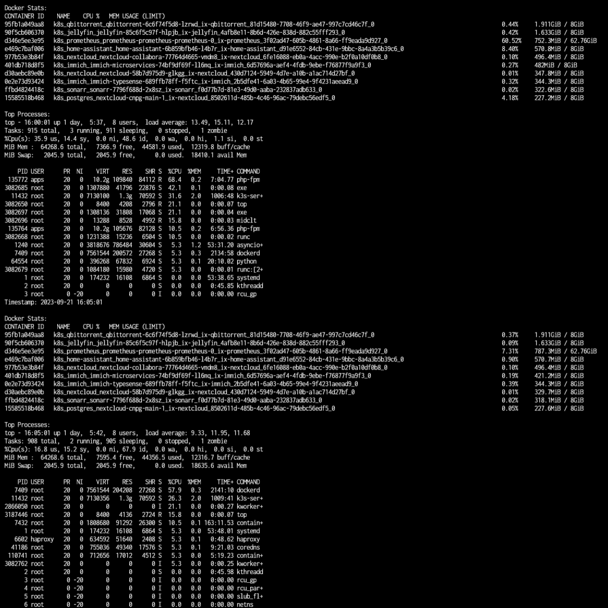

I just had this happen again while I was uploading a large number of assets to immich.
however my script output is less helpful.
