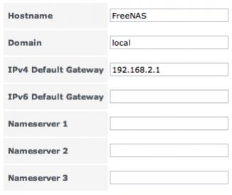

these are my global setting below if it helps. gateway is my router IP.
sorry first attachment was wrong. this one is the one that is able to ping google.com outside of jail but not from within.

trust me the ping issue isn't has nothing to do with this plugin. You gotta settup a nameserver for you main install before you setup your jail. If you already missed this step I think you should add a correct nameserver or two in /etc/resolv.conf in your jail

Ok so I have these within the /etc/resolv.conf
search local
nameserver 192.168.2.1
do I need to ad the IPv4 default gateway?
if so is it
ipv4 default gateway 192.168.2.1
thanks getting close now. hahaha

My nameservers (set to Google's) and gateway are already set. I removed the jail, added the information, and set up the jail again. Same results.
(I checked /etc/resolv.conf, they're in there.)
