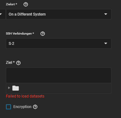

at the moment i try to build a backup replication between my Truenas Scale Server and my old Qnap 4bay T431.
So i create backup credentials with a SSH Keypair, generate the Keypair on the Truenas and downloaded it. This are txt files. On my Qnap NAS i can import TLS Certificates, but the certificate is not supported. i tried txt and pem. So i login in the shell of qnap and add the file authorized_keys in /etc/config/ssh folder and to be save in the .ssh folder of the admin user i use to login and want to use for replication, add the Public Key and restart the system. It dont work.
I already tried the other way with a shell created keypair on the qnap nas, but it wont work.
Every time i get an authentication failure.
I only can connect via password over shell on truenas to the qnap nas.
Did anyone solve similar like this?
Thanks

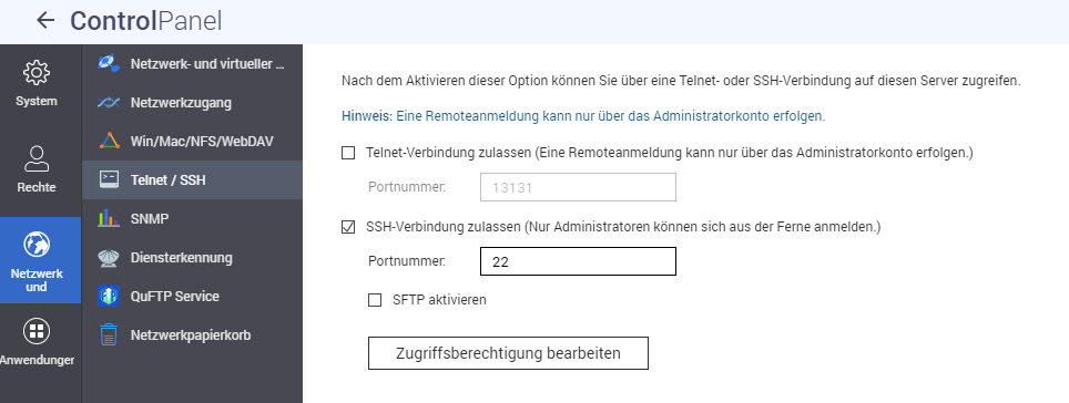

Is key-based authorization enabled in the ssh daemon on the Qnap NAS?
Thats a good question. Where i can see it? I never see it in the tutorials.
Here are my SSH Settings:
i tried to login via ssh now, but i only get a connection refused. i try to solve this at the moment. after i want to show in sshd_config
SnoppyFloppy
Jun 17, 2021
77
I don't use Qnap so I'm not familiar with the UI but if I'm correct that it's running on linux, have a look in /etc/ssh/sshd_config and look for PubkeyAuthentication. It should default to Yes
SnoppyFloppy
Jun 17, 2021
77
corin.corvus
Oct 21, 2022
23
Ok after Reset my NAS i can go in SSH again.
sshd_config i see this:
#PubkeyAuthentication yes
i need to change that. Thanks for the hint.

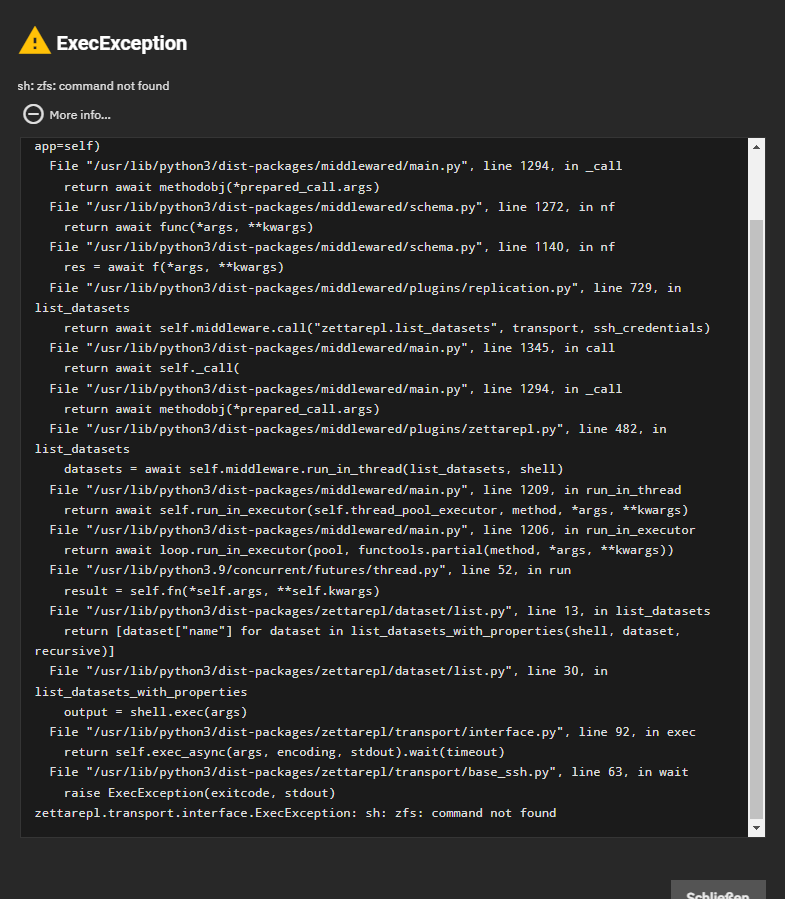

And the next Error... "zfs: command not found".
The Qnap Nas cant ZFS.
How i can backup my Data? :confused:
9,702
Not with a replication task...
What you can use (since both systems have it) is rsync...

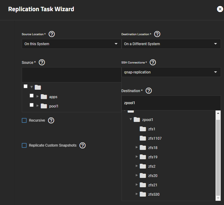

Hi sorry for necroing this post, but I am trying to achieve the same, I got the ssh connection up, truenas can list the directories from qnap, but I've no idea which of the generic names there is my newly created shared folder for the replication so I've no idea what to choose here, anyone can help? Thanks!
all of the zfs# folders only have subdirectory RecentlySnapshot in them
I already have rsync set up, but I wanted to compare the speed since I updated the qnap to the QuTS hero system with zfs.
