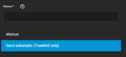

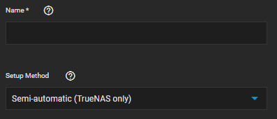

OK - got it. It's not a bug, but... this is what the UI to create SSH connection looks like:
When the setup method drop down is clicked:
On a 4K screen, the option Manual just looks like it's the title of the value being edited. I simply did not see that option mentally. When selected, the UI changes so that it expects just IP address, port, and SSH key which was already imported prior. It works as expected.

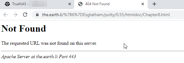

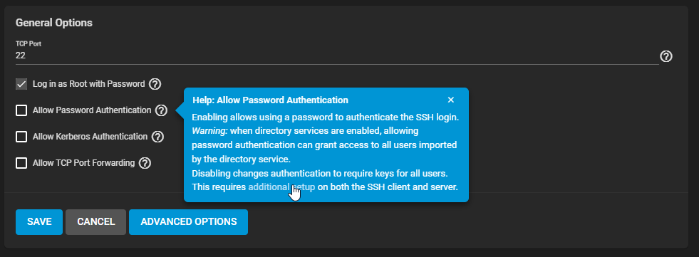

Additionally, even though an SSH keypair is created on the TrueNAS Core system, it's public key needs to be assigned to the user that is used for the replication process. When setting up SSH in Services, there is a link in tooltip that was probably meant to tell this to the user:
When this link is clicked, this is where it leads:
