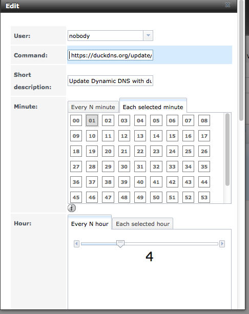

Dynamic DNS
To SSH remotely over the internet, you need either a permanent IP address or a domain name that is updated to point to the IP address when it changes. The latter requires a dynamic domain name service. A good free one is DuckDNS (duckdns.org). First, use one of the sign-in options such as Google. In the domain line enter your preferred subdomain name. If it is available, that’s it; you will see a token (long sequence of random characters). Copy it.
Then you need to tell FreeNAS how to update the dynamic DNS server at DuckDNS. FreeNAS has a Dynamic DNS service that can take care of this if your service is listed (DuckDNS isn’t), but doing it yourself is easy. As outlined nicely by RoboKaren:
  1. Login to your Freenas server GUI
  2. Go to Task > Cron Jobs > Add Cron Job
  3. Set up the new cron job:
    1. Set it to run as 'nobody'
    2. You can have it at 1 minute past the hour, every 12 hours (or less), every day of the week.
    3. The command to run is:
      /usr/local/bin/curl https://www.duckdns.org/update/<subdomain>/<token>
      where <subdomain> is your subdomain in subdomain.duckdns.org
      and <token> is the long sequence of random characters from DuckDNS.
    4. Note, if you set this up before and then it broke, you must now specify their domain as www.duckdns.org, not duckdns.org.
And that's it. You may want to run:
from your user account first to make sure that the command actually works. If it does, it should return “OK”. If there is some sort of a problem, it'll return “KO”.

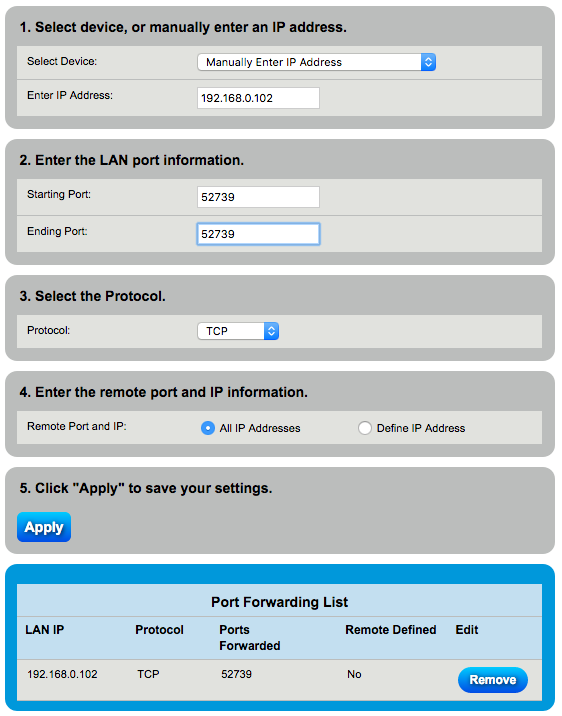

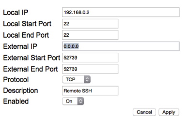

Port Forwarding
Now you need to forward the SSH port from your router to the server. Find instructions for your router. As an example, for a Motorola SurfBoard SBG6580, go to Advanced > Forwarding, click “Create IPv4”, and enter as in the left figure (using something different for the external port, and your server’s local IP). In this modem, you can forward the external port number to a different-numbered local port. The second figure shows settings for a Zyxel C3000Z (accessed via Advanced Setup > Security: Port Forwarding). In that modem, local and external ports must be the same (as the port set above in FreeNAS SSH settings).
If you choose to use the same port number externally and locally, you will need to put that port number in the FreeNAS GUI in the SSH Settings. Then, accessing your server via SSH remotely would be “ssh -p 52739 <you>@<subdomain>.duckdns.org”.

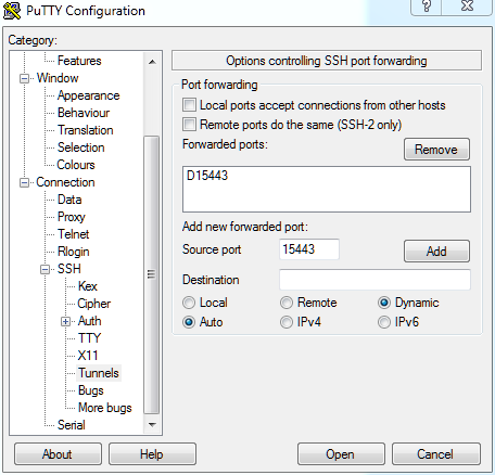

IF NOT, AND YOU ONLY HAVE PUTTY:
A lot of people are having trouble setting up the equivalent command in Putty. I won't go through the whole Putty setup (you have to point it to your key file), but here are the two key screens to get the same effect as the ssh command above:
