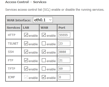

I think the bind interfaces is in the advance mode for the SSH Service setup? Well under bind interface I only have one, which is nfe0, which I've selected, though there was no difference. Also looking around on my router page, I found this:
And SSH was not enabled for WAN, so I checked the box, and changed the port from 22 to 8888, but for some reason it's still not working.

Yes, I am asking what brand and model of router you are using. Might as well post your FreeNAS system specs, too (per the forum rules) while we're it.
I suspect, for example, that the screenshot you posted above is for the various services (HTTP, TELNET, SSH, etc.) that run on your router. If so, these will have nothing to do with your FreeNAS system. I could be wrong about this -- but without knowing anything about your router, I'm stymied.

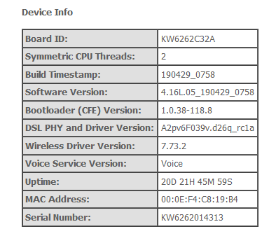

I believe it's a dual band router, and my version is FreeNAS 11.3-U4.1. I have a screenshot of my router details:

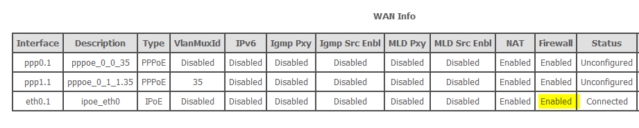

But looking at WAN info maybe Firewall is blocking it?

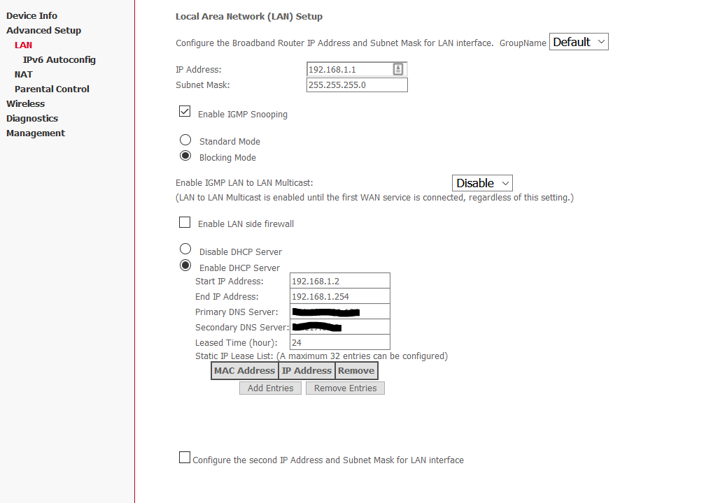

Though I don't see any options for firewall unless it's this LAN Side firewall which is off?
