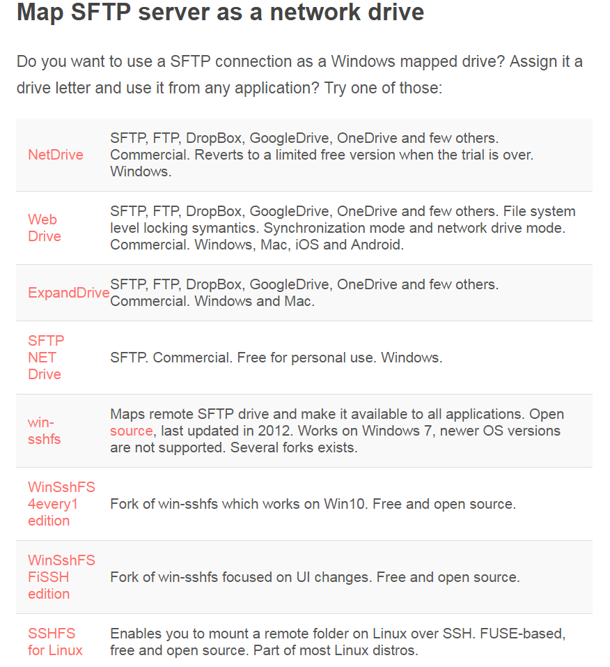

I found this that summarize all the apps and software that can be used to login as SFTP client to an SFTP server:
https://www.sftp.net/clients
If you scoll down, there are some software that lets you Map SFTP Server As a Network Drive:
NetDrive SFTP, FTP, DropBox, GoogleDrive, OneDrive and few others. Commercial. Reverts to a limited free version when the trial is over. Windows.
Web Drive SFTP, FTP, DropBox, GoogleDrive, OneDrive and few others. File system level locking symantics. Synchronization mode and network drive mode. Commercial. Windows, Mac, iOS and Android.
ExpandDrive SFTP, FTP, DropBox, GoogleDrive, OneDrive and few others. Commercial. Windows and Mac.
SFTP NET Drive SFTP. Commercial. Free for personal use. Windows.
win-sshfs Maps remote SFTP drive and make it available to all applications. Open source, last updated in 2012. Works on Windows 7, newer OS versions are not supported. Several forks exists.
WinSshFS 4every1 edition Fork of win-sshfs which works on Win10. Free and open source.
WinSshFS FiSSH edition Fork of win-sshfs focused on UI changes. Free and open source.
SSHFS for Linux Enables you to mount a remote folder on Linux over SSH. FUSE-based, free and open source. Part of most Linux distros.
SSHFS for OS X SSH File System for MAC OS X based on FUSE for OS X. Free and open source.
Will try it tonight!

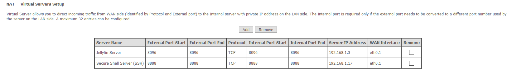

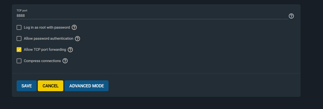

Thank you Glorious for the guide. Though I am a newbie, so I am still stuck on accessing SSH over internet. I am able to ssh into the server locally, and I believe the DuckDNS is fine, since when I ping <subdomain>.duckdns.org, it shows [ip address] beside it. Maybe the problem is my port forwarding? This is a picture of the port for my server.
I think this is the port forwarding for my router:
Now when I try, ssh -p 8888 user@<subdomain>.duckdns.org, it gives me the error ssh: unable to connect to host <subdomain>.duckdns.org port 8888: Connection Refused.
And I'm confused when I neglect the -p 8888, i get the error: Connection closed by <ip address> port 22. I thought that I didn't use port 22, and changed it to 8888? Any help is appreciated!

Sorry I'm not sure how to edit my reply, because there doesn't seem to be a button for it on my screen, but I would like to add that I was trying some other stuff like making the external port different than the internal port, by keeping the internal port as 22, while making external port a larger number, but it still doesn't work. I used an online port checker, and it does say my port is open, so I'm not sure what is the reason for this error. I'm using Windows 10 and hyperterminal to try and ssh remotely, just in case this is useful.
You've configured the SSH service on your FreeNAS server to answer on port 8888; your router accepts inbound traffic on port 8888 and forwards it to port 8888 on IP address 192.168.1.17 -- this all looks good, provided 192.168.1.17 is the IP address of your FreeNAS server.
Is your FreeNAS server configured on IP address 192.168.1.17?
