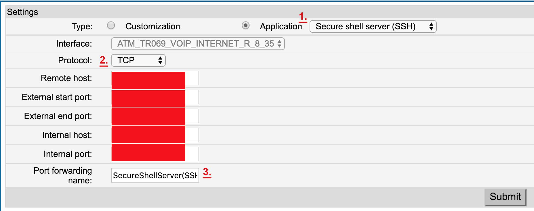

Maybe 'script' is too fancy a word. It was really a command described as a script: ssh-copy-id [-i [identity_file]] [user@]machine
So next problem. I would start with the obvious stuff. On the router, you should set up a port forward with external IP 0.0.0.0, external port xxxx, the server's local IP, and internal port yyyy (which could be the same as xxxx). Make sure it is enabled if you have such a setting. On the server, the SSH service should be set to port yyyy.
Had done this and rechecked everything, but it didn't work. Redid the port forwarding config by making the internal and external ports the same. Then noticed your 'xxxx' and 'yyyy' port suggestions were four digits, so just in case changed this also (shouldn't make a difference tho, should it?). Still no success. This is my port forward config page on the router (with important info screened out of course):
The 'remote host' is my external/public static ip. External start and end ports the same. 'Internal host' FreeNAS' static internal to the LAN ip. 'Internal port' is now the same as the external ports.
Some questions:
1. I'm pretty sure the application is correct.
2. Is TCP protocol right - other options UDP, TCP/UDP?
3. The 'port forwarding name'? Should this be FreeNAS?

You might want to read your router documentation. That "Remote host" field may be equivalent to what's called "External IP" on my router. It's not what you would think. It is the IP address of the remote computer that is calling to get in. If it may vary, you put 0.0.0.0, as I suggested. It's probably not asking for your external/public-facing static IP.
When I suggested going to another network, I meant like go to a coffee shop or library with wifi and try to log in from there.
Unfortunately getting "The remote host IP address is invalid" error messages for 0.0.0.0 I'll do some reading regarding the router.
Yep, I'll give that a go.
Then I would guess leaving it blank would be the way to go?
Yes. Not quite there yet, but that got me further along the road (so to speak). Now I'm getting the following "Unable to negotiate with [my public facing ip] 93.xxx.xxx.xxx port xx: no matching key exchange method found. Their offer: diffie-hellman-group1-sha1." Re-entering the command with '-vvv' produces a long output, which I'm going to paste further down, but before I do that, let me just fill you in on what I did initially after the first basic error message. I put it into a Google search and results (found here https://www.openssh.com/legacy.html) seem to suggest that my OpenSSH package needs to be updated, that I could bypass the restriction but that that wouldn't be completely secure, exposing me to the so-called "Logjam attack". I began researching how to update my OpenSSH, but to be honest, whether this means my MacBook or the Freenas server isn't clear (to me). I'm assuming it's my Mac because that's what's doing the ssh negotiation. I then discovered that this wasn't easy and had to install Homebrew to achieve it. (NOTE: I can't remember why this was necessary but that's what I started to do.) After much effort and cussin' and swearin', I finally managed to install Homebrew - there were problems with the installation in relation to PATH which I eventually managed to resolve - but I'm now stuck at another stage. And this has cause me to pause. I need to make sure that this update is absolutely necessary by checking if anyone reading this has come across this problem? Do I need to be uneasy about the Logjam attack? Should I be really worried, given the spate of ransomware attacks so recently in the news?
