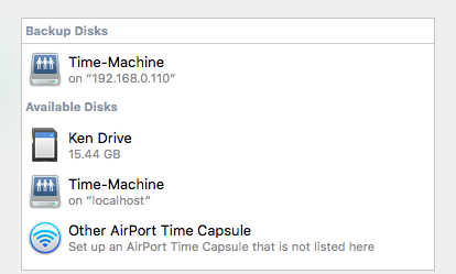

Basically I'm connecting to my Time Machine using the AFP protocol.
As for the ssh command, from my experimentation, localhost or IP address does not matter. I tried to use IP address to see if my Mac would be able to detect the Time-Machine based on IP.
If you see the screenshots below, it shows how the Mac sees the same Time-Machine differently when connected via local network (192.168.X.X) vs remotely (localhost).
I'm hoping to be able to remotely back-up to Time-Machine. Yes, your concerns are valid on sparsebundle hiccups, but I guess its worth trying to be able to back-up over the internet. That would be convenient especially when I'm away from home for long periods of time.
When connecting on local network:
When connecting remotely:

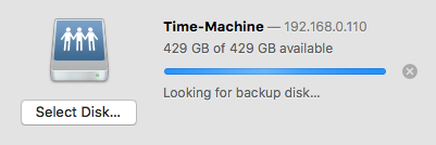

Glorious1, somehow I wasn't able to see your latest post on this thread.
Just to add,When accessing remotely, I'm able to see the same Time-Machine as available. However, it is shown as available on localhost instead of '192.168.0.110' which the Mac is not able to see them as the same.
I tried again running the following commands you provided, but the results were still the same:
ssh -fgN -L 15548:localhost:548 -C -p 13579 username@XXX.hopto.org sleep 120

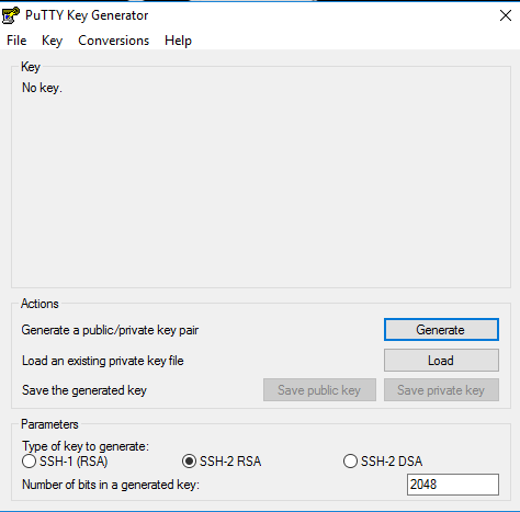

However my client is running on Windows so I m a bit confused on how doing the first part on a Windows computer.
Any help would be great.

By 'the first part', are you referring to generating keys? Download PUTTY if you don't have it already. It comes with a program called PUTTYgen.

Yusuf Limalia
Apr 5, 2016
234
Yup this would be the way to do it.
There's a few applications out there to get these done. PuTTYGen is the lightest. bitvise is another alternative.
Link to PuTTY: http://www.chiark.greenend.org.uk/~sgtatham/putty/latest.html?
Link to bitvise: https://www.bitvise.com/ssh-client-download

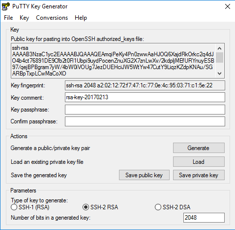

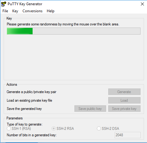

After you download PuTTYGen
1) Hit Generate
2) Move your mouse cursor over the blank container as instructed
3) It will generate a key for you

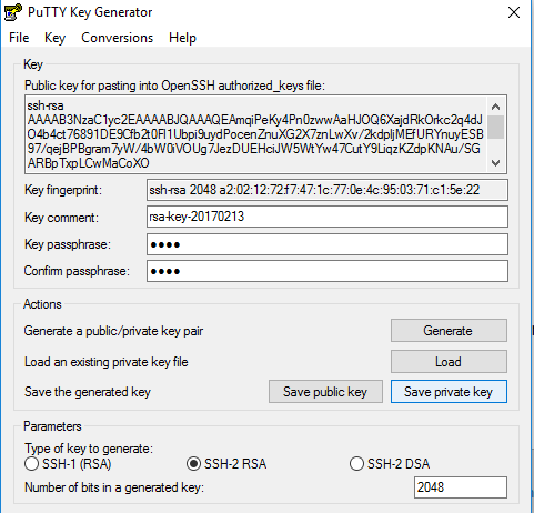

4) You need to append to your authorized_keys file as OP instructs, and save your private key. Make sure you include a Key Passphrase before you Save your private key.
It will prompt you in you don't put a Passphrase.

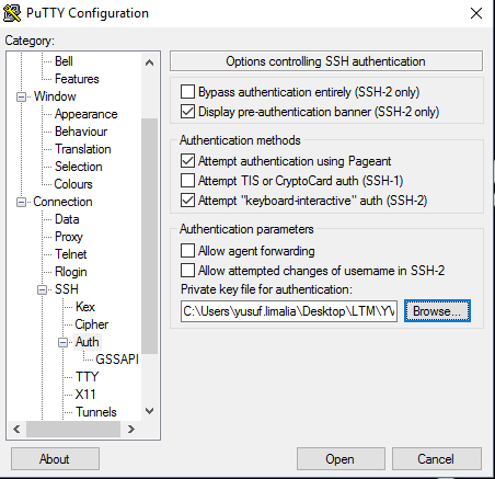

5) Once you have pasted your public key into your auth keys file, you need to tell PuTTY which private key you auth against:
Under PuTTY > Connection > SSH > Auth.
Just browse for your private key, go back to the Session Category and SAVE your session.
When you click open on your Session PuTTY will try and match the public key to your saved private key, then prompt you for the passphrase you set in step 4.
There's many more comprehensive tuts on the web but this is the quick and dirty version.
Don't forget to disable your password auth in FreeNAS.
P.S. I had some difficulty getting the private key to work sometimes on FreeNAS, this being due to some carriage returns being put in after pasting. I then had to manually remove them being careful not to remove any characters. Might work for you if your copy paste abilities are as crude as mine.

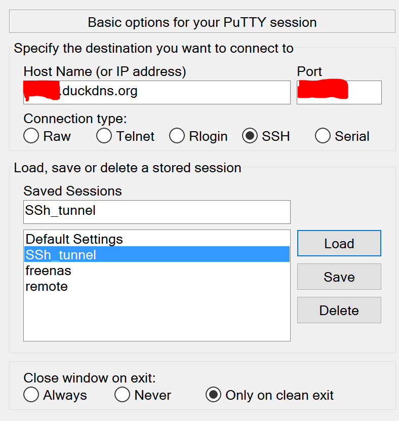

Thank you very much for your tuto. It helped me very much. Though I have some difficulties for SSH tunneling.
My client is running on Windows 10. I can access the server via SSh and key authentification without any troubles. I think my DuckDNS is set up correctly but I don't know how to be sure of that. Just the command returns OK.
Port forwarding should be OK too cause I can access my server with putty using an elevated port number.
And concerning SSH tunnelling, the putty part is working quite well I can access the server. But when I set up the proxy on chrome or IE, it's not working. I can't reach internet or freenas webGUI with local URL.
Do you have any ideas or do you need some more infos ?
Thanks a lot,
Thanks a lot,
  • You can check your DuckDns by pinging and checking the IP code on that.
  • Concerning the SSH tunnel for your browser. Check the tunnel settings, make sure it's set to dynamic. I've never used Chrome or IE for this, but Firefox works great for me. Also when there's a box that says: "No proxy for ..." make sure to delete localhost from that list or it will just skip your proxy for that.
Glorious1

My client is running on Windows 10. I can access the server via SSh and key authentification without any troubles. I think my DuckDNS is set up correctly but I don't know how to be sure of that. Just the command returns OK. Port forwarding should be OK too cause I can access my server with putty using an elevated port number.
If you are able to SSH in remotely (not on your local network, but via the internet), and you are doing it through duckdns, then there is no problem with your setup of duckdns and port forwarding etc.
Thanks a lot,
You haven't given enough information on this part to help you. All I can tell you is, with the directions in the original post, I am able to use Firefox on my Windows computer at work to browse my local network. I suggest you post an image of your PuTTY tunnels dialog and your settings in Firefox.
I'm not sure about what @Ascotg just said, deleting localhost from "No proxy for . . .". in Firefox. I did not delete it (according to the screenshot in the original post, but I'm not at work so can't double-check it), and it works for me.

Thanks, but it is still not working with Firefox (even when I remove localhost from "No proxy".
Actually there might be an error with duckdns cause it is not responding when I ping it. I attach posts of my putty and firefox settings to see if there is any mistakes. Thanks,
PS : it's in french but I think you wouldn t have any difficulties to translate :)
