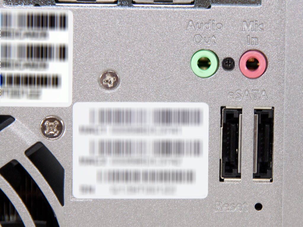

The truth is, it was simply my "mechanical" fault (i think).
After years of use i completely disassembled and cleaned it. I also renewed the thermal paste.
I slipped with the fine slotted nylon tool once over the backside of the logic board while unmounting the small and flimsy CPU heatsink.
This slight issue probably also knocked off a resistor or similar i can't find anymore.
This is just a guess because i investigated the whole logic board and think there was something SMD soldered.
Anyway if or if not, this was obviously enough to kill the logic board.
I found a point to brick it with a fine tool to get a beep and the POST (sometimes) showed, but nothing stable you can rely on.
This can't be soldered by myself, i tried different things but without any luck.
First time in life something like that happened to me.
