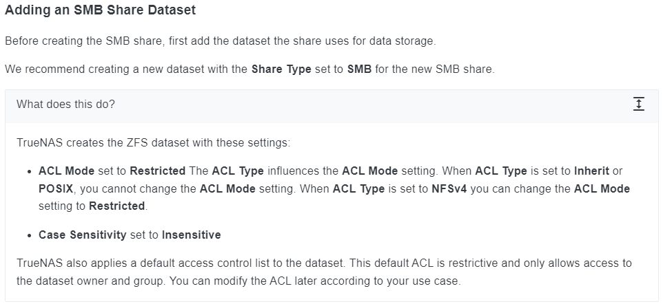

Maybe this used to be true, but for me at least when you set the "Share Type" parameter from Generic to SMB it changes the ACL type to NFSv4. What's more interesting is that if you then within the same dialog set it back to POSIX before hitting save, when you go to edit the dataset again you'll find that it ignored you and set the type to NFSv4 anyway.
Indeed, and the TrueNAS SCALE docs recommend setting "Share Type" to "SMB" (NFSv4 ACLs) for SMB shares:
There is more discussion in the docs' ACL primer; however, both the official TrueNAS/SMB tutorials and the naming of the relevant bits in the UI (e.g., the "ACL Type" dataset property being displayed as "SMB/NFSv4") suggest to me that NFSv4 ACLs should be preferred for SMB shares in the absence of a particular reason otherwise.
(Ancedata warning) NFSv4 ACLs work nicely with Plex media in my personal setup, because I can grant the builtin_users group read/write access to files in my media datasets while restricting the plex user to read-only access. (Similar things could be done with POSIX ACLs, but the inheritance behavior of NFSv4 ACLs makes them preferable for my use case.)
