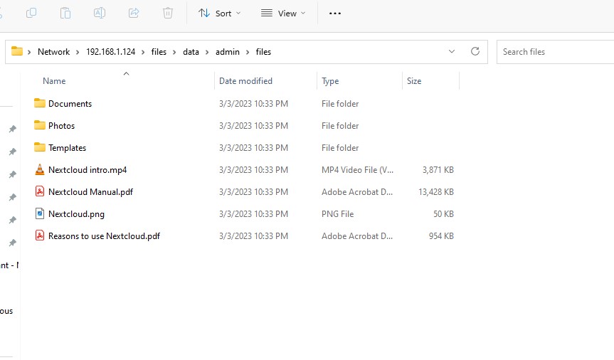

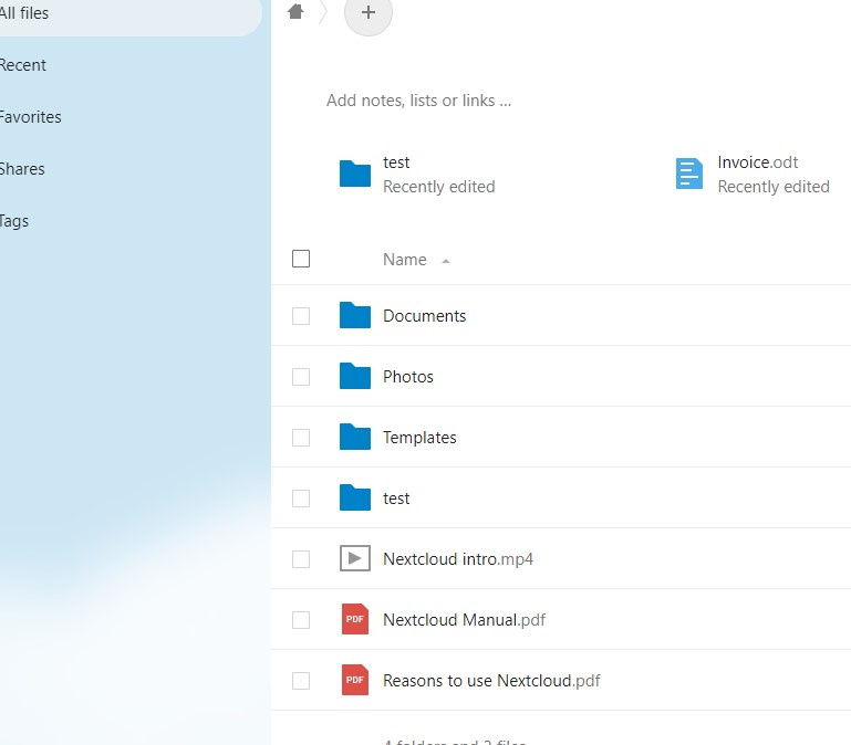

I really need some help on this. Here are more information of my issue:
Please see the attached screenshots. I already set the hostpath to /mnt/tankpool/files/ in the application and /files/ is where I store all my personal data, etc. However, the nextcloud web GUI keeps on defaulting to /data/admin/files; in other words, it's /mnt/tankpool/files/data/admin/files. I just want the web gui to default to /mnt/tankpool/files.

@LarsR @truecharts thanks guys for the inputs and yes, I will open a ticket via discord. I'm on a test environment so I can try different things. I also googled extensively about my issue and did come across an article that a truechart staff said not to use NEXTCLOUD_DATA_DIR; nevertheless, I did try this environmental attribute and it didn't work. I looked up many youtube videos and also couldn't get it to work.
It's ok that truechart nexcloud sets a path of /data/admin/files/ and the web GUI defaults to this path. However, I did try to mount a dataset in the truechart nexcloud setup, but that mount just doesn't come up within /data/admin/files/. I have no idea what to do but to open a ticket at this point.
